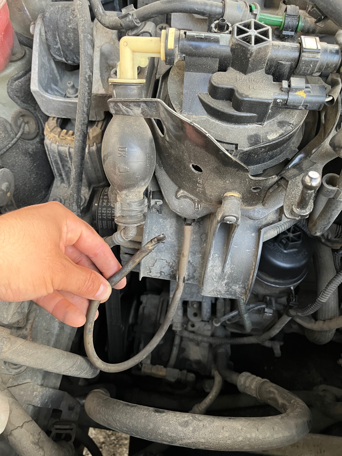

edwrdafk
- Posts: 9
- Joined: 15 Jan 2025, 10:29
Re: Help diagnosing this weird Peugeot 508 MK1 2.0 HDi whining sound
I was looking in the engine and found this broken hose in between the auxiliary belt of the AC compressor or what is that at the bottom. Anyone knows what it is and what it does and can it be connected to my problem?
- Posts: 12568
- x 1485
That's the water drain from the fuel filter. Just hangs down, but looks like it's been caught in something.
