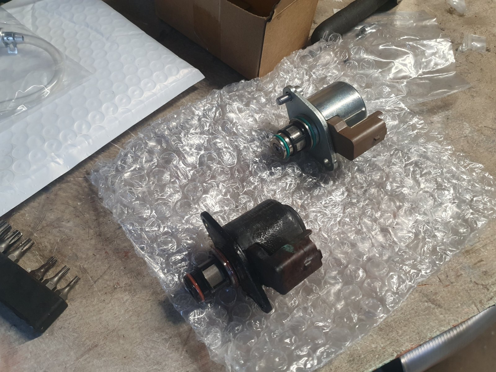

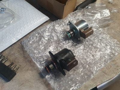

Not sure if it's of any help but I had read somewhere there could be a connection between rough running, no fault codes and problems with the fuel pressure regulator. I decided to change mine. It's fiddly to do but not too bad. The replacement was a no name Chinese number. Started up and it ran well but noisy idle. Drove better though.
Live data showed idle fuel pressure up at 900bar!
Decided to change it back to the original delphi regulator. After blowing through the old one with compressed air. Started up and ran very well. Fuel pressure read at around 300bar. In fact it seems 'cured' although who knows if it'll last. Not saying this is the cause but the improvement is very noticeable

Re: C5 2.0. Hdi rough tick over and stalling
Another day off driving and it is still running well. No longer showing the annoying delay in throttle response.
I've wasted £50 on the new part but it has shown the cause might have been that the regulator only needed cleaning.
