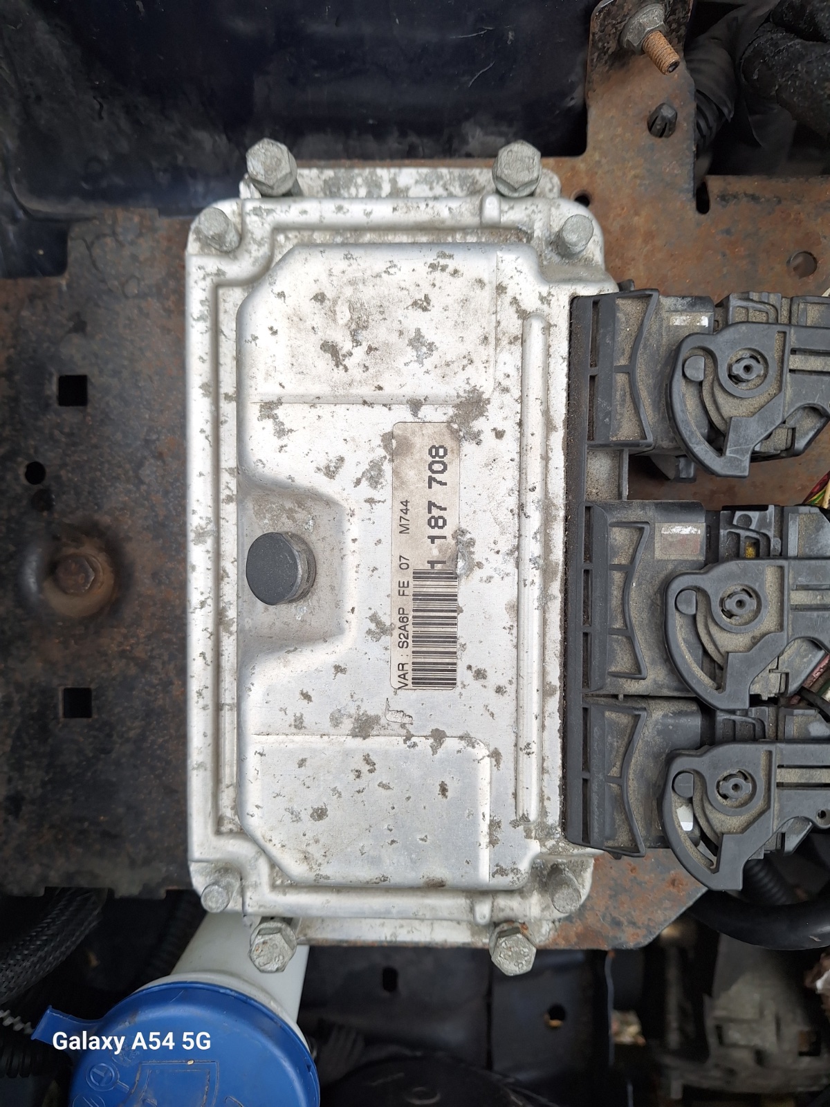

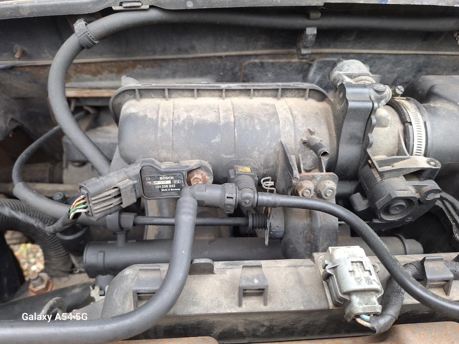

I have attached photos of the ecu and throttle body.
I think that from the numbers on the ecu label that it is a Bosch one. I didn't unscrew it from the tray.
Pete

That's the multipoint injection system and unfortunately what Both I and Alasdair said above does not apply. That said, I'd still very much suspect the throttle pot as a potential cause.
I'd also look for any air leaks between the air intake and the end of the inlet manifold, especially the various vacuum pipes such as those going to the brake servo and crankcase ventilation system. I have known those crack, allow air in south of the throttle butterfly and resulting in a dangerously weak mixture.
I have reached my limit here as I have zero experience of this injection system. Sorry.

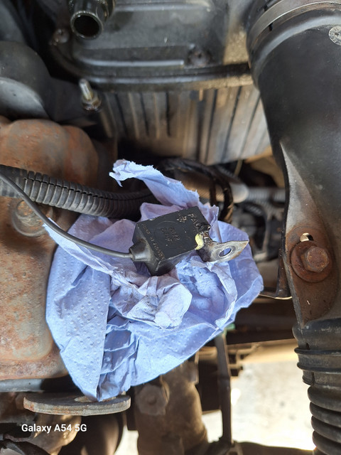

I had another look around the engine bay this afternoon and became quite excited when this came apart in my hand especially as it appeared to be part of the coil pack.
It had previously been repaired by having insulating tape wrapped around it. However I now know that it is just a radio interference suppressor. I tried to solder the earth terminal back on with no luck so glued it back together :-D It should last until a replacement arrives although I am not really using the car at the minute. And I can always turn the radio off.
Pete

Earlier models didn't have that suppressor. Just an earthed shielding around the coil pack low voltage wires. I have seen faults in that shielding cause induced problems with the "fly-by-wire" throttles. But not always!
That suppressor and the earthing crimp lug get mangled by gorillas who cant remove the locking nut from the coil pack retaining stud. You need a very thin 10mm spanner to get the two apart.

It occurred to me afterwards that since the suppressor casing was damaged exposing the capacitor inside that perhaps if moisture got inside the casing it could potentially be shorting the coil pack out. Or perhaps the capacitor itself had become damaged.
I decided to tie the remains of the suppressor out of the way and give it a go. No misfire (so far). I have now pressed the car back into service.
And there is no interference on the radio :-D
I have ordered a replacement capacitor so will probably fit it anyway as it should only be a quick job.
I should mention that I did unplug the coil pack to get better access to tie the suppressor up but the plug did seem to be seated correctly etc.
And I see what you mean about needing the thin spanner.

Are you saying that "fixing" the suppressor has stopped the misfires? Actually, did you disconnect it?
In that case it's more than a radio suppressor! I would be interested to see if the misfires come back if you connected the suppressor.
I have a 2003 C3 with the TU3JP (KFV) engine. It does not have the suppressor, just an earth wire. I am currently "doing up" a 2005 C3 (TU3 blah blah) and it does have the "suppressor". I am very interested to see how you go with this.
I will also look at the circuit diagrams to see if the suppressor is on the diagram for the 2005 model.
Posts: 55032
x 8365
Re: Peugeot 106 Intermittent Misfire and Hesitation
ozvtr wrote: 20 Aug 2025, 01:05 Are you saying that "fixing" the suppressor has stopped the misfires? Actually, did you disconnect it?
It's quite possible it's acting in a similar way to the condenser (an old term for a capacitor) in a traditional points (contact breaker) ignition system.
It will certainly cause problems if it's physically damaged, can thus absorb moisture and become electrically leaky as a result.
This capacitor is present on many 90s-2000s PSA vehicles, including the V6 ES9 engine... My Base Model AX has one fitted and that has no radio. It was missing on my blue AX and although the radio suffered no interference whilst it was missing, I did replace it.
It'll be there for good reason as the radio equipment fitted OE by PSA to those vehicles need no help to have any sources of local interference supressed.
