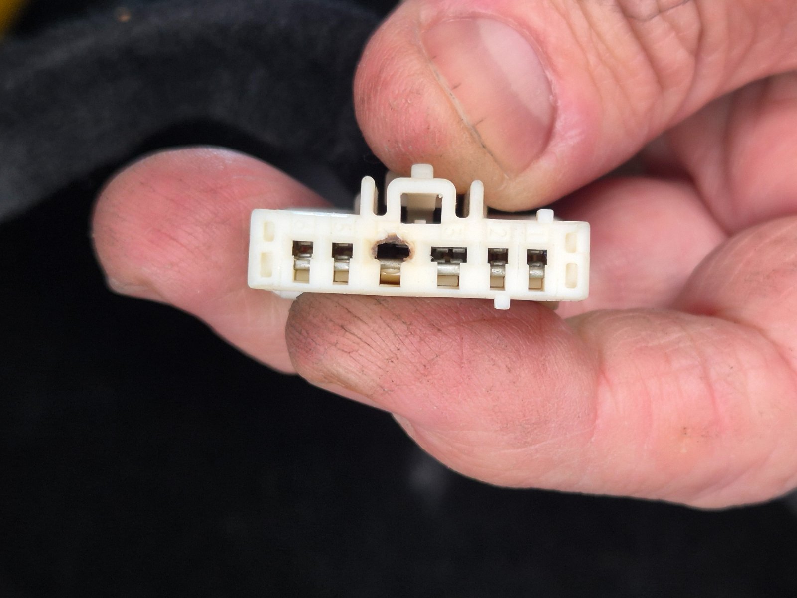

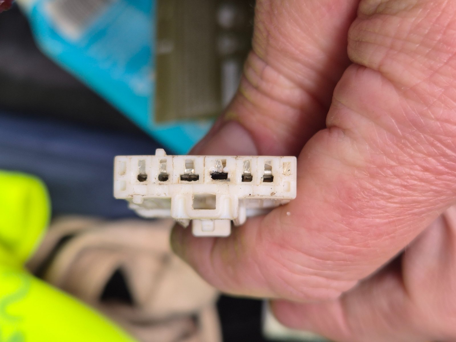

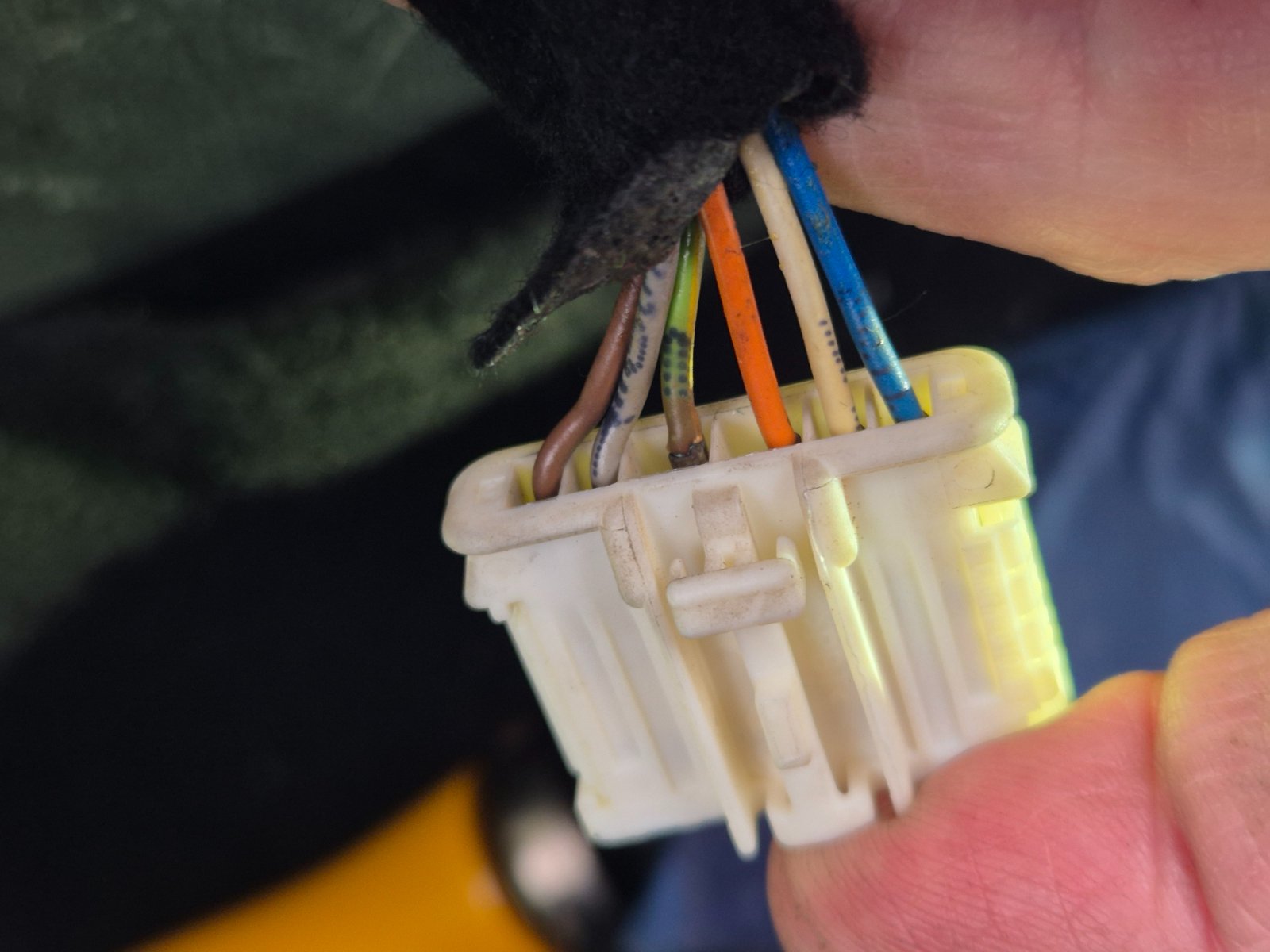

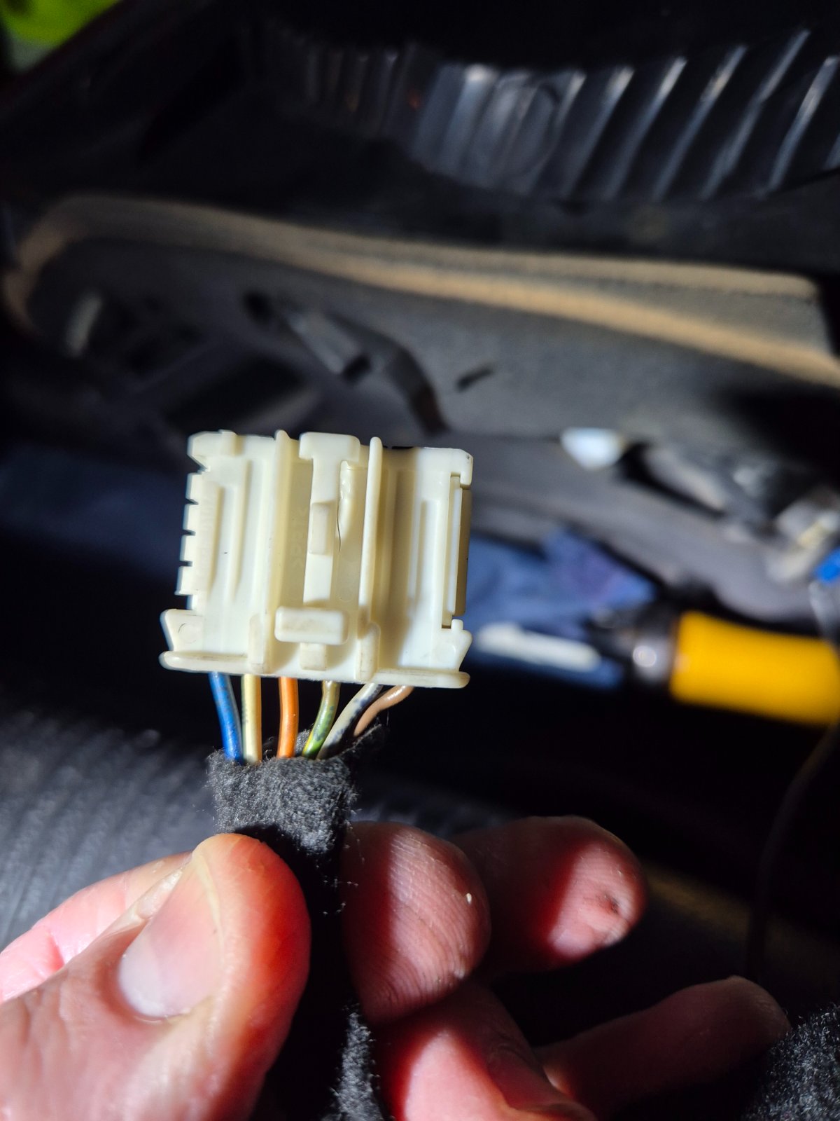

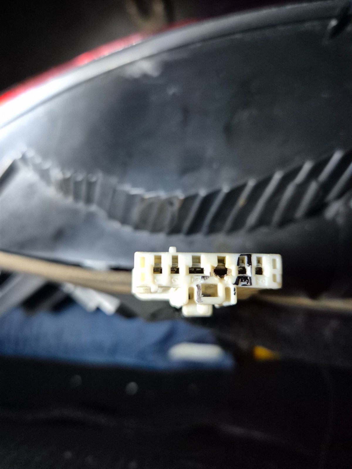

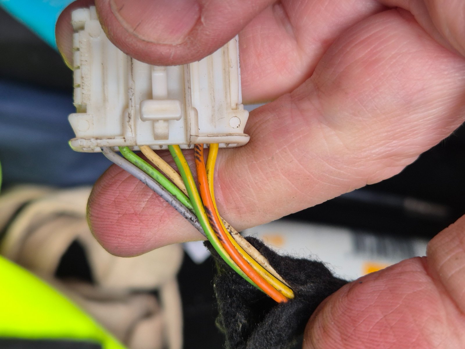

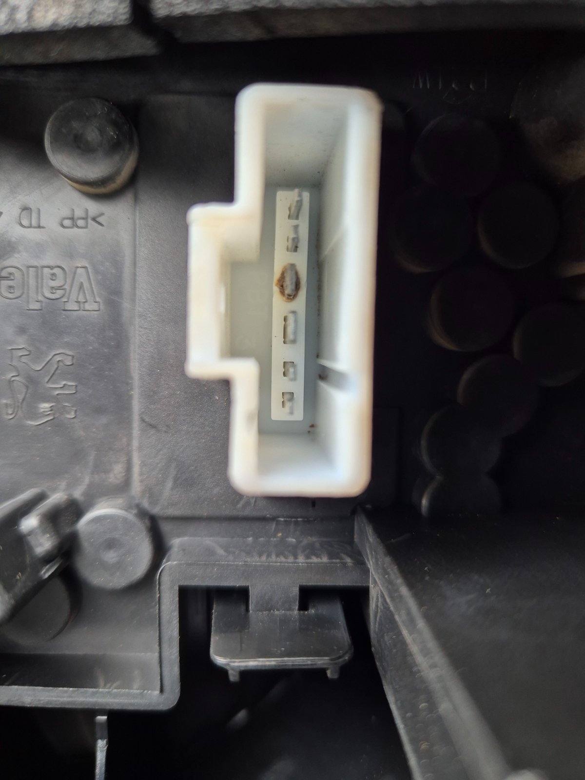

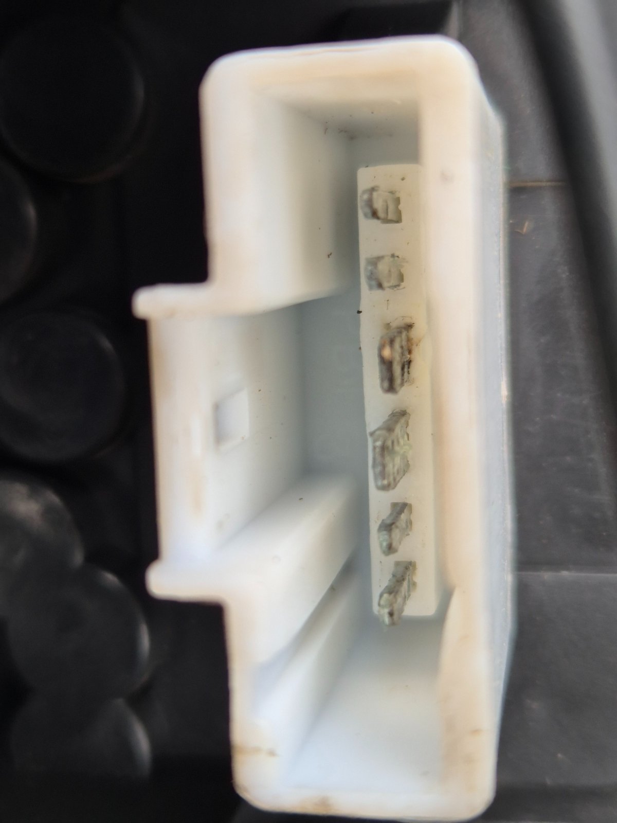

What I have noticed is that on on both sides the green & gold cable on the wiring connecting to the taillight box/housing have burn marks. Also an additional earthing wire has has been affixed to the car body and tail light box/housing. See attached pictures
Has someone encountered this issue and have a solution?

I check the voltage, seems there is no power getting through it measured 0.6v.
I marked the socket with a black marker that was not getting power. the grey cable 2nd from the right.
Grey cable 2nd from the right
socket 2nd from the right, marked black

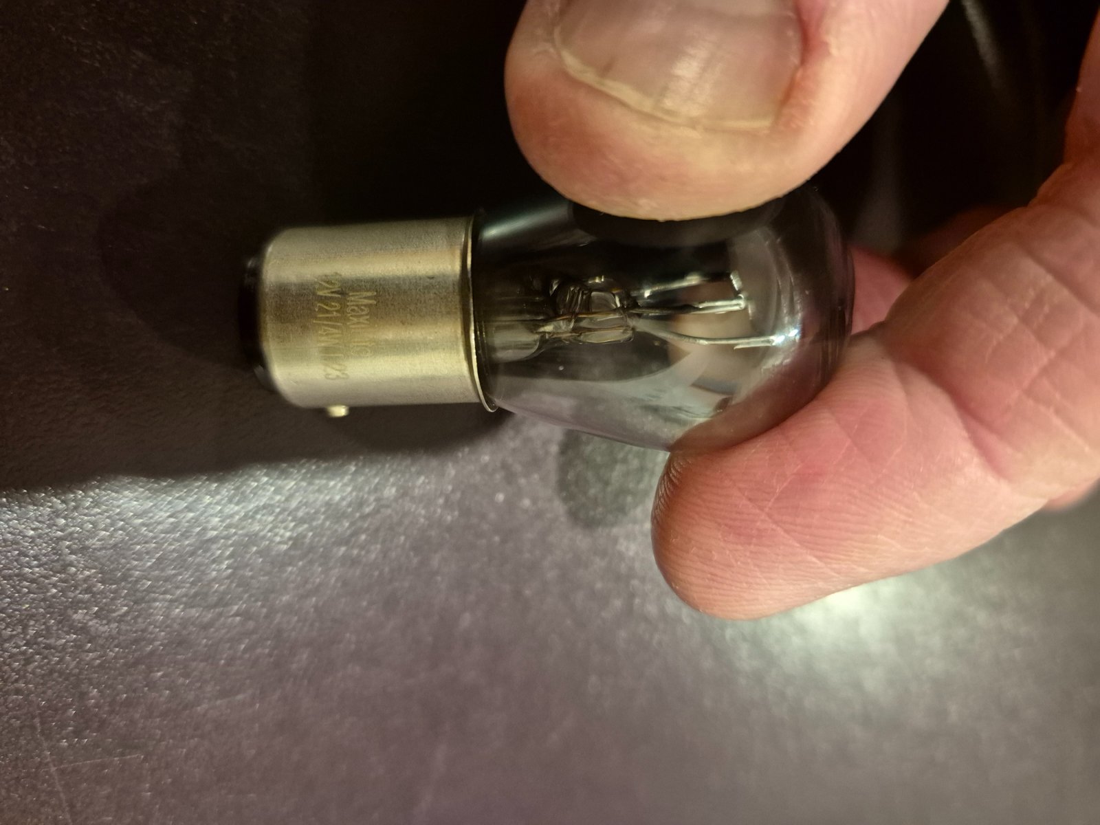

Problem fixed. Sometimes it is the simplest things that can cause the problem.
The cause: cheap made light bulbs.
Ended up replacing 10 bulbs each time clearing out error codes. Bit like the old Christmas lights.
