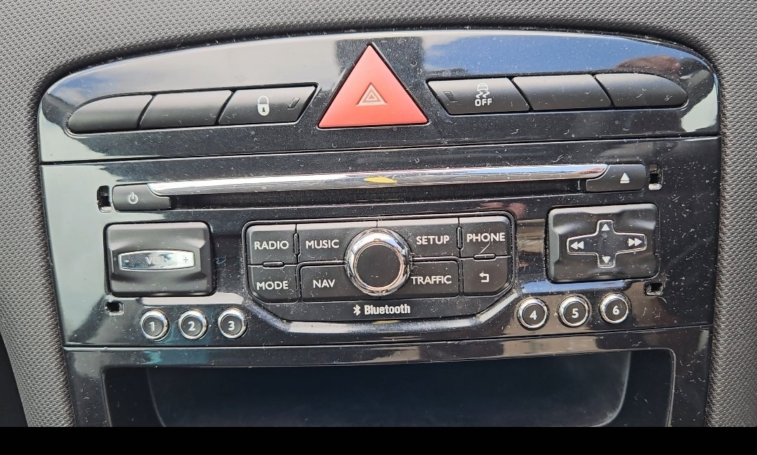

Hi all, I am looking for some help with my radio unit. It suddenly stopped working and all i hear from it is a noise from it as if it has a CD stuck in it. The navigation head unit screen opens and closes as normal but no display and the radio wont even turn on. Hope some one could help me with this

This must be a Mk1 308 as that looks like an RT6 unit to me. I could be wrong on this but I think there's also a fuse at the back of the RT6 which you have to pull out before you can even check it!

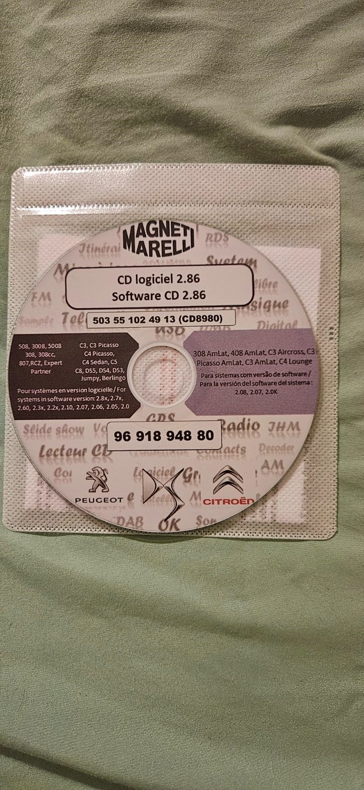

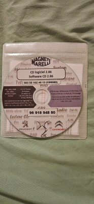

Hi i managed to get this problem sorted quite simply. All It needed was a firmware update using a original CD. I have attached a picture of the CD, hopefully this helps others.

Hi. Thanks - this is really helpful. Do you have a step-by-step instruction/ installation guide that you can share, please? Or do you just insert the CD in the player? Thank you
