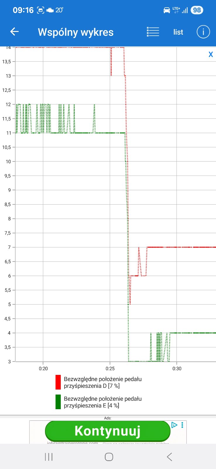

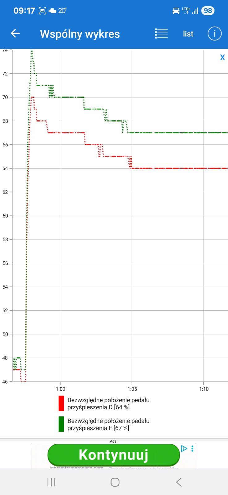

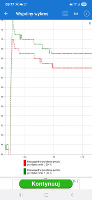

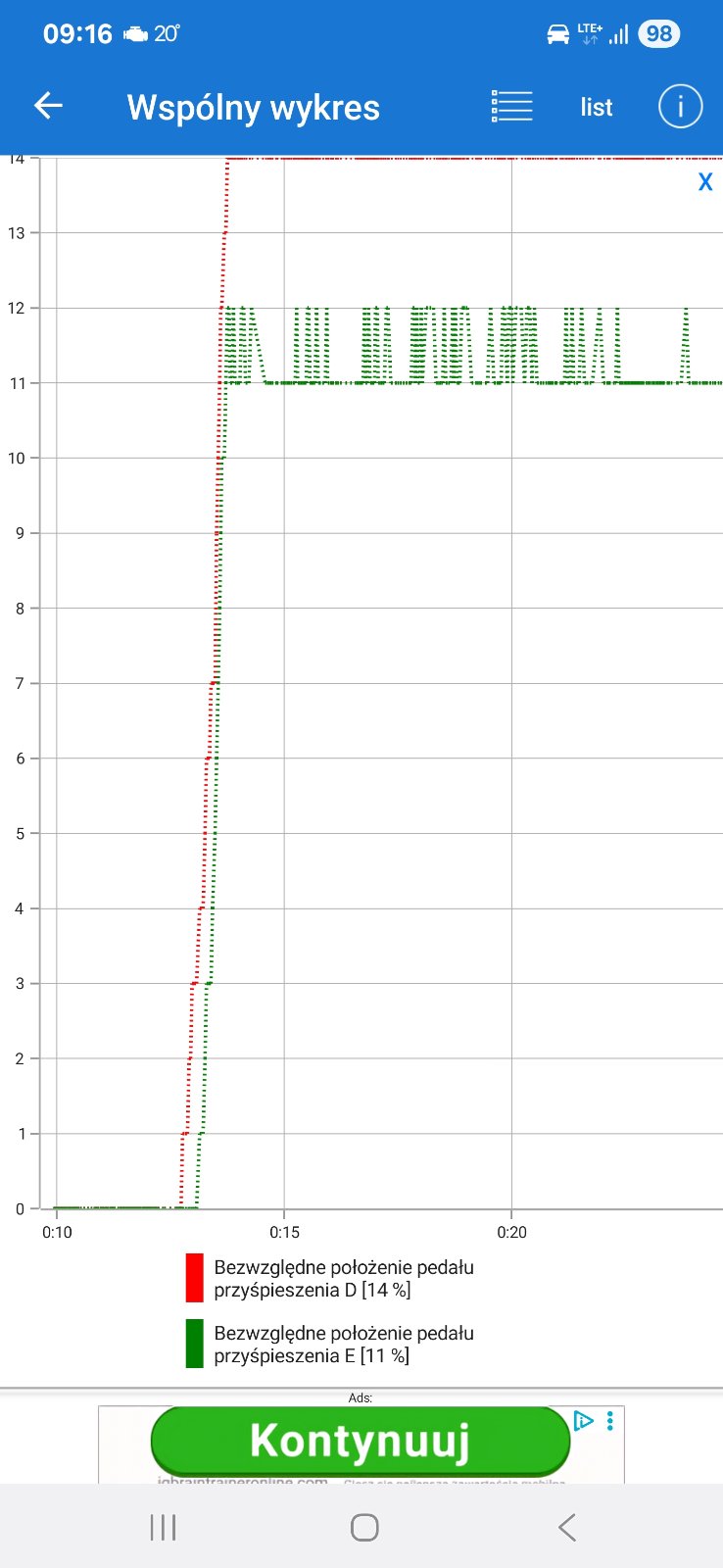

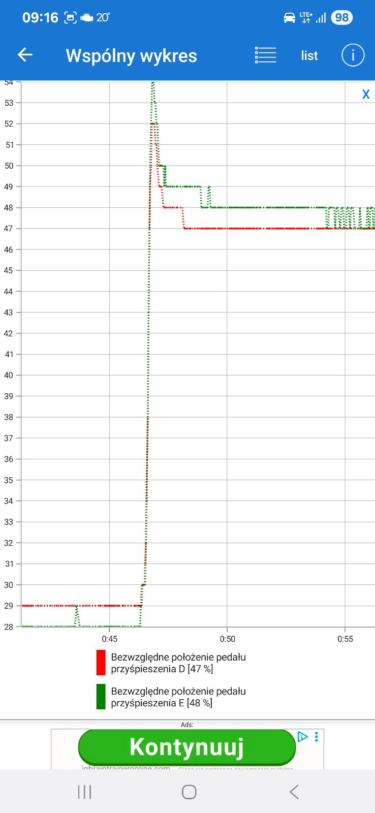

In Diagbox and Car Scanner (with ELM) the gas pedal has a discrepancy between signal A and B. the difference is 3% but not always.

The problem is that the car can drive well. It drives well after disconnecting the battery. Day / several days...
How to find the cause of errors? Are you sure it's the throttle pedal sensor?
