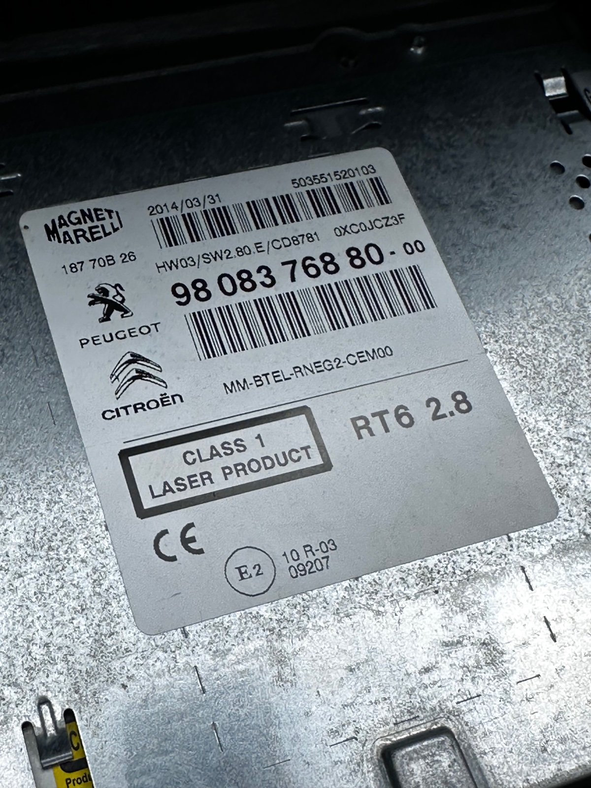

I would like to ask for your advice regarding an issue with the audio system in my 2012 Peugeot 508. The car is equipped with the RT6 head unit and a factory JBL sound system with amplifier.
Everything worked fine after I purchased the car, but about a month later, the sound suddenly disappeared from all sources — radio, Bluetooth, CD, and AUX. The parking sensors were the only thing still producing sound, and even then, audio playback from music sources would occasionally come back for a short while, about once a month.
Thinking the head unit was faulty, I replaced it with another RT6 unit with a newer firmware. However, with this new unit, there is no sound at all, not even from the parking sensors.
After researching online, I found that in vehicles with a JBL system, the amplifier may not be turning on because the head unit doesn’t send the +12V signal to the REM (remote) wire — possibly due to missing CAN configuration or differences in vehicle trim.
I haven’t tried connecting +12V manually to the REM wire yet, but before doing so, I wanted to ask:
Has anyone encountered a similar situation? And does manually powering the amplifier resolve the issue?
I’d greatly appreciate any advice or shared experience.
I’m happy to provide more information if needed.
