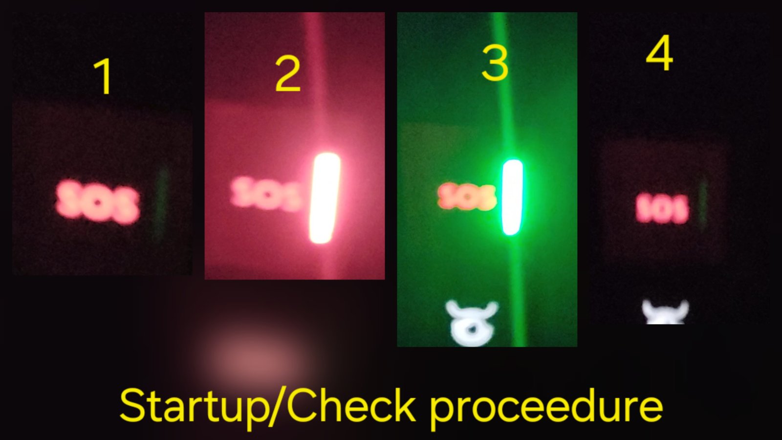

For those that want to know (@GarPat32)
Reading another forum, there seems to be a few instances of this failure, i wonder if it could be a dodgy software up date?
Stu
DS9
- Posts: 243
- Joined: 08 Sep 2023, 14:52
- x 34
Re: C5X offline
Tried mine earlier, got as far as 3. How long is it till 4 happens? 2 lasted just a few seconds.
DS9
- Posts: 243
- x 34
Re: C5X offline
Just looked 3 lasts 1-2 secs, then it goes back to 1 as per Stu's diagram. Very helpful.

Re: C5X offline
Mine just stays as 1
Dim lit "SOS" but and nothing in the led strip
Thanks all for looking
