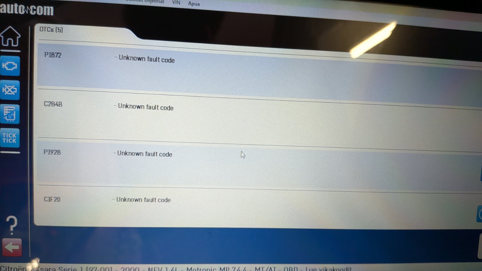

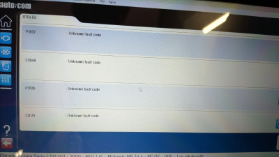

Edit: A friend did a scan with his tool, but it wasn't very helpful. A handheld cheap reader says there's 0 codes in memory.
