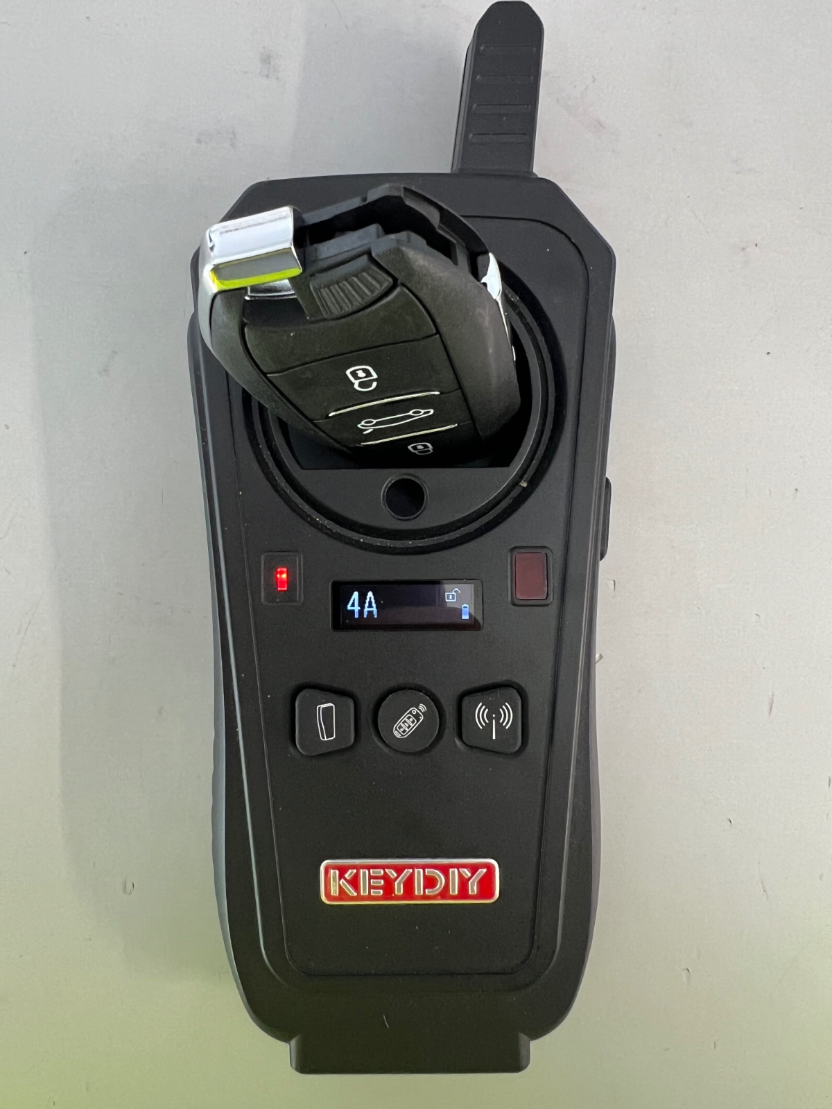

I bought a remote keyfob from eBay, with the, I believe from various sources, a' 4A' transponder. . . .(Peugeot 208 Allure 2023)

How do you know there is no 4A transponder in it? You really need a reader like this to tell.TC542 wrote: 11 Aug 2025, 22:25 Just opened up the eBay remote and compared it with my working original . . . No 'IM3A/ID4' transponder . . ??!!
The internals of aftermarket keys i find rarely look identical to the OEM boards.

I contacted the eBay seller . . He stated there is an integral transponder . .
So I opened it up again and found the 'IM3A/ID4D' transponder on the underside of the circuit board . .
He said to try programming . .It should be okay.
So just need to find someone to help me program it . . .
Regards, TC542

Does anyone have any experience of this unit . . ?
I have asked the supplier if it would be able to program my spare 'smart' remote keyfob.
(I know it could program a manual/key ignition type . . .)
Any help would be gratefully received.
