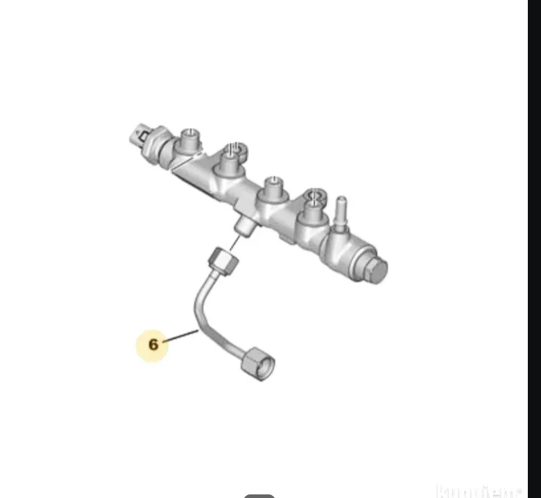

I’ve attached a photo showing the exact part involved.

Which bit on the pipe is leaking - is the pipe splitting or a seal at one end leaking ? Were the replacement parts from a Citroen dealer or something made up to fit ? Were the nuts done up to the correct torque value ? Has the fuel pressure been checked to make sure it is not too high ?

The leak is occurring exactly at the joint – where the pipe connects to the fitting – not along the body of the pipe itself. At first, the mechanic said the old pipe was just loose, but after tightening it, the leak continued. That’s why the pipe was replaced. Every time original parts were used, not aftermarket or improvised ones.I'm not sure if the joint was tightened using the correct torque spec, and as far as I know, the fuel pressure hasn’t been checked. Everything you’ve pointed out makes perfect sense, and I’ll definitely ask the mechanic to verify both the torque values and fuel pressure.
