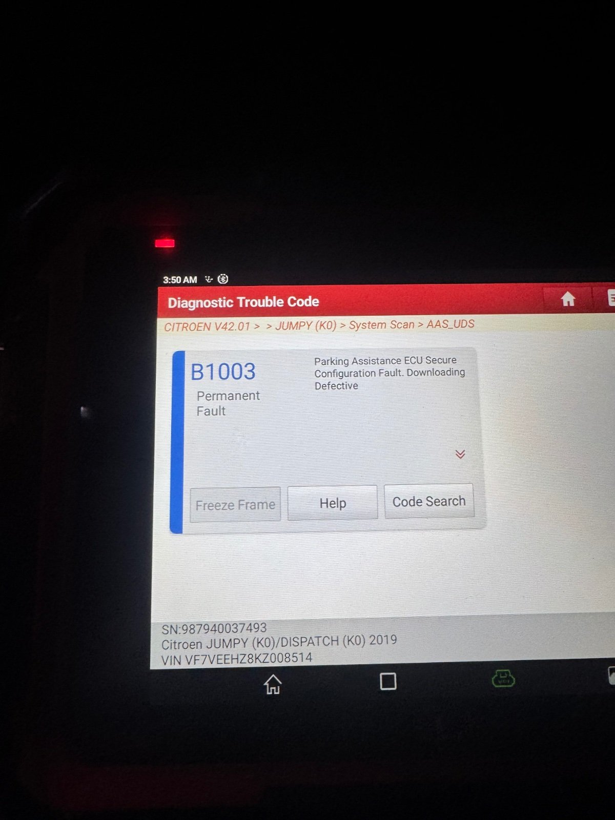

Hi everyone new member 👋
I have a 2019 Citroen Spacetourer van and had some small mishap :( I plugged into the van and started to play around with the bsi parking assistance Configurations. and configured the wrong type+ presence of parking assist. (unfortunately i was not wise enough to backup the settings) So now my van has no parking sensors or blind spot assist. But rear camera is still working. If anyone ablw to help with what configuration my van has? Fault code is B1003 Parking assistance ecu secure configuration fault. Downloading defective.
Save me before i have to go to main dealer 🙏
Thank you

Re: BSI CONFIGURATED WRONG
Unread post by Paul-R »
B1003 can be what is known as a phantom fault, i.e. not really there. Quite often the code reader will actually tell you this.
If it's the B1003 shown in the screenshot then it doesn't seem to be a phantom fault.
Unfortunately as you didn't make a record of the configuration before you changed things you may have to bite the bullet, go to a dealer and pay them to download the configuration. You may be lucky and find a good Citroen specialist who has access to the servers but it will still cost you I'm afraid.
