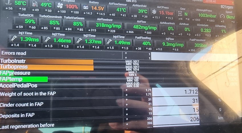

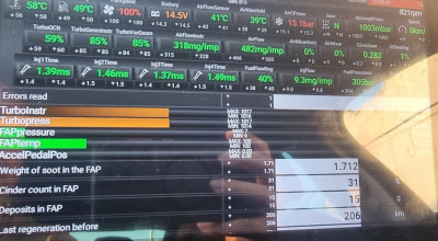

Did the procedure. After it something curious happened (will share photos later) On FAP , the air required at idle , that was previously on the 200 something , is now on the 400's , matching what is getting. I have an error saying that one of the BSI datastream parameters is invalid (U1218) , but i think i saw it before (but after some time disappears).

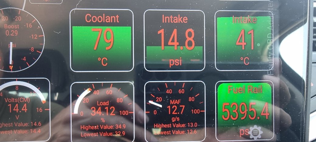

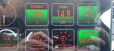

On torque it continues on the 12. something g/s

Ok. Weird stuff continues:
After the reset, this is what i got on FAP: So basically, it continues with the high readings, but now the engine agrees with the readings (what is requested is what it gets) Even turbo pressure is now in line with what is requested. I was happy.

In Torque , numbers still on the high side: Did around 100 km and some of the roughness sees to reappear.
Was better than before the procedure , but still not perfect.

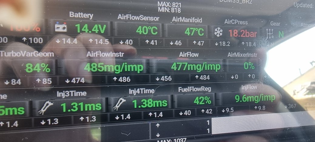

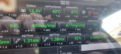

Now as i check FAP once again, this is what i get: What the heck can be provoking these high readings on idle?
