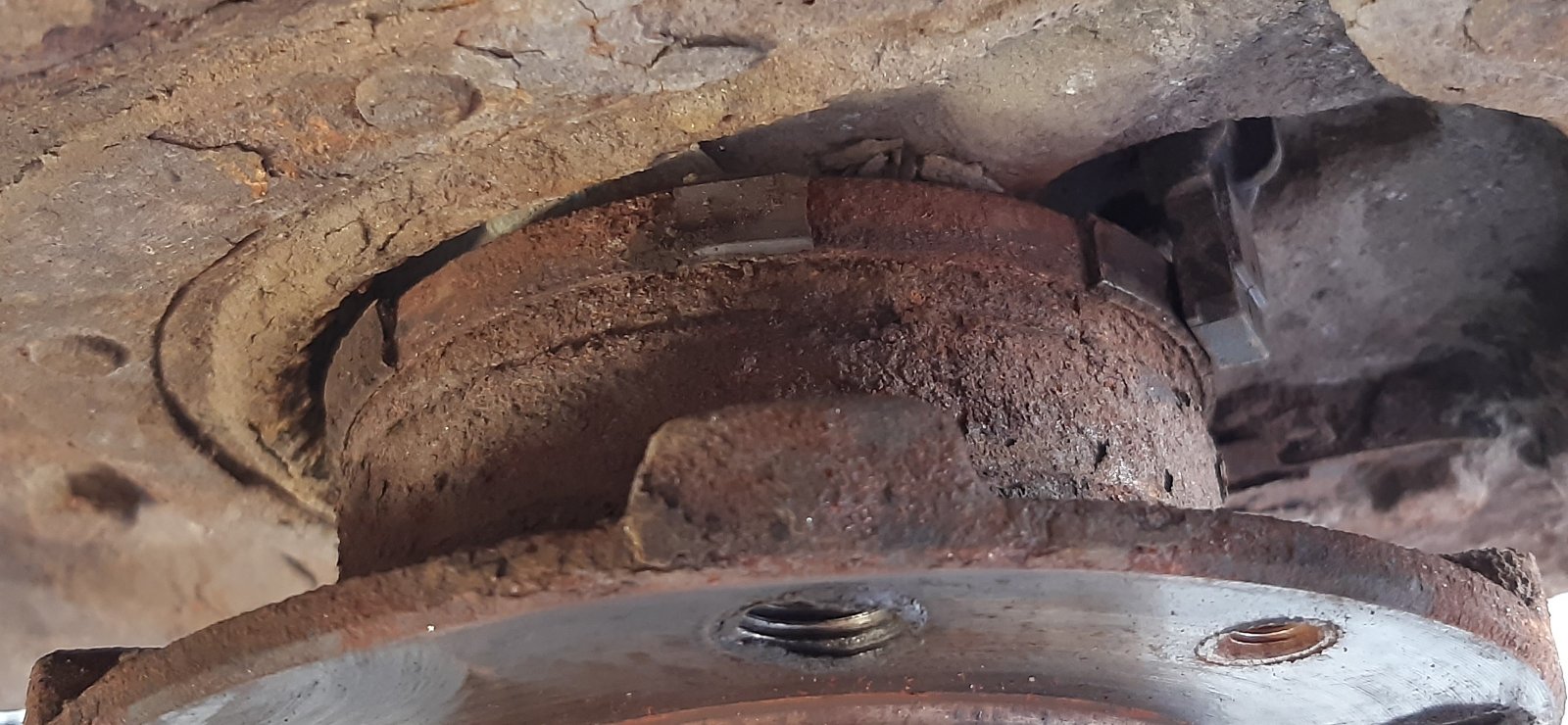

Then removed tyre and brake disk to visually check the parts.
The "possible" culprit in the picture.
Bonus item; wheel bearing was EOL, had a sound, and a couple of mm play, and was hot.

Re: 2008 C5, ABS/ESP/ASR system/ Parking brake faulty (Wheel speed sensor error)
That looks awful, hopefully you'll get it sorted!! :)

I had this on the front wheel and ut was not the sensor but was the magnetic ring the sensor reads. Corrosion and it partly fell off. It is part of the wheel bearing and was fixed by a full front bearing replacement.

mickthemaverick wrote: 30 Jul 2025, 20:32 That looks awful, hopefully you'll get it sorted!! :)
Well, if you open the picture, and zoom in really really close, you might be able to see that there is two very very tiny hairline fractures on the magnetic ring. :geek:

aerodynamica wrote: 31 Jul 2025, 07:13 I had this on the front wheel and ut was not the sensor but was the magnetic ring the sensor reads. Corrosion and it partly fell off. It is part of the wheel bearing and was fixed by a full front bearing replacement.
Yup, same.
Funny though that the service guy has been working 35 years repairing citroens and said that this was the first time he saw this kind of (magnetic ring) failure.
One reason for that might be that he also said that C5 X7 rear bearings are known to fail, so rear hub will be replaced before it rusts out and magnetic ring fails.
