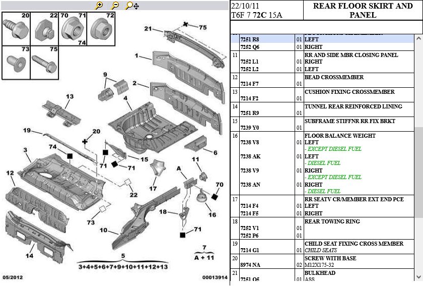

Does anyone know what the rear weights/dampers are called on the CC models my 307cc ones appear to have badly worn bushes which may be contributing to a mystery knock on the rear left (I'm taking it off to road test shortly).
The part has cast in large unmistakable digits: 9658678080 G * 9658678080 G * around in a circle
Google returns a complete blank for what appears to be a standard number format. Appreciate parts section is out of action but maybe someone has worked around these before and at least knows the name of them - or knows where to get bushes, looking at them, there is nothing to catch the weight if the bush ever fails, it's going to drop a 10kg(?) weight into the road.
Edit, ok. The top has a narrower hole so it wouldn't drop completely, but still..
Rear Counterweight part

I think that they are #16 here, "Floor Balance Weight". You would not want the floor to be unbalanced. Note that left and right are different!

Thank you Mick, the axle bushes have already been replaced though (and shocks and top mounts). The bush I referred to is inside the rear damping weight and likely isn't available separately.mickthemaverick wrote: 30 Jul 2025, 18:25 I think you may find the answer at:![]()

That looks very much like what I'm looking for, thank you (and double thanks for pointing out the parity!) .xantia_v6 wrote: 30 Jul 2025, 18:49 I think that they are #16 here, "Floor Balance Weight". You would not want the floor to be unbalanced. Note that left and right are different!
Unfortunately, the knock remains even with it off. Although I'm starting to wonder if there's something rattling in the massive boot side lining, it doesn't seem violent enough to be suspension parts (and I've changed it all except the springs). Someone on another forum suggested it's front parts making the rear noise and it travels! I'm open to the possibility but my hearing refuses to accept it.
