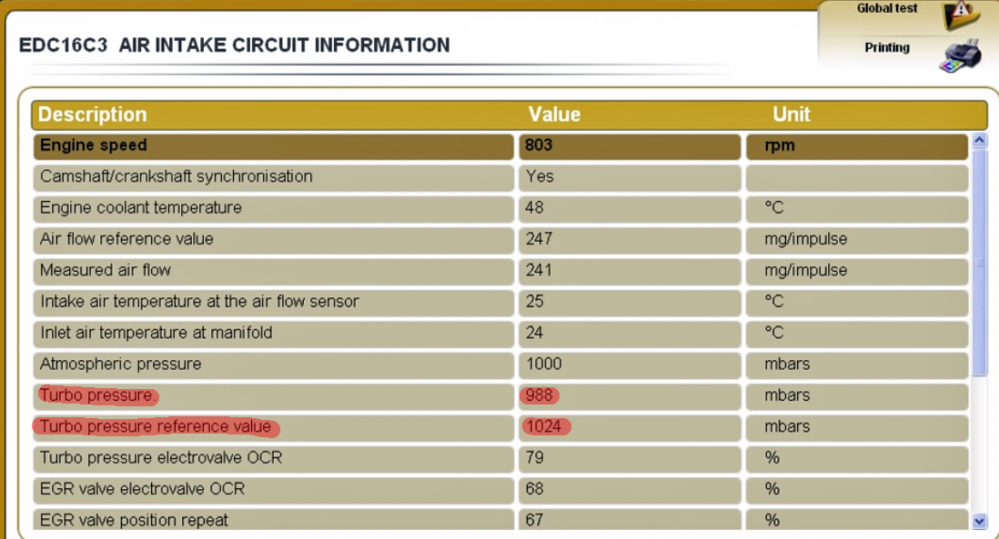

I wonder if somebody might give me the Diagbox turbo pressure measure not under load for say 1600 0r 2000 0r 2500 rpm for example?
I do not have Diagbox unfortunately unless somebody could lend in Beford area.
Below is the Diagbox turbo pressure measure not under load at 800rpm taken form this site for 1.6 HDI

Copied from another forum but it may help you:
Had a look under a Berlingo car and also commercial vehicle in the service box and for the M59 it gives a lower boost pressure than this for the DV6DM engine as follows but this is listed against the 92 bhp engine and there are no values for the 75 bhp engine:
Engine speed 2500 rpm, boost pressure 0.2 bar
Engine speed 4000 rpm, boost pressure 0.6 bar
However, under the M9 Berlingo for the 75 bhp engine it gives
Engine speed 4000 rpm, boost pressure 0.7 bar.
Hopefully someone with direct knowledge will spot your question.

Re: Diagbox turbo pressure measure not under load
thanks for that information I wonder is that under load?mickthemaverick wrote: 30 Jul 2025, 13:01 Copied from another forum but it may help you:
75 bhp engine:
Honestly not sure, this is the link to the forum I found it on, a full read of the thresd may answer that: https://citroen-owners-club.co.uk/citro ... -pressure/
