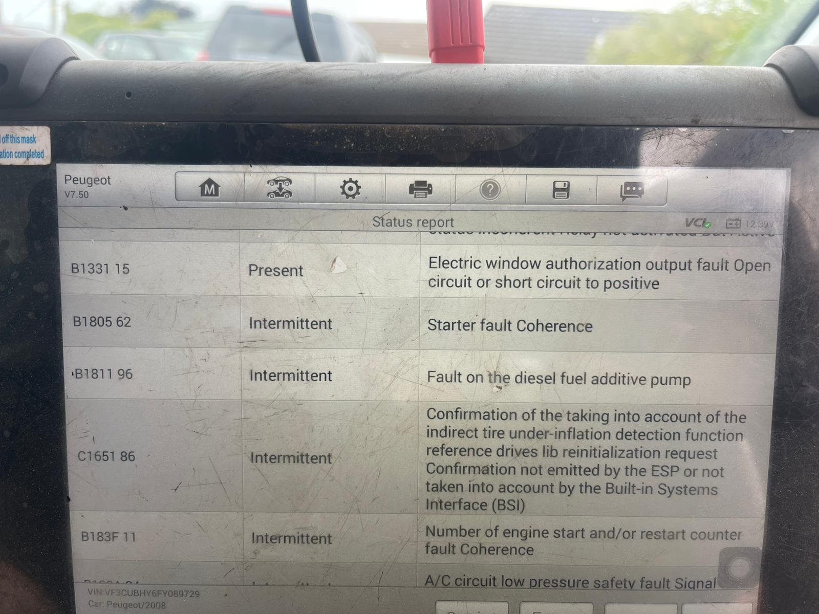

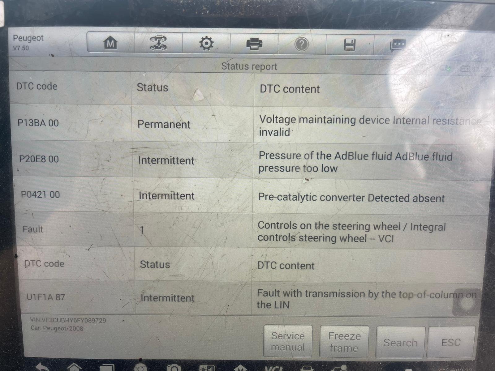

Hi everyone,
Have these fault codes come up, Adblue is obvious but concerned about the others, any assistance would be really helpful, many thanks!

If you have only recently aquired the car and this is the result of your first scan then I would advise that you clear all the codes and then run the engine for a few minutes and then rescan. That way you will know the codes are current and not be led up the garden path chasing historic faults. Once you have a current list of codes post them up and hopefully you will get some advice. :)

Thanks @mickthemaverick, I have had the car for over a year and had no problems with it up to now bar wear and tear. He cleared them, then they reappeared
