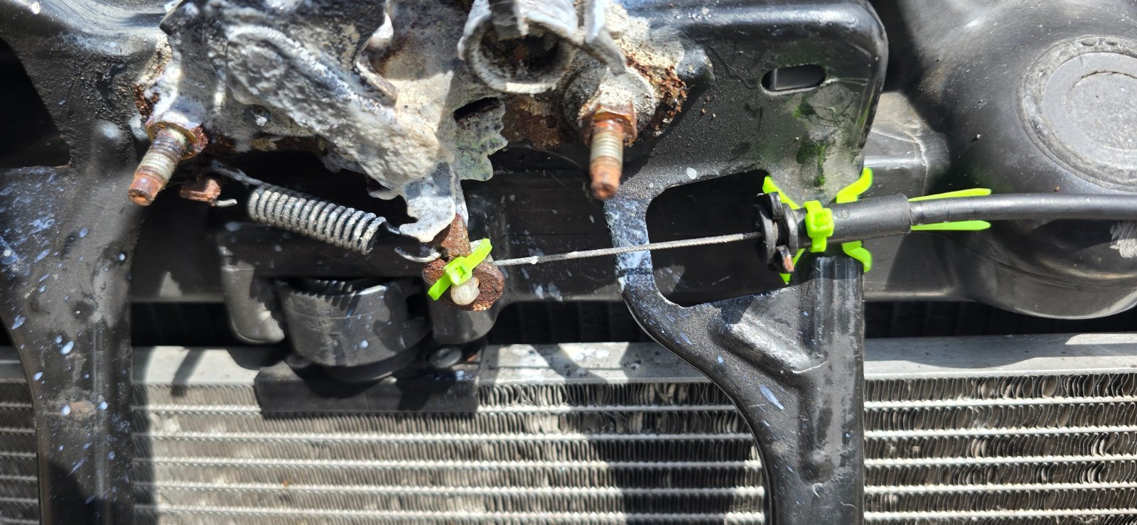

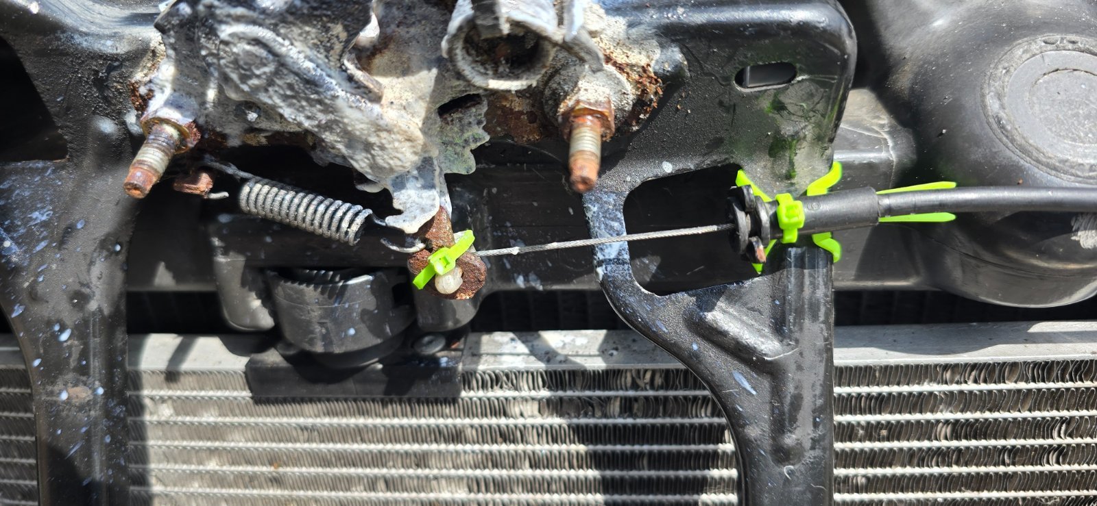

Future proofed the bad design. No more bonnet issues hopefully
Seems the thumb nail is the correct way around. But when you open the image its upside down

This seems to be a quirk of some digital cameras and most phone cameras.TehAgent wrote: 31 Jul 2025, 16:50 Future proofed the bad design. No more bonnet issues hopefully
The trick is to open your photo in an image viewer, rotate it 90°,the rotate it back and save it. Of course, if it displays upside down in your image viewer, rotate it 180° and save it.

Well, after my escapades of getting the bonnet open, fitted a new bonnet release cable.
So that's now back to normal
