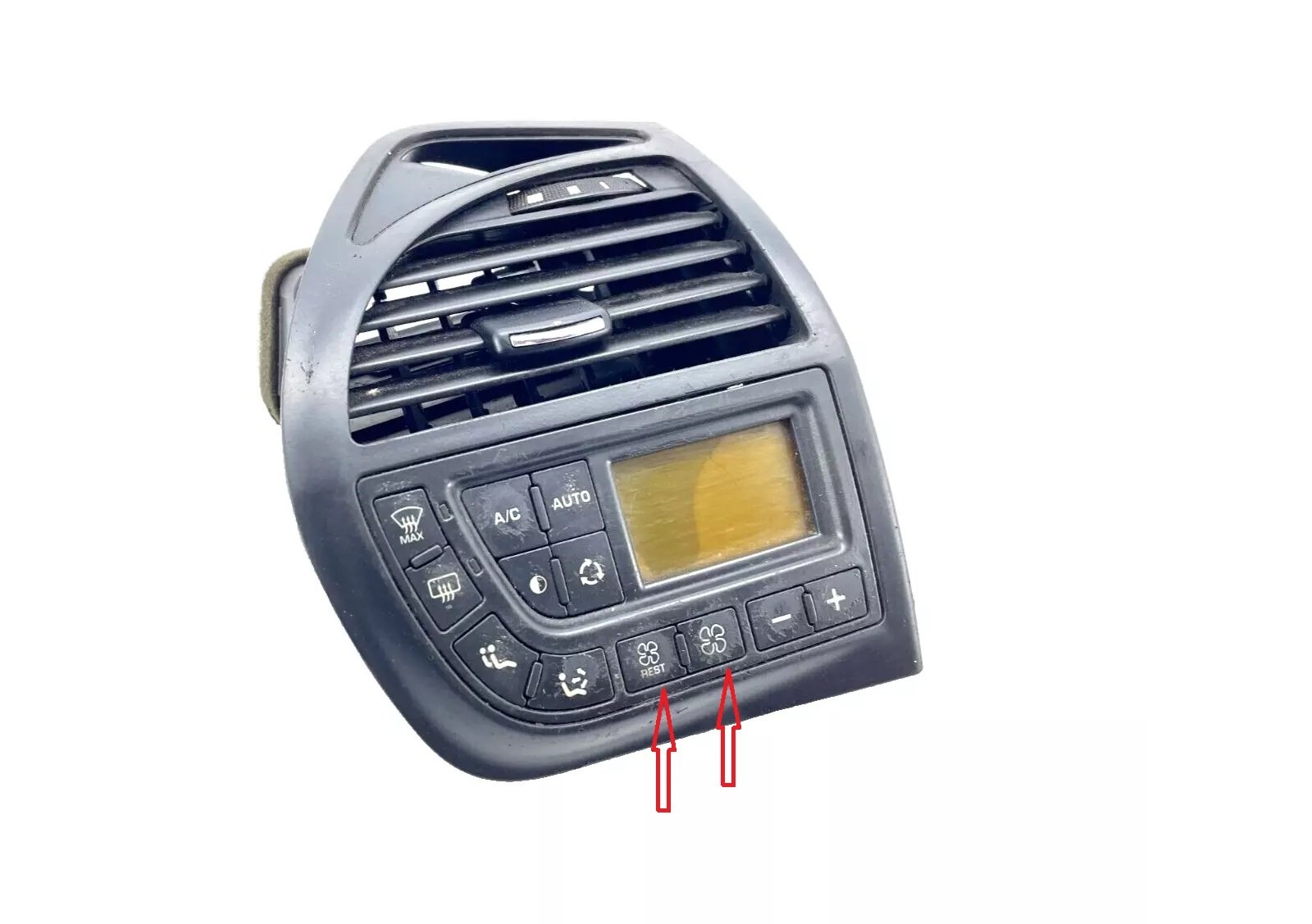

Assuming this is your control panel, is it the arrowed buttons that don't work?
Rekray1982
- Posts: 22
- Joined: 06 Feb 2024, 14:37
Re: Climate control
Mine doesnt have the display but a wheel instead for hot and cold. Yes those are the buttons that dont work and possibly the one for where the air comes from e.g. dash, windscreen or feet vents. I did take it out and remove the wiring harness and couldnt see any issues, no dirt or rust on the connections.

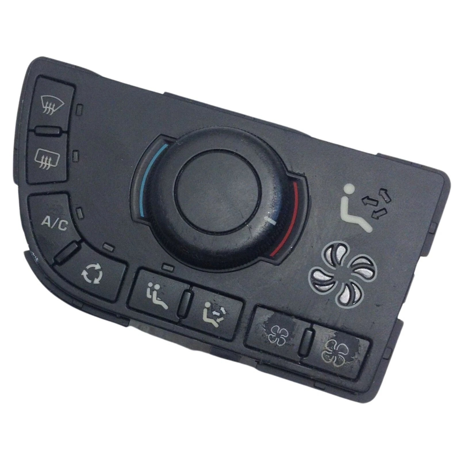

Re: Climate control
Like this one?
- Posts: 21031
- x 8077
Re: Climate control
Then the first thing to do is make sure the connectors on the back are pushed home properly, you may have to prise the panel out with a trim tool to get access. If they are connected properly then it is possible that the switches themselves have died but as there is a line of switches not working I think a loose or even disconnected plug is more likely. You can replace the whole panel with a used one fairly cheaply to test it out, eg: https://www.ebay.co.uk/itm/256981576077 ... e6c2ad65e7
