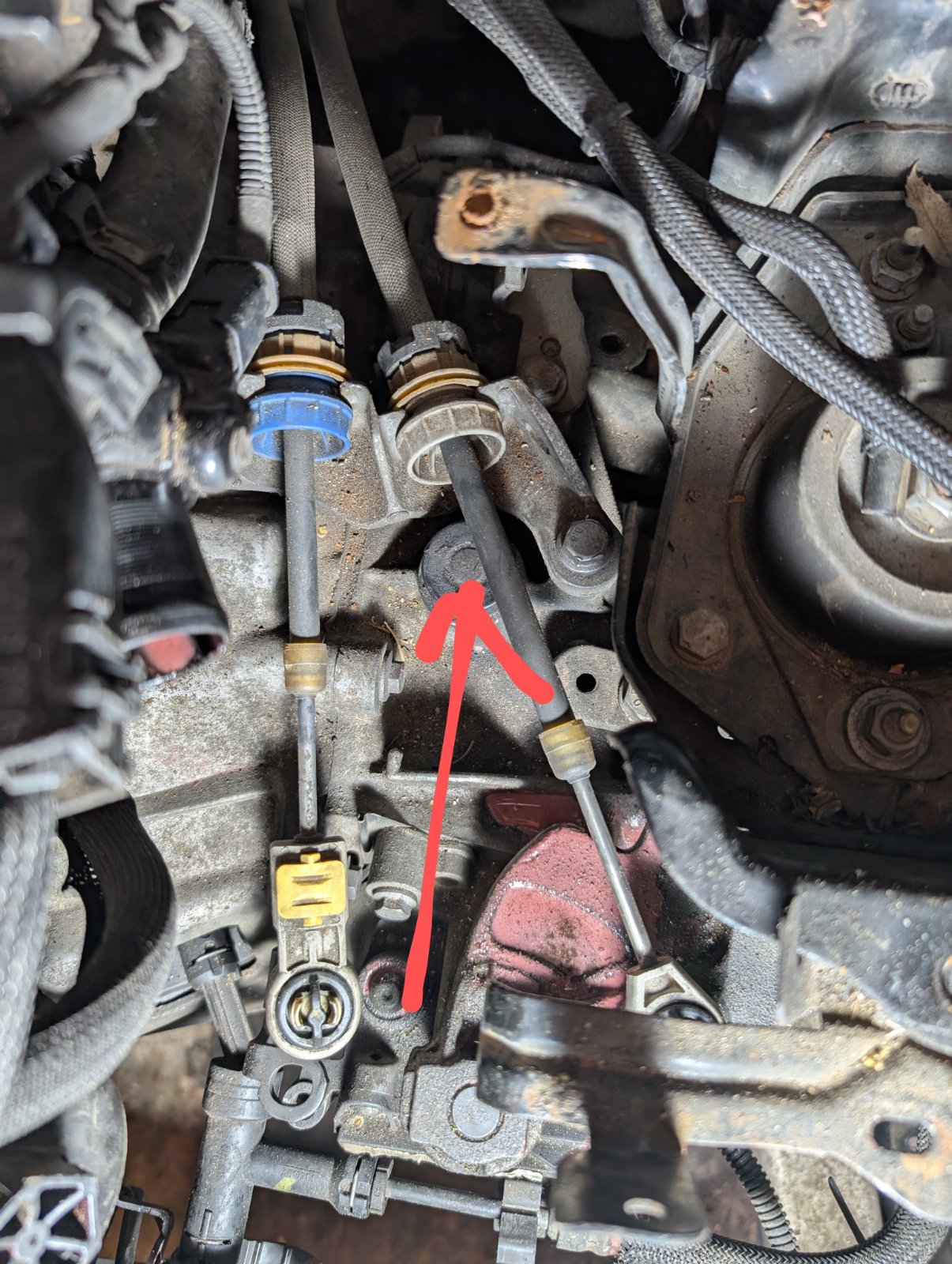

does anyone know where to find the crankshaft locking hole location for this engine in a 308CC from 2010?
I'm assuming it's on the flywheel side near the oil filter but I can't see a thing!
the guide helpfully just says 'Turn the crankshaft until the locking pin fits'!

EP6 5FV. That's the 1.6 normally aspirated
Am wondering whether this is it.

i have now found the bore. it's uncovered and high up on the bellhousing side of the exhaust manifold. accessed from under the car.
