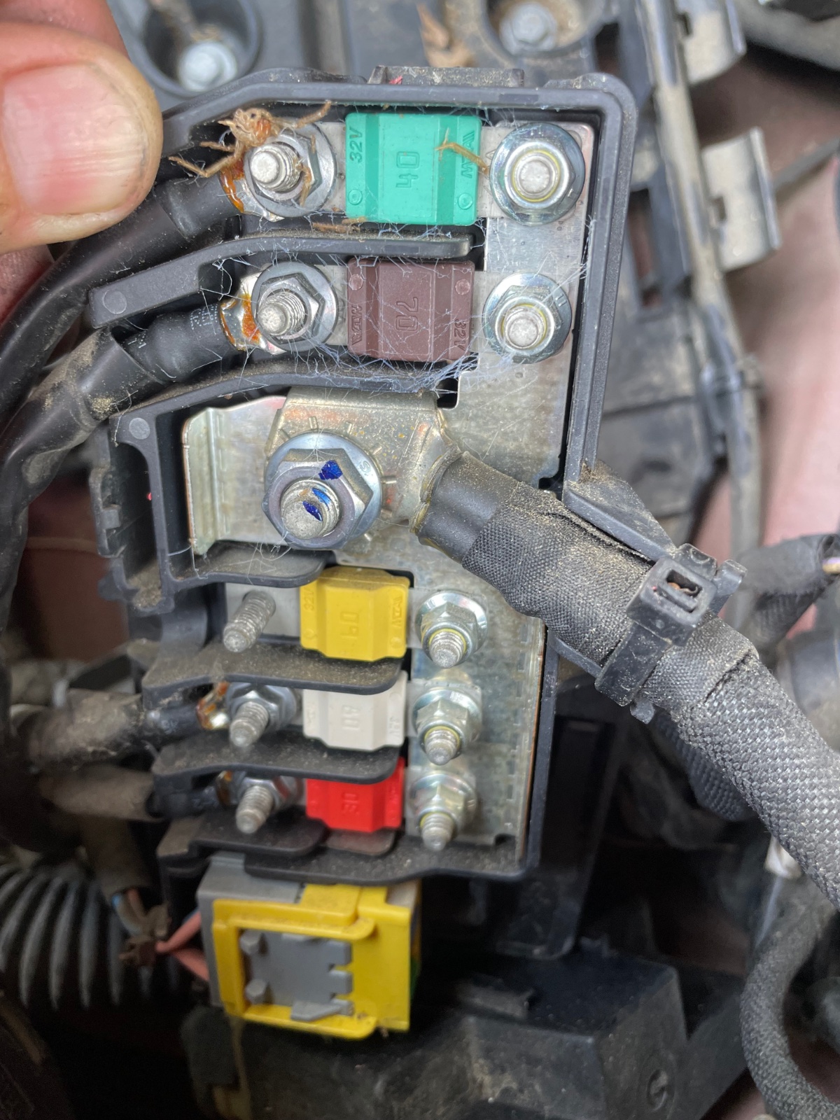

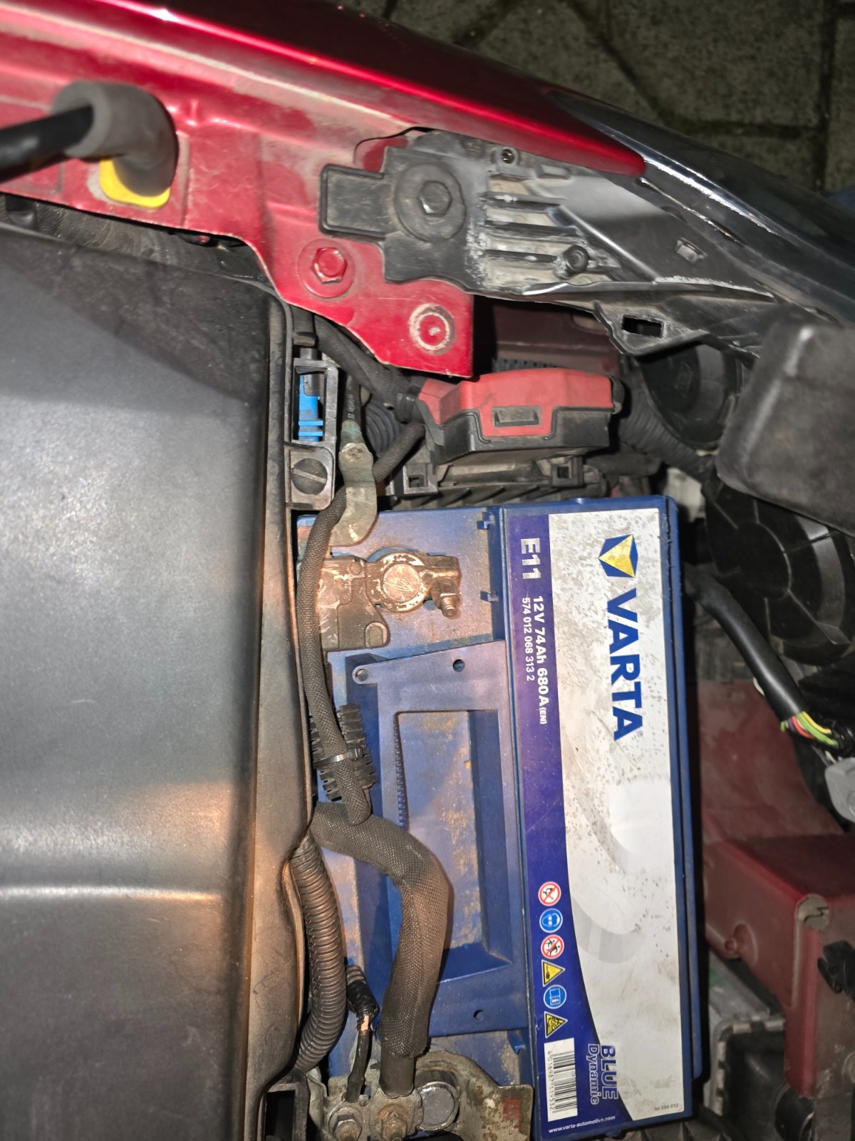

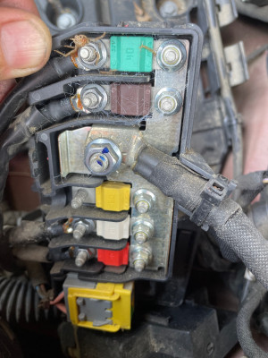

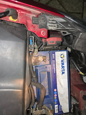

You, say, that you check the fuse behind the battery, but i told you to check the fuse BEHIND the left headlight!!
Between the headlight and battery is a little fuse box, and inside is an 40 Amp fuse.
If the hd pomp is not working, most of the time, this one is blown.
The reason could be that the brushes inside the motor are messy with carbon and the lds fluid.
You can find here several post how to repair/clean this
About the spheres, they will not be damaged by this, because there are no fluid pressure under the spheres, therefore you have no suspension anymore. Here you see the red box behind the headlamp and the battery.

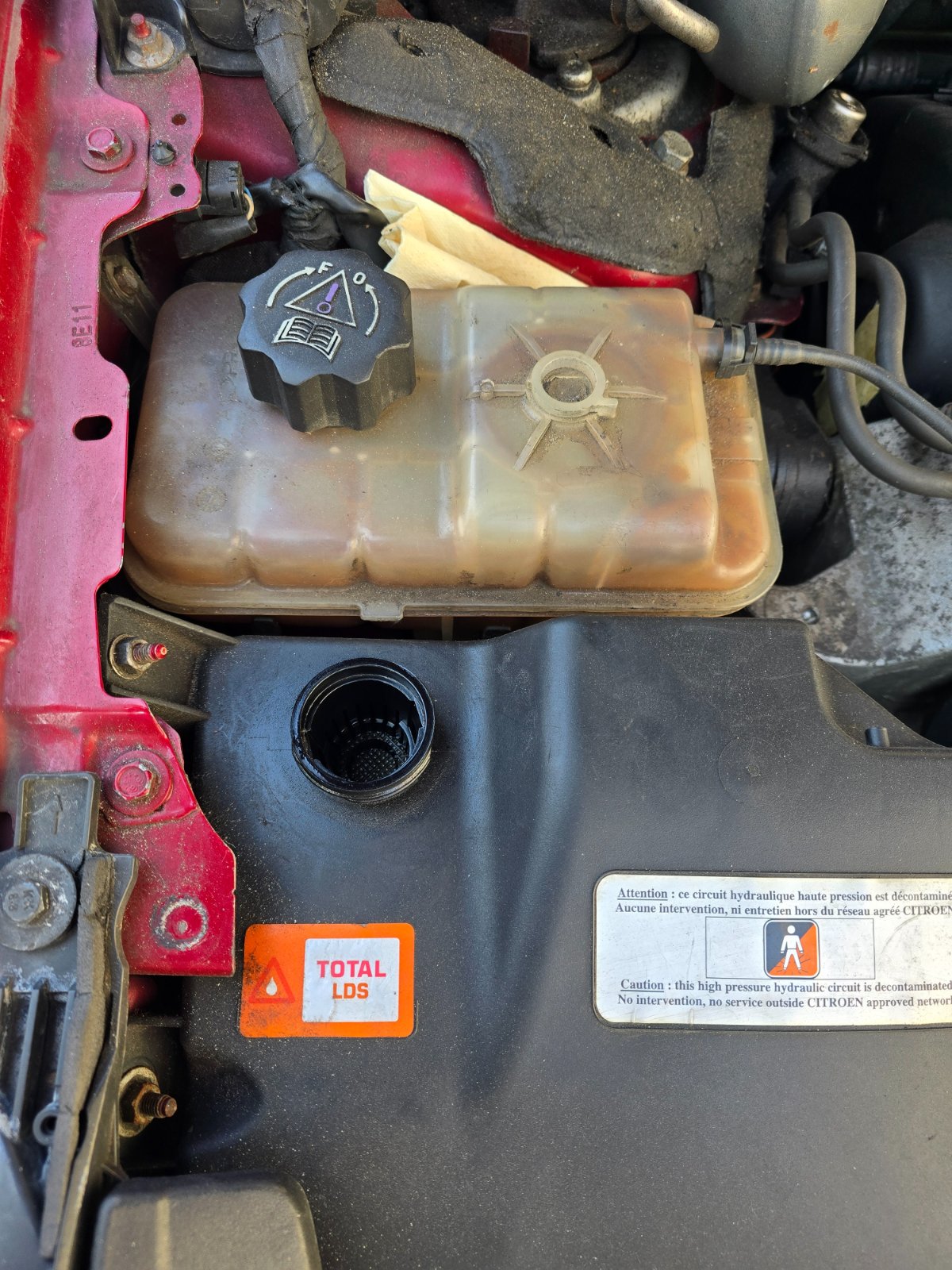

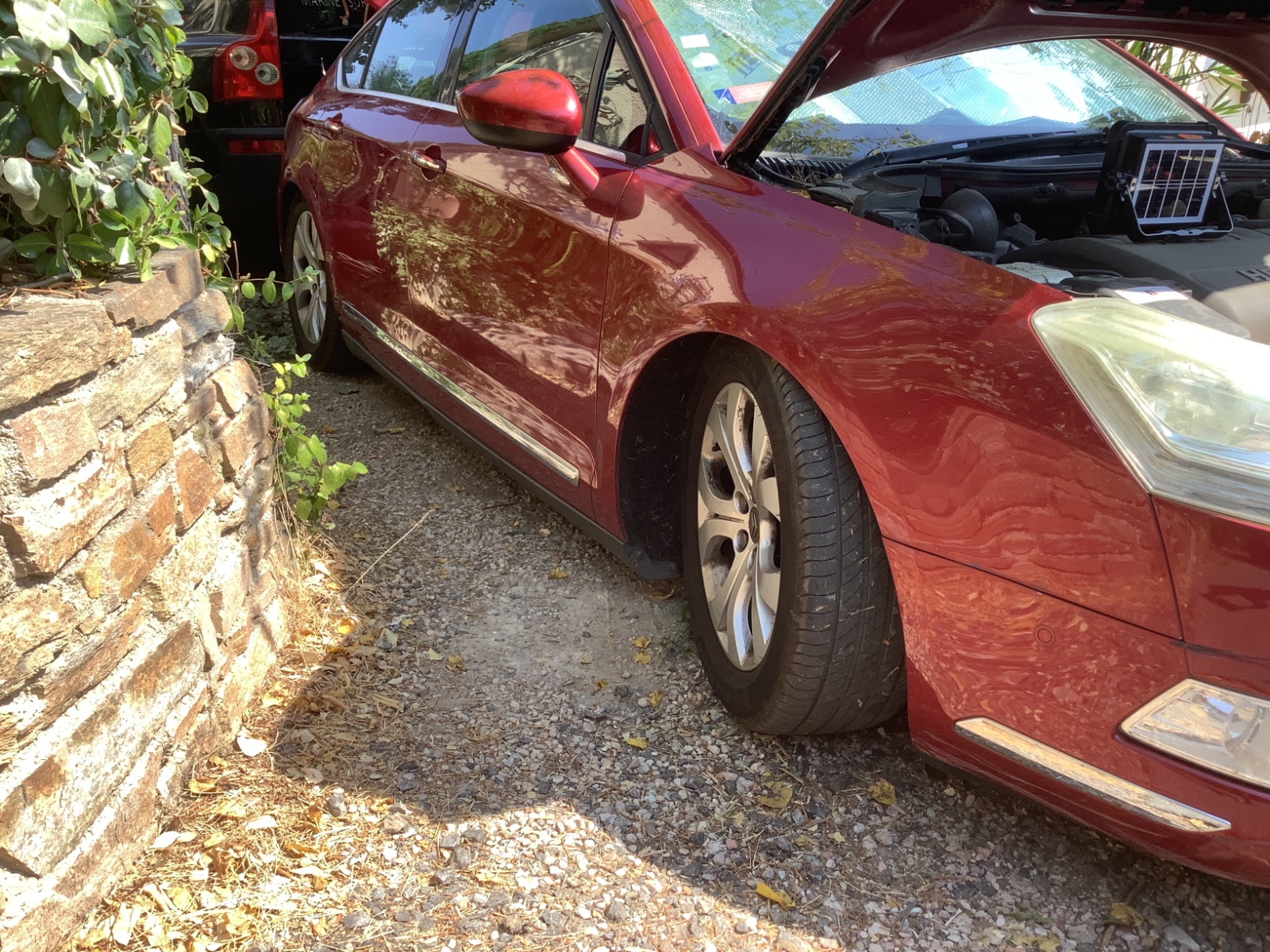

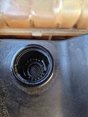

Hi Kees, I found the fuse box you were talking about and checked the continuity across each one. Thank you for persevering with me! The fluid level is below max see photo. The car is sitting right down at the moment. As it’s not the fuse and I don’t have an LDS leak would you say that the sensors are the problem? I also need to change the rear brake pads now as they are worn out but am having trouble getting my jack under the car. I have a gravel drive so may have to dig a hole. Any ideas? Thanks again in advance

I cannot see the lds fluid level, you have not removed the black lds tank cap to look inside. With the suspension on low the fluid should be at the bottom of the strainer in the tank neck. The off white tank that can be seen in your photo is the coolant expansion tank.
To check if the suspension pump is running simply start the engine and set the suspension height higher than it is now and if you can hear the pump and the car rises you know the pump is working.

@Paul: a little correction, when the car sits so low, you have to see the fluid level higher, this position is the same when you use the diagbox to lower the car in the lowest position.

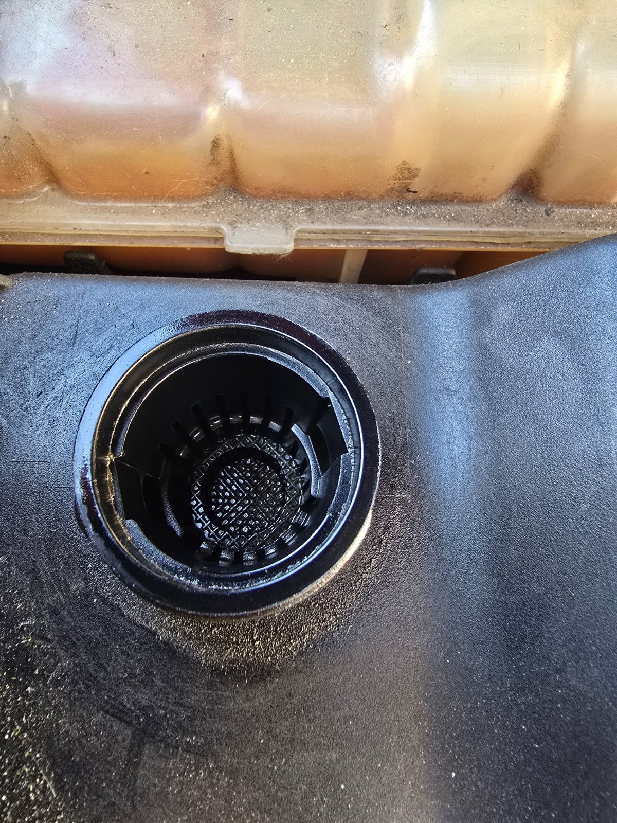

I'm sorry to say, but i wonder about your technical skills...you put a picture of the coulant tank, but the LDS tank is just before this one. Look at the pictures. .Even on the tank you see a sticker with the text LDS !!!
When you screw of the cap and you look inside, you should see the lds fluid now around the niveau mark, because the car is in the lowest position. The level must between a and b.

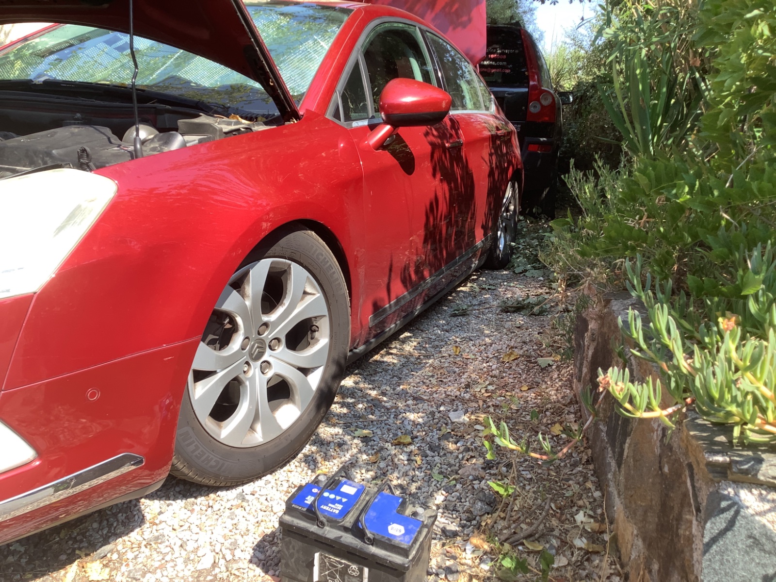

About changing the rear brake pads, first make contact without starting the engine, then release the parking brake, leave the contact on and disconnect the battery .
By this way the parking brake will remain of and you can replace the pads easily.

If you are going to jack the car up you are supposed to first raise the suspension to max height with the engine running so the pump runs, switch off, then slacken the lds tank cap and leave loose until the car wheels are back on the ground after being jacked up. Failing to loosen the cap can result in the lds tank splitting. Make sure you slacken the lds tank cap and not the coolant expansion tank cap having already mixed these up. If you do not raise the suspension you can end up with all sorts of suspension problems.
