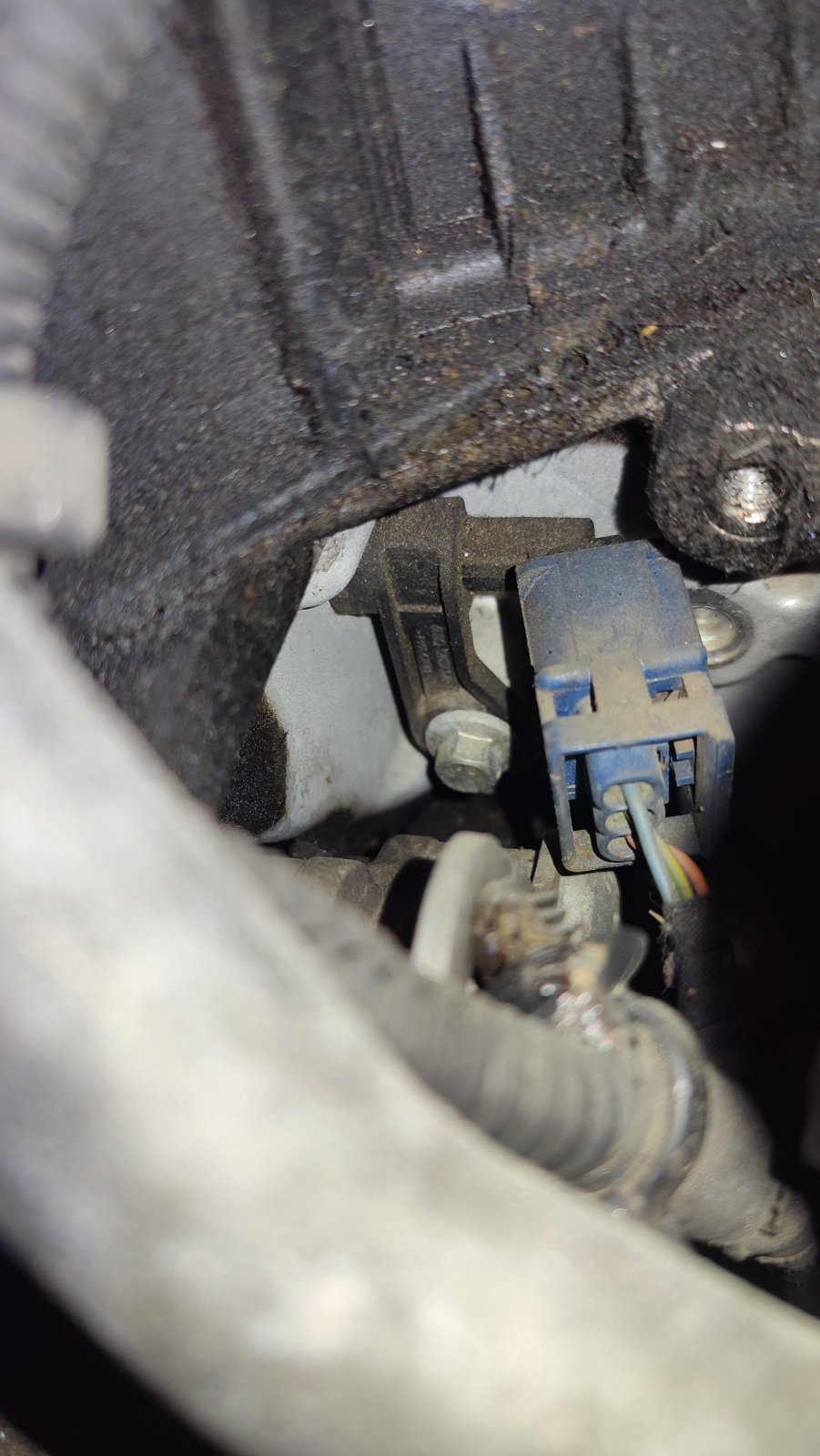

Re: Citroen C5 X7 3.0 HDI V6
Thanks everyone.
I checked on another forum, and they tell me it's on the left side of the front bench, under the common rail ramp. I'll look into it and keep you posted.
Best regards.

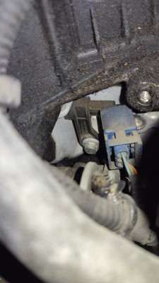

Ya está cambiado, aunque sigue dando error, tendré que mirar el cableado. Alguna idea?
It's already been replaced, although it's still giving an error. I'll have to check the wiring. Any ideas?
Something looks amiss in that photo - a bolt is missing and something is dislodged. Is that how you found it, or have you removed a bolt and lifted the cover to expose the sensor for the photograph?
