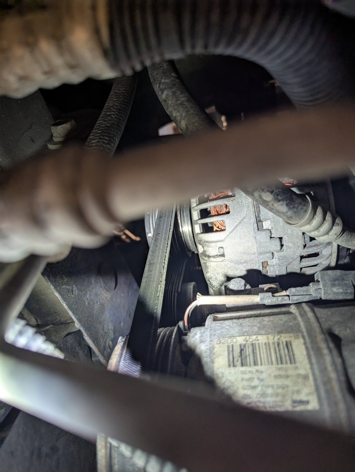

I took a look at the car yesterday while i did a wheelbearing on it.
It seems like the alternator or its freewheel is the culprit, as the belt is to the right on it and to the left on the rest (ac comp, PAS pump etc..). See pic The alternator is sticking "out" too far it seems. The freewheel seems quite shiny and the whole alternator could have been changed as it is'nt that corroded.
But when i look at my motorfactors website or Autodoc etc.. They only list one type of alternator and freewheel
So it doesn't seem very likeley that they have fitted the wrong parts?
But it might be time for a "ctrl alt delete" and a new alternator..
