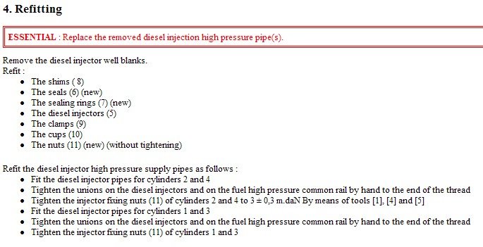

30 Nm

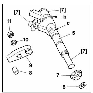

Is this definitely for a 2005 Citroen relay 244 2.2hdi
As the image and text seem to relate to a stud fixing rather than a bolt, mine has a bolt not a stud and nut
Just want to be sure as iv had an injector clamp bolt snap in the past on this van

I selected DW12UTED so hopefully should be correct. Before i looked it up i had it in my head from memory it was between 30-35 Nm (which feels far to slack in my opinion).
