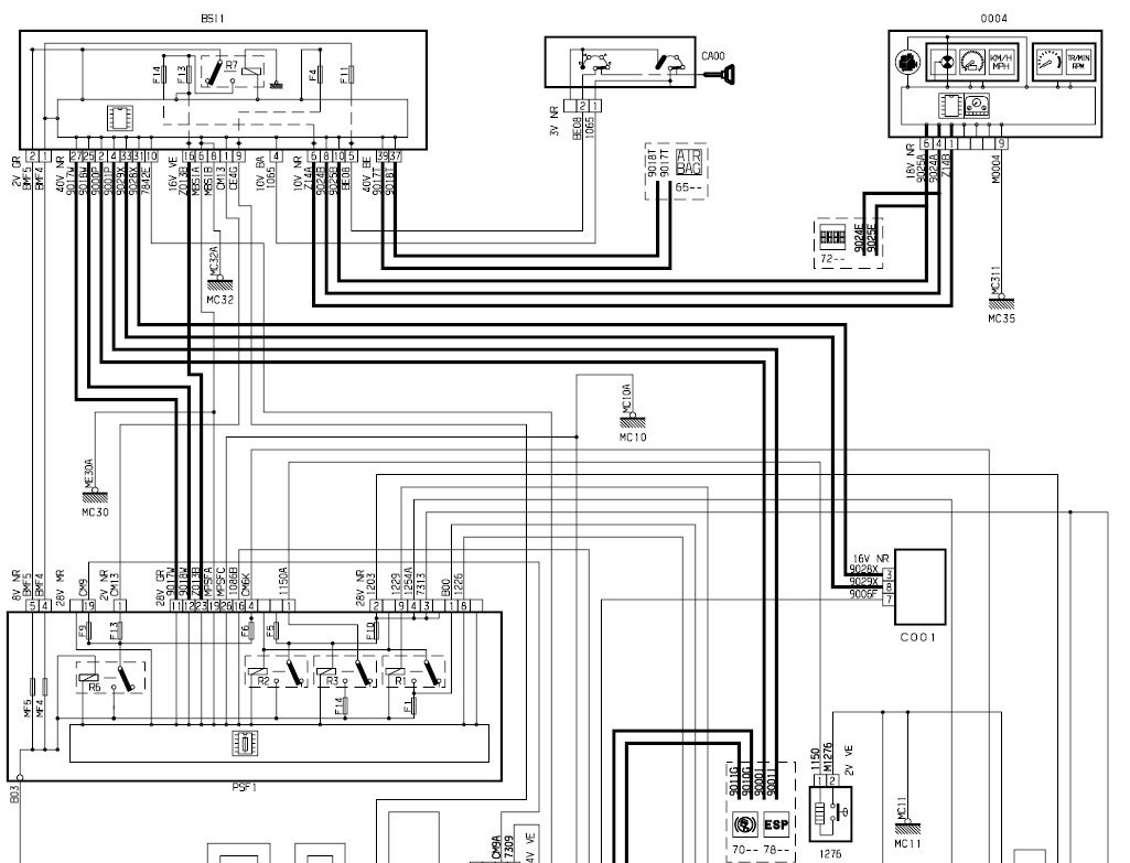

Hi I need a wiring diagram of the solenoids on the Citroen C3 1.4 hdi high-pressure fuel pump. Does the wiring go to the BMS or to the engine management, or both? I am getting 12V on both sides of the connections, one of the solenoids

What year & what variant of the 1.4 HDi? 8v or 16v?
I have no idea what a BMS is.

Citroen c3 1.4 hdi 2006 mk1 and that was bsi not bsm

On the low pressure solenoid the one on top of the high pressure fuel pump I have 12v on both terminals?

Is it the 8 Valve version or 16 valve version as they both have totally different injection systems.
Whats your VIN?

Hi, it's the 8-valve version. I can't put the VIN on here

The fuel pump is Siemens VDO k06_02 the injectors are Siemens (9663429280 VA20 N0267)

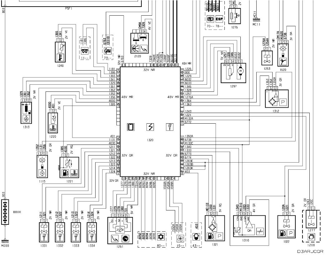

Had to do it in 2 half to get good resolution
The component codes should be on the wiki
