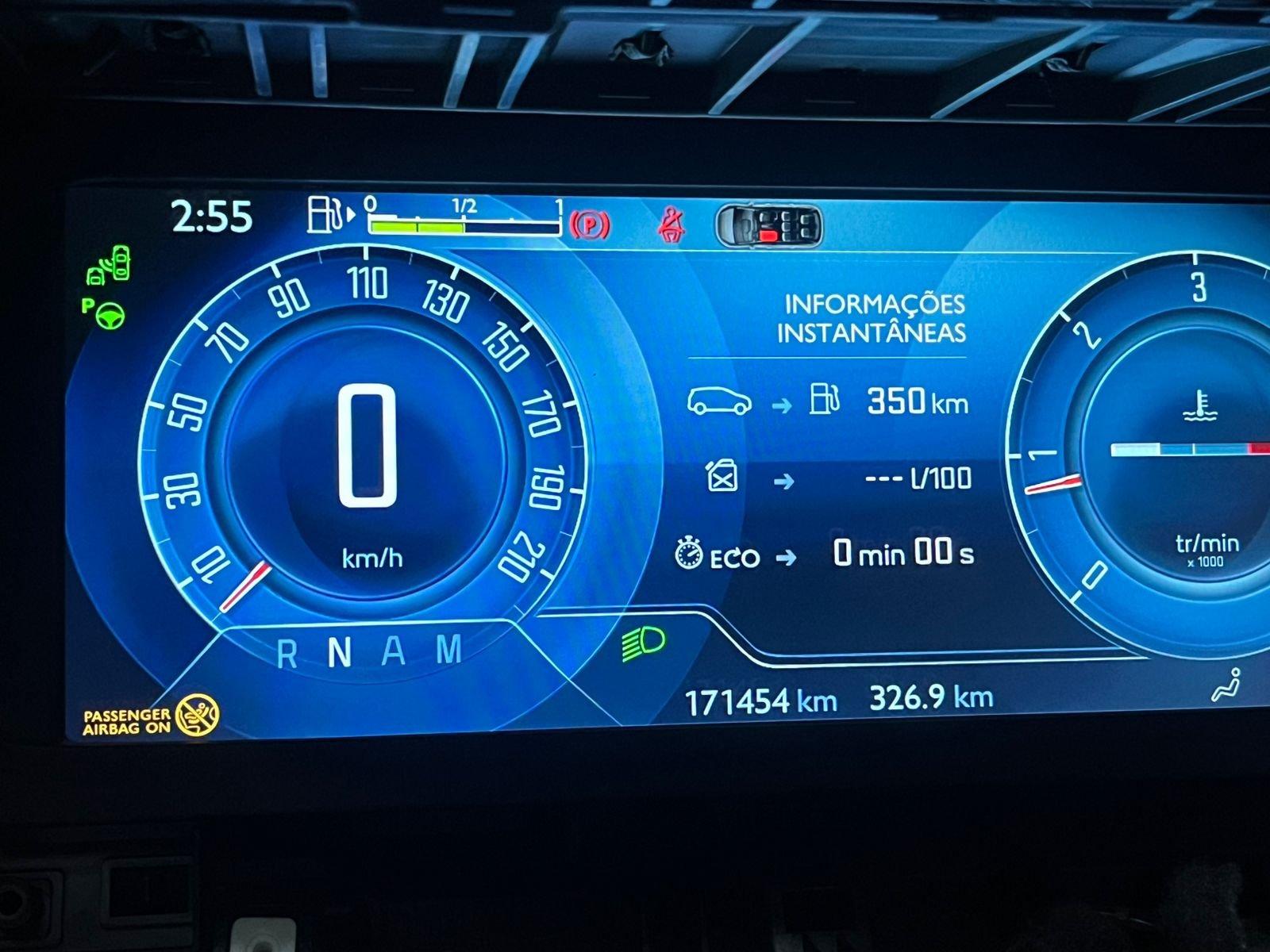

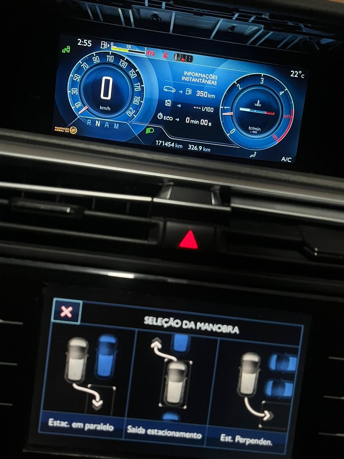

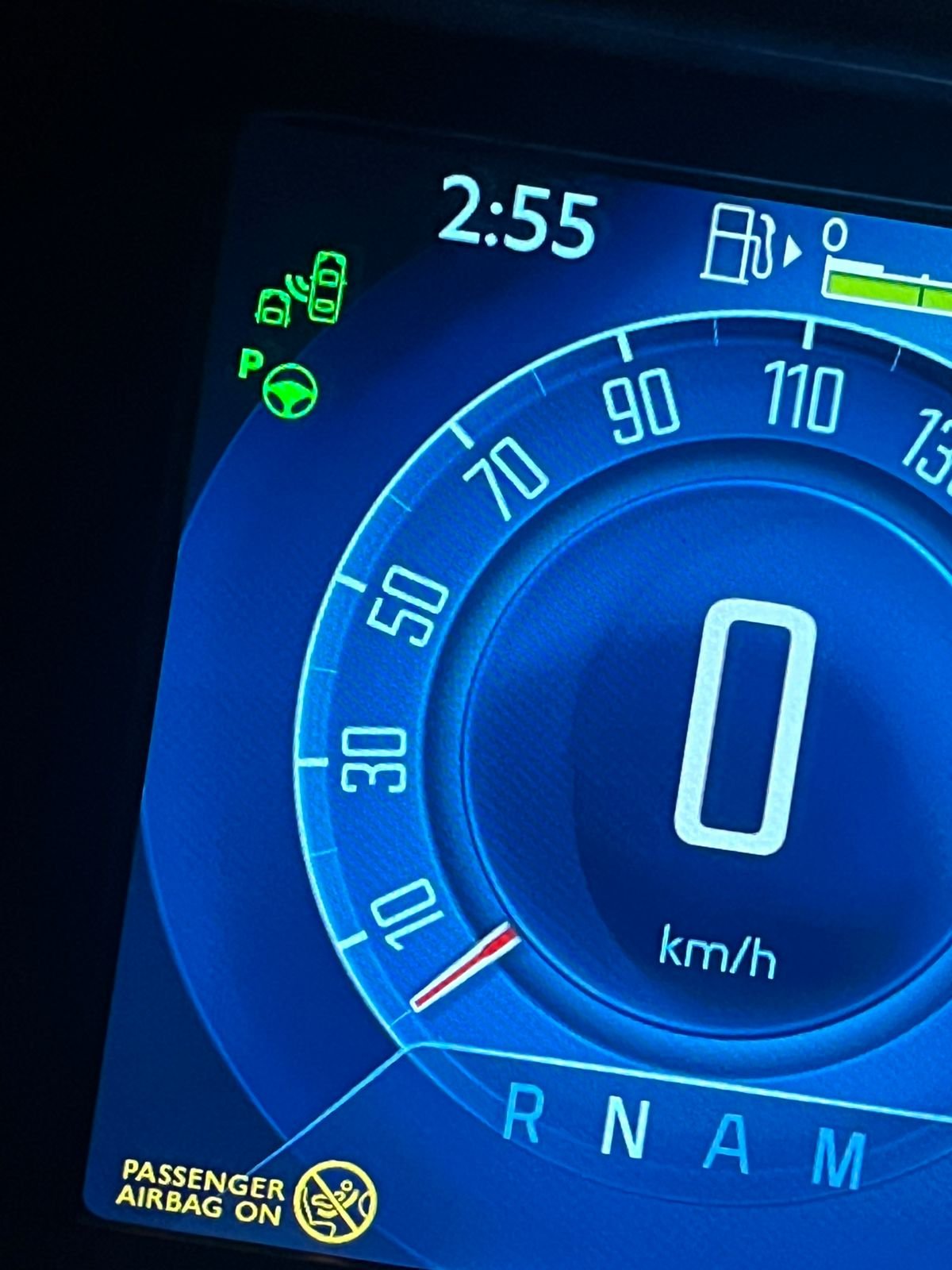

I press the "Park Assist" button on the steering wheel, and the options for park assistance appear correctly on the touchscreen (see image attached).

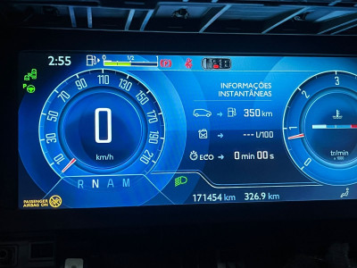

After I select an option, a green indicator also appears on the dashboard
However, the system does not show the next instructions on the dashboard — nothing happens after that.
Any ideas on what might be missing or misconfigured?

Having selected the manoeuvre you want what happens when you start to reverse the car? :)

mickthemaverick wrote: 13 Jul 2025, 16:45 Having selected the manoeuvre you want what happens when you start to reverse the car? :)
nothing

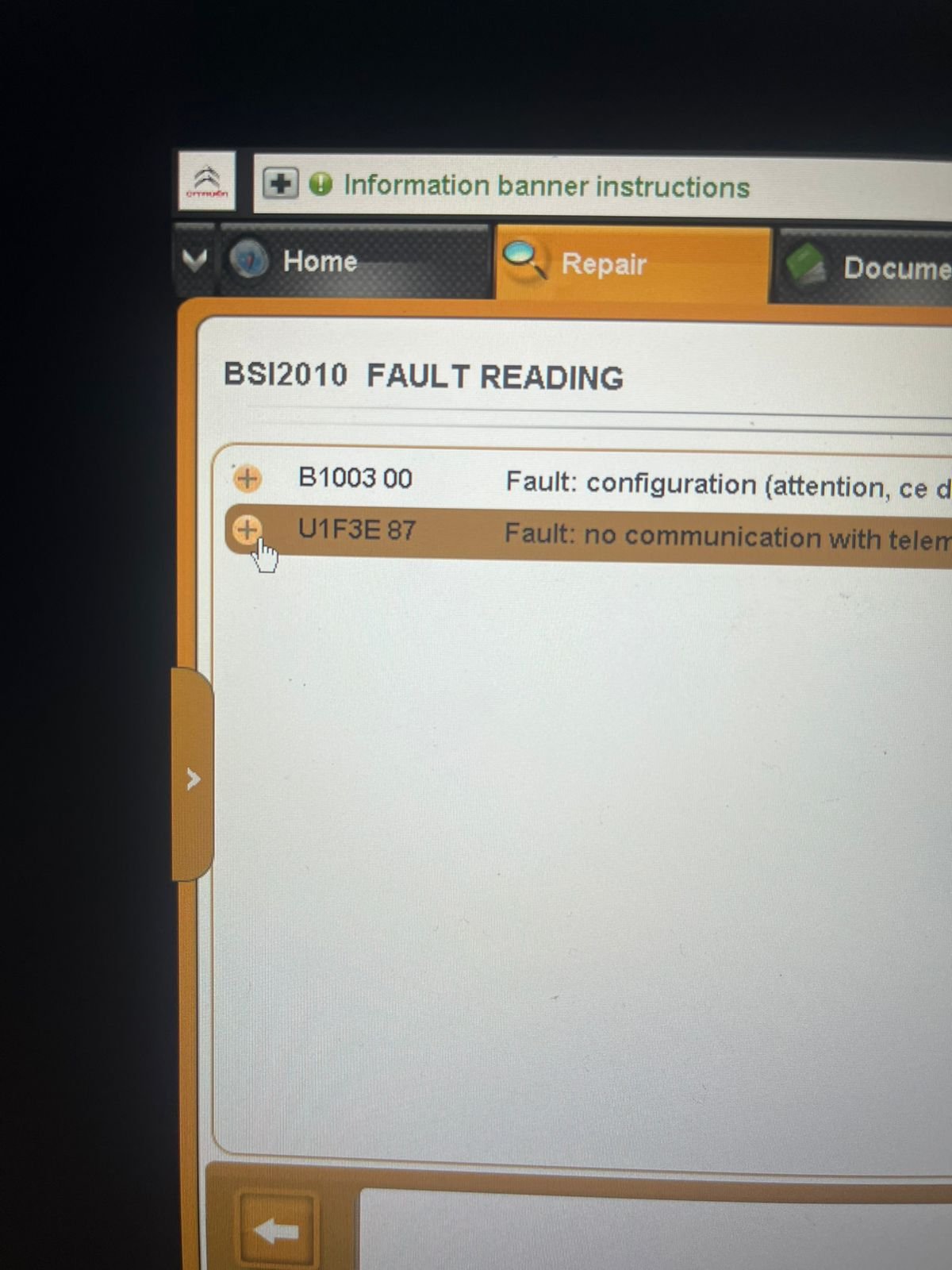

I would suggest you have the car diagnosed to see if the system is enabled and the sensors are all working as well as the speaker. It may be worth going through a BSi reset first just in case it clears the problem. :)

mickthemaverick wrote: 13 Jul 2025, 16:53 I would suggest you have the car diagnosed to see if the system is enabled and the sensors are all working as well as the speaker. It may be worth going through a BSi reset first just in case it clears the problem. :)

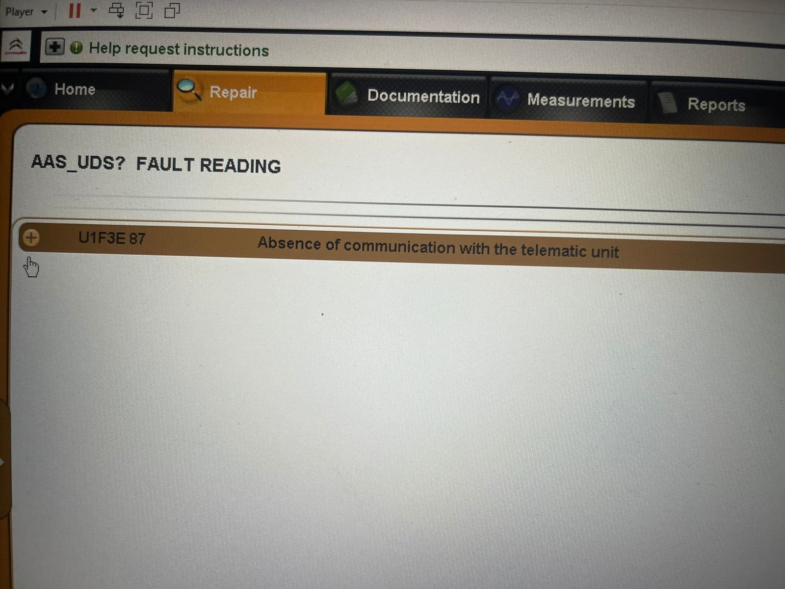

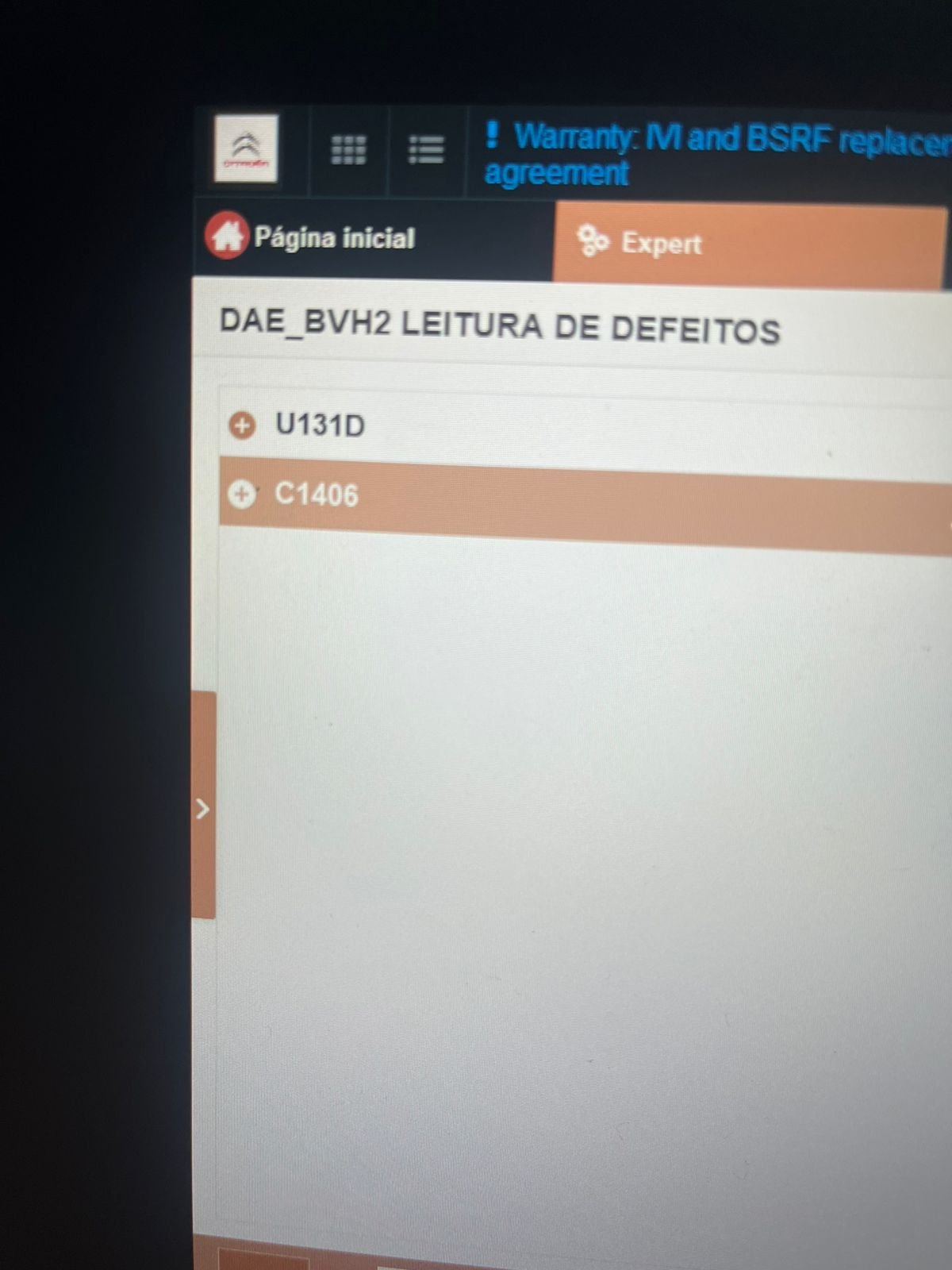

BSi reset done!
Test of parking sensors is OK!

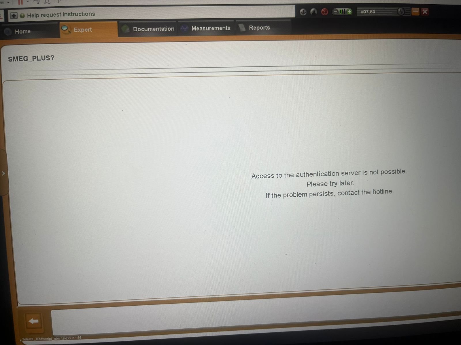

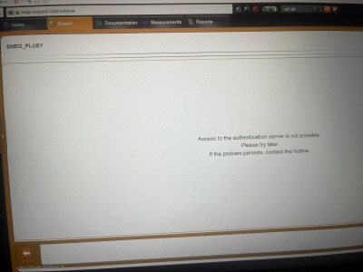

I can't access the configurations of SMEG (I updated to 5.43.A.R2 when put the new dashboard).
