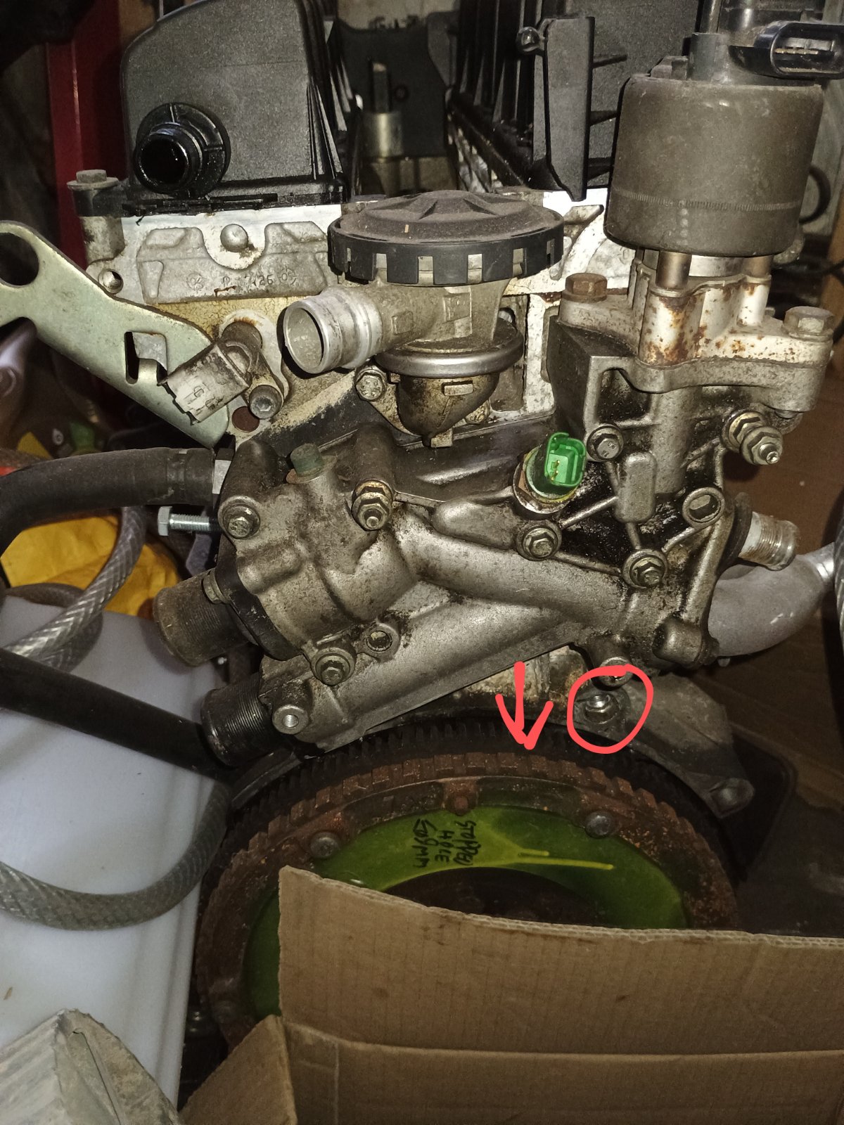

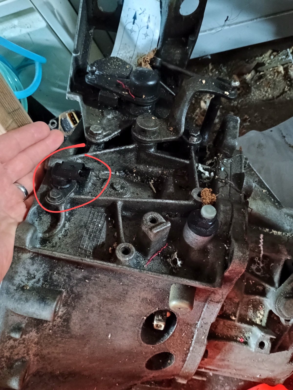

I can take a picture of the hole it sits in (which is actually on the gearbox bell housing rather than on the engine block) and roughly where that is relative to the engine. This will be two pictures as my EW10 engine is on a stand and gearbox on the garage floor at present!
But should give you a clue where to look.

The coolant manifold fairly well covers up where the sensor is.
Remove the air filter housing (assuming it's in same place as on a 406) to get nearer first.

Thanks for the photos Matt. You seem to have quite a collection there. My favourite of that lot is the 406 coupe. Design by Pininfarina I believe. Annoyingly many parts are unique to that model, hence hard to find.
