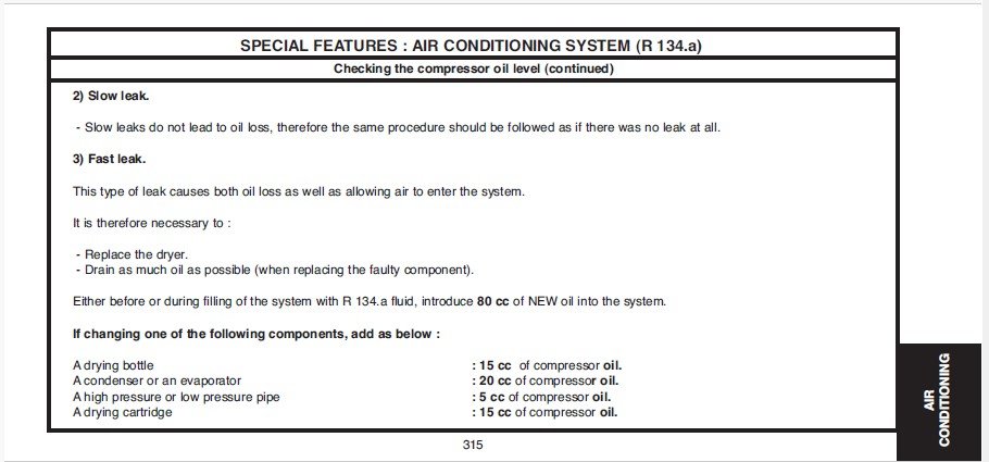

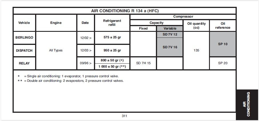

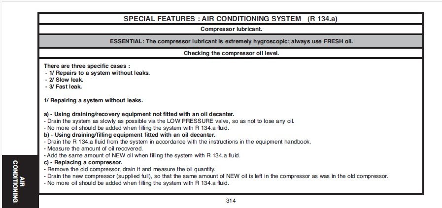

This video includes a chart giving a guide of how much oil is held in each AC component and it suggests 10% of system capacity is in the condenser, just need to know the capacity to get an idea how much to fill.
This chart should help you there: https://database26.com/citroen-refriger ... ity-chart/
Good luck
Good luck

Thanks! That's the information I was looking for. If i read correctly it's best to drain the compressor as well when replacing a component?
