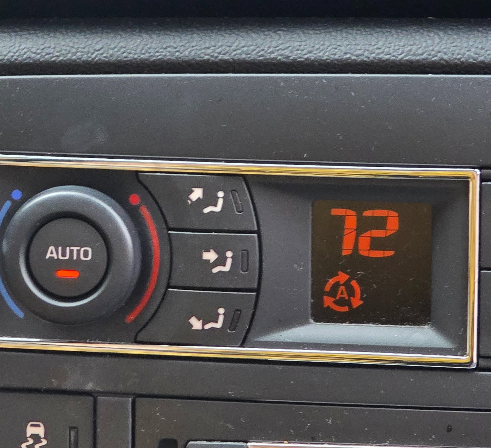

I wonder how to switch between Celsius and Fahrenheit on the climate control? (see picture)
I've been in the units menu, but it only changes the outside temperature display on the multimedia display.

This may only be configurable via Diagbox?

I've also thought about it.
But it was Celsius before and was changed by mistake when the kids were alone in the car for a while
I've searched and searched the instruction manual a lot, but can't find anything about it.

You have to go in the setup menu from the radio unit.
I have a NG4, press 2x, setup, then look at the menu and change from fahrenheit to celcius.

I'm testing this, but still can't get it to change. Attaching a movieKees wrote: 09 Jul 2025, 11:22 You have to go in the setup menu from the radio unit.
https://www.youtube.com/shorts/ien7oevQqlM
