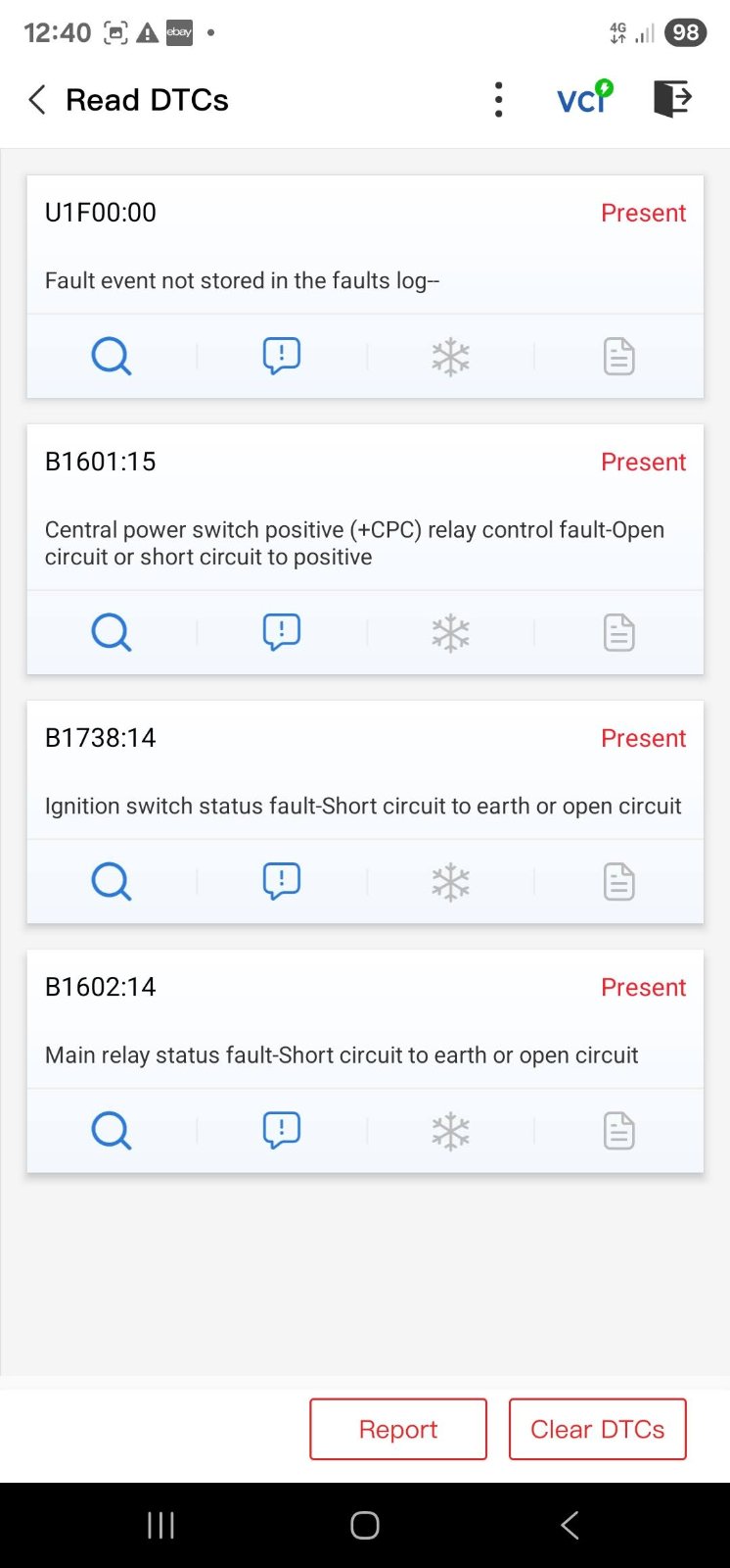

I recently remapped the ECU on my 508 blue HDI 120 and the next day during some testing I got a warning light about engine failure...
When tested, I got the following errors listed:
B1601:15
B1738:14
B1602:14
Talking to Chat GPT (very useful but not quite there yet), it suggested replacing CPC and main relays. Trouble is I can't find any relays in the engine fuse box or near it. I would appreciate any help with that.

Have you tried to remove the remap to see if the car reverts back to normal ?
