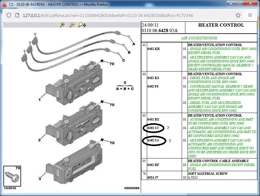

2. The manual A/C again if i remember right has mechanical cables to control temperature & air direction whereas the auto A/C has little mixer motors. has totally different part numbers

The "auto" air con is actually not that hard. You would need the loom that's on the air distribution box, the three servos, the electronic speed controller and the control panel. Some cars have a manual air source (inside outside) cable and some have a servo. If YOUR car has a push button for the air source selector, you wont need the 3rd servo. If you are getting parts from the breakers you need to source them from a car with the same instrument cluster and interior as yours. There are major and minor changes to the electronics over the years.
The 2 big snags with the auto air con is 1) the type of connector between the BSI dash loom and the aircon loom and 2) the type of auto controller. One is CAN BUS and the other is VAN BUS. You must get it right.

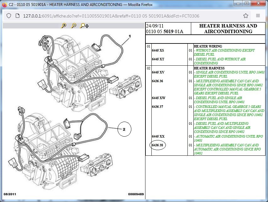

In the meantime I found a topic(about c3 if I recall right) where you had put some pictures of the whole system, how cool is that

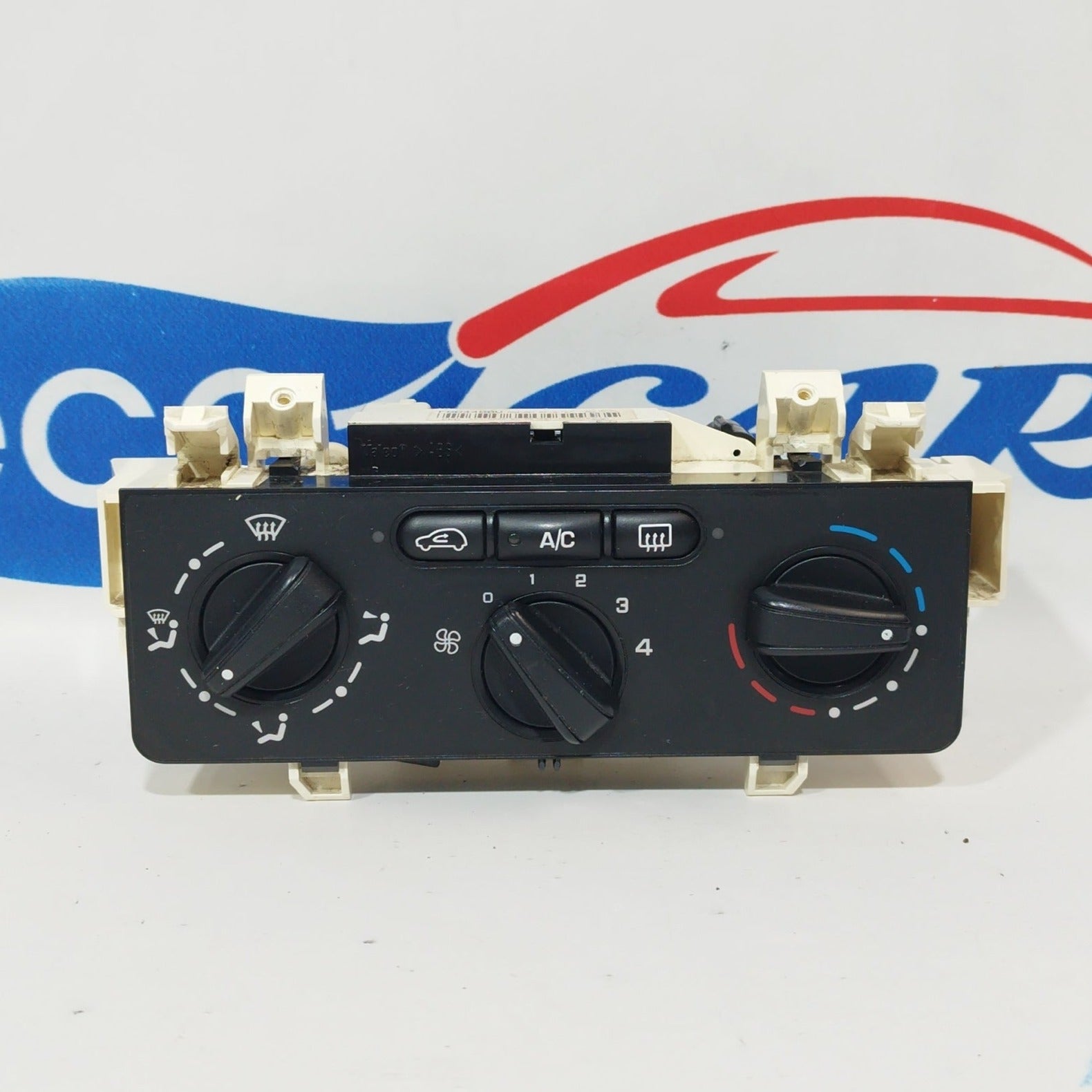

I have the push button for the source selector like this one
- Spoiler: show

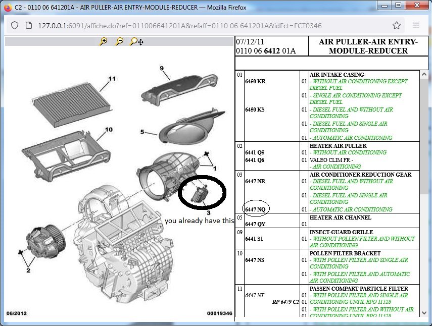

Then that's one less servo that you will need to get

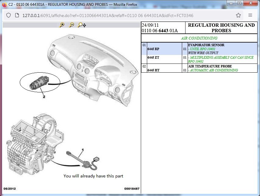

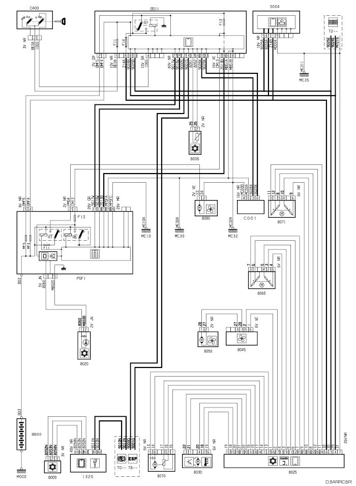

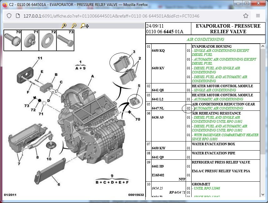

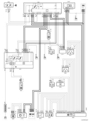

Here is what I can scrounge up. Items 8085 and 8045 are one item, the electronic speed controller for the interior blower fan.raz3n wrote: 05 Jul 2025, 19:08 P.S. A guy online said that has citroen service box access and told me that He can sent me the schematics from my VIN, but he can't sent me the schematics from an auto air con because he doesn't know any VIN for it.
Could those be any help?
Item 8025 is the control panel.
Items 8065, 8070, 8071 are the air direction and temperature servos.
Item 8030 is the interior temperature sniffer.
Missing from the circuit diagram is the outside temperature sensor. The car must have an outside air temperature indication on the central display for the auto AC to work.

Woah, thanks a lot for your input and your effort.ozvtr wrote: 06 Jul 2025, 04:57I Can only source the PSA (Citroen) numbers. Unfortunately they are not the manufacturers numbers that are actually on the parts.Then that's one less servo that you will need to getHere is what I can scrounge up.raz3n wrote: 05 Jul 2025, 19:08 P.S. A guy online said that has citroen service box access and told me that He can sent me the schematics from my VIN, but he can't sent me the schematics from an auto air con because he doesn't know any VIN for it.

So, As I undestand ( and of course once again I could be totally wrong), A full dashboard removal isn't required as I look at most of the places Are accessible through the glove box or the plastic parts from the steering wheel place?
