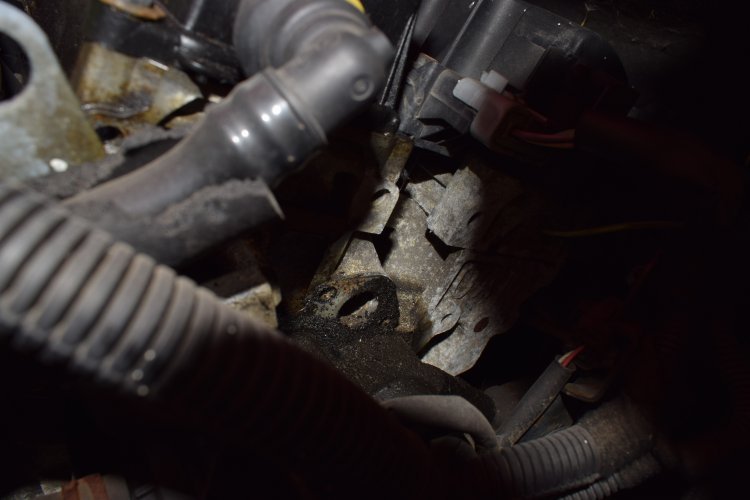

It has been running fine but it is a real fuel guzzler. Sucks it up like a V8. Runs OK but today it started playing up. Started and ran about two miles to the tip, then when I tried to start it up it decided not to. I gave it several attempts but didn't want to flatten the battery. There was a warning light that looks like an engine in profile, manual says Emission Control sytem warning light. I let it rest a minute or so while I checked for a blocked fuel cap vent. (ever hopeful) Got back in and it started but faded out when I tried to give it some revs. Tried again and held moderate revs and noticed the warning light was now a yellow triangle. Service warning light. To avoid a costly recovery to a garage I can't trust I took the chance to return home. Once out of the speed restricted area I gave it some welly up to 90kph and then eased off and rolled easy into my drive. No warning lights now but I am reluctant to risk going out in it again until I find a reason for the problem. I bought a set of the correct plugs a while ago and thought it would do no harm to fit them. Damned if I can find where to put them. No visible distributor or plug wires or plugs to be found. Great! They're probably somewhere inaccessible. While searching I discoverd a mystery hole in the right hand side of the cylinder head/block (?). See photo below. Not clear in the photo but the threads are shiny and clean, as if it has recently come loose and fallen off. What is that all about?
For reference the car is a 2006 307cc 2.0 i 16v 143 (EW10A)

The question of "Is something missing/fallen off" still remains.
