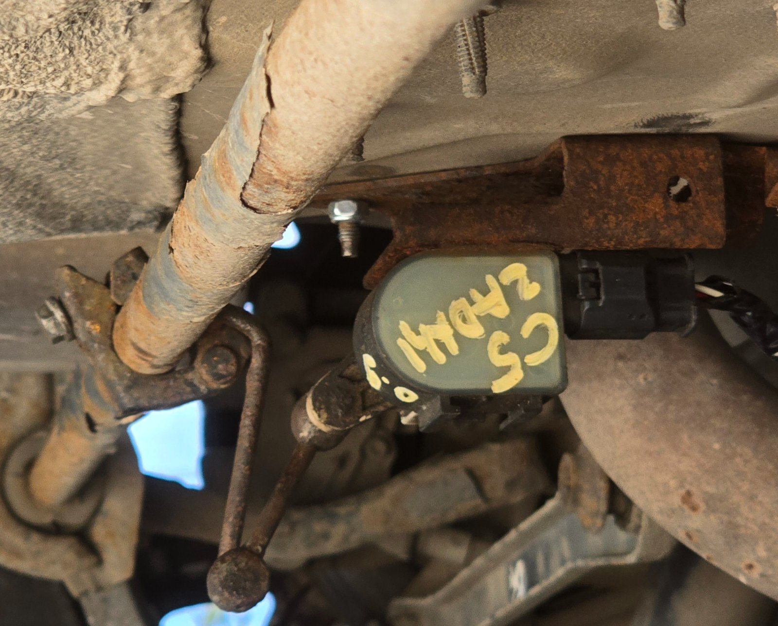

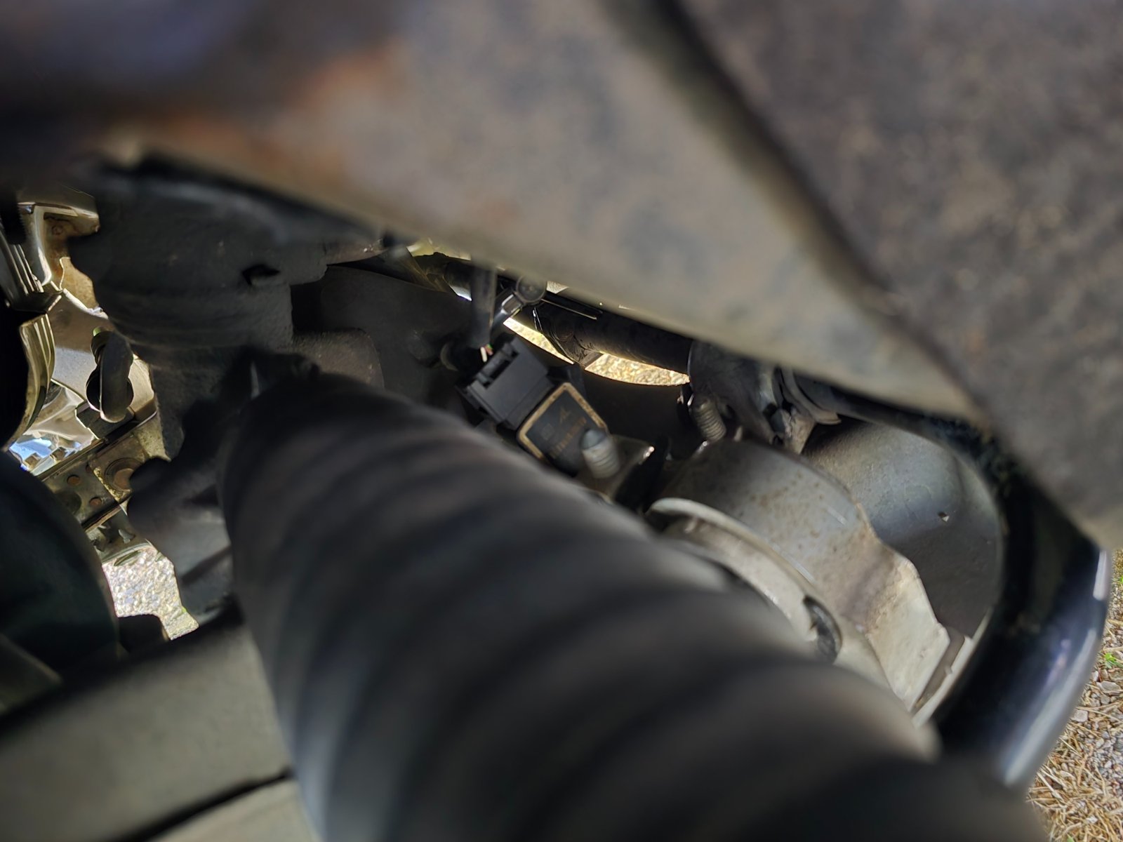

Installed Height sensors on front and rear axle.

Headlights ECU can be reprogrammed to Steel suspension after that ECU is requesting both front and rear height sensors
Even though they are connected and installed properly, I am getting a fault for an open circuit of them.
And the rear Height sensor is reading an invalid value in Parameter measurements
The front one is also not changing % when moving it, but at least it is reading something from it.

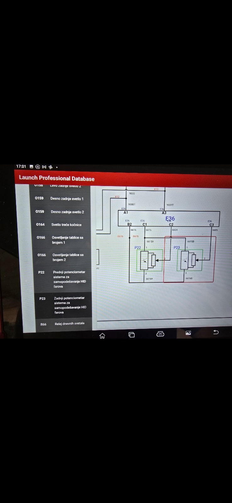

Since I took all the parts, headlights, and auto adjustment unit + height sensors from a car that had hydroacitive, could it be possible that even though ECU is reconfigurable that it does nothing to it, since on the connector for leveling ECU I didn't have wires for leveling height sensors I just used diagram and added pins to a connector to be more precise (B2, C1, C2 and C3) Pins.
But still get these errors and can't program height sensors.

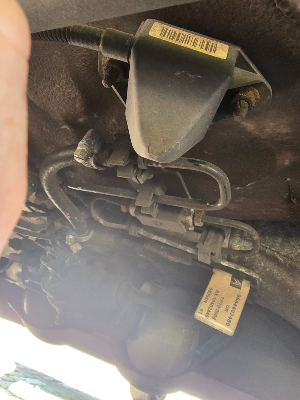

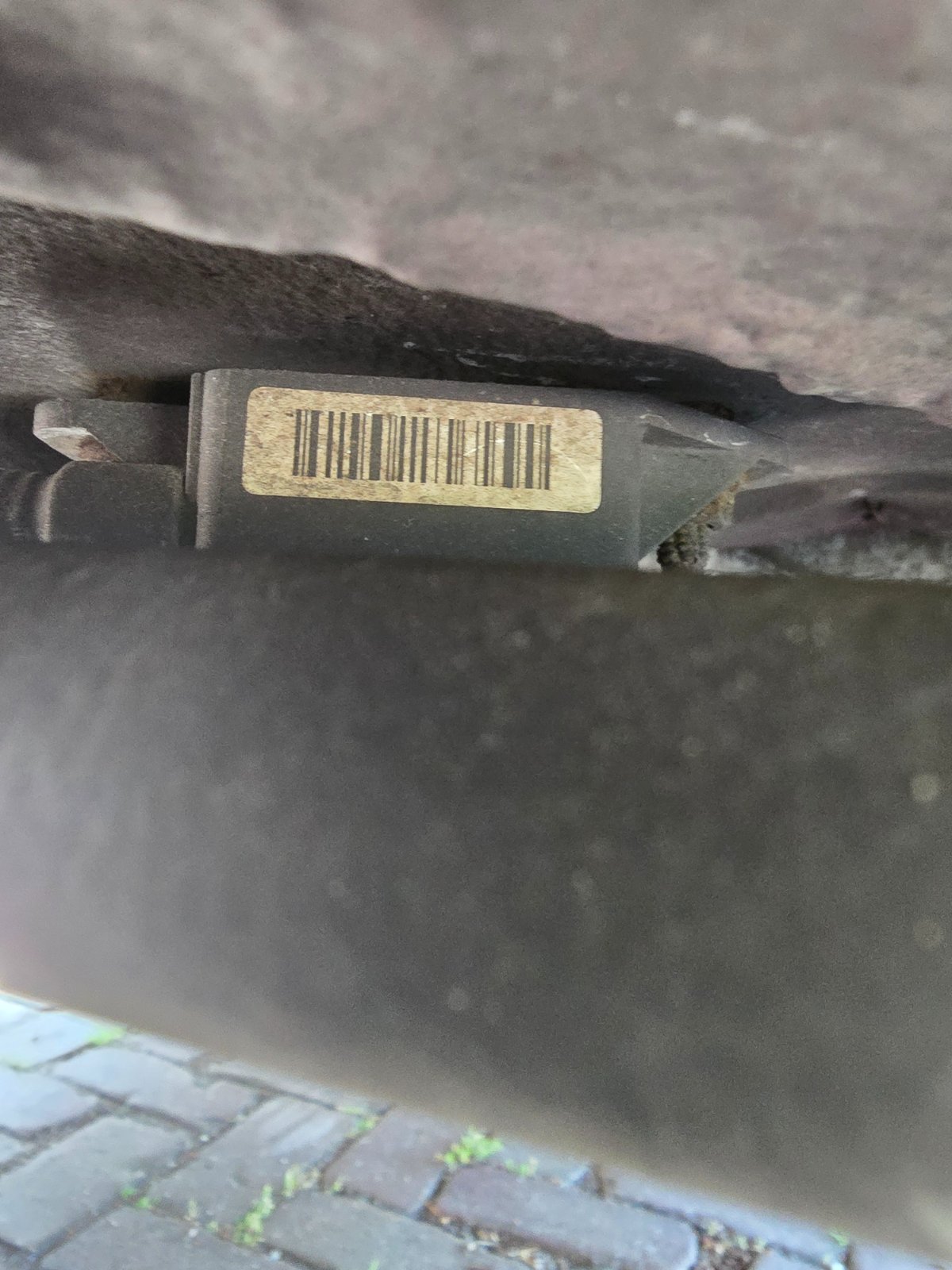

Re: Citroen c5 X7 Xenon headlight retrofit on steel sunspension
Dit you also mount the body height sensor at the rear of the car?
This one is used for correction of the carrosserie position.
You only mentioned the height sensors at the axels.

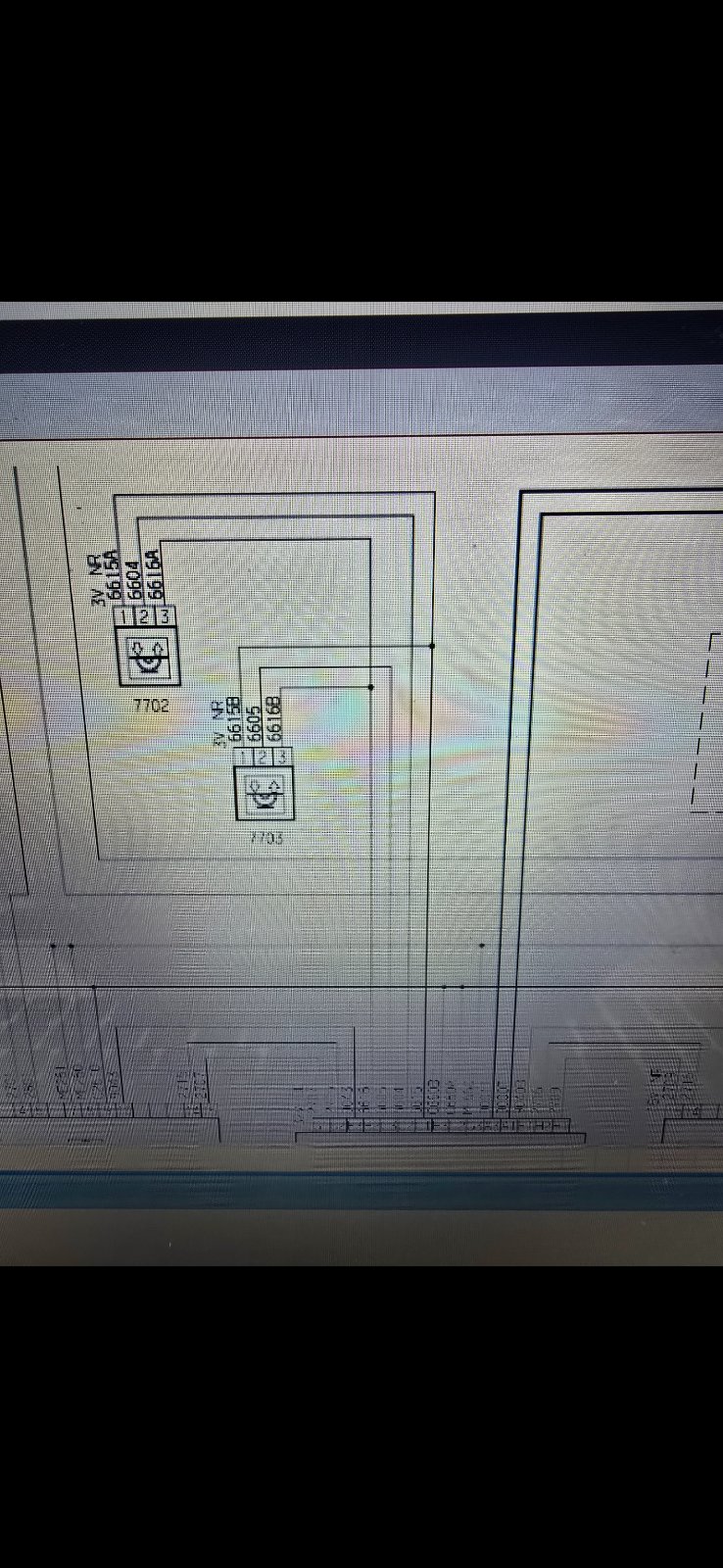

I installed these two. By the diagram that I got, there are only two sensors: front and rear on a non-hydroactive suspension. On hydroactive, the headlights ECU takes information by CAN bus from the hydraulic ECU.

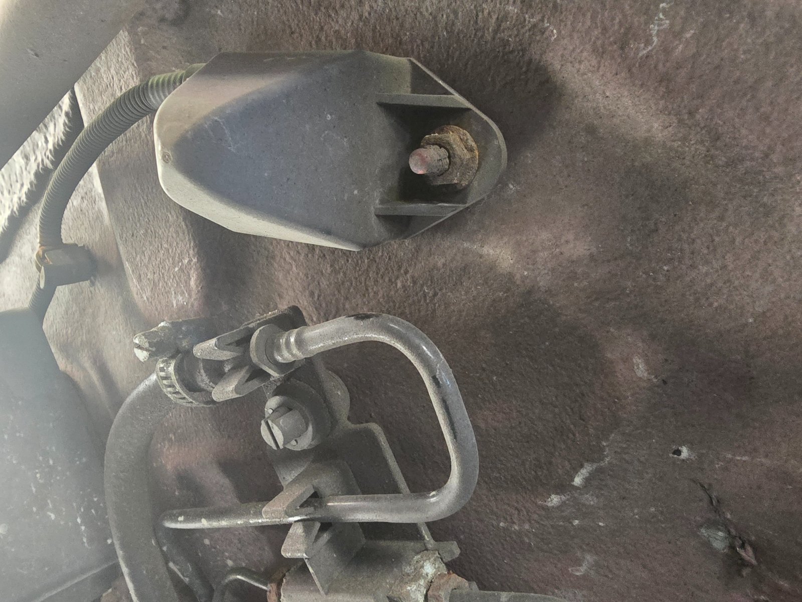

This is what I mean, I think you call it, proximity sensor.
Dzony97
- Posts: 23
Hmm i didn't fit that one,but its not even visible on a diagram, i will post a diagram later, maybe im missing something, or maybe that one is only available on hydroactive suspension .
I try to find it on the service box, but couldn't find it.
I believe this triangular thing is antenna for TPMS
Yes, you're right, sorry, my mistake .

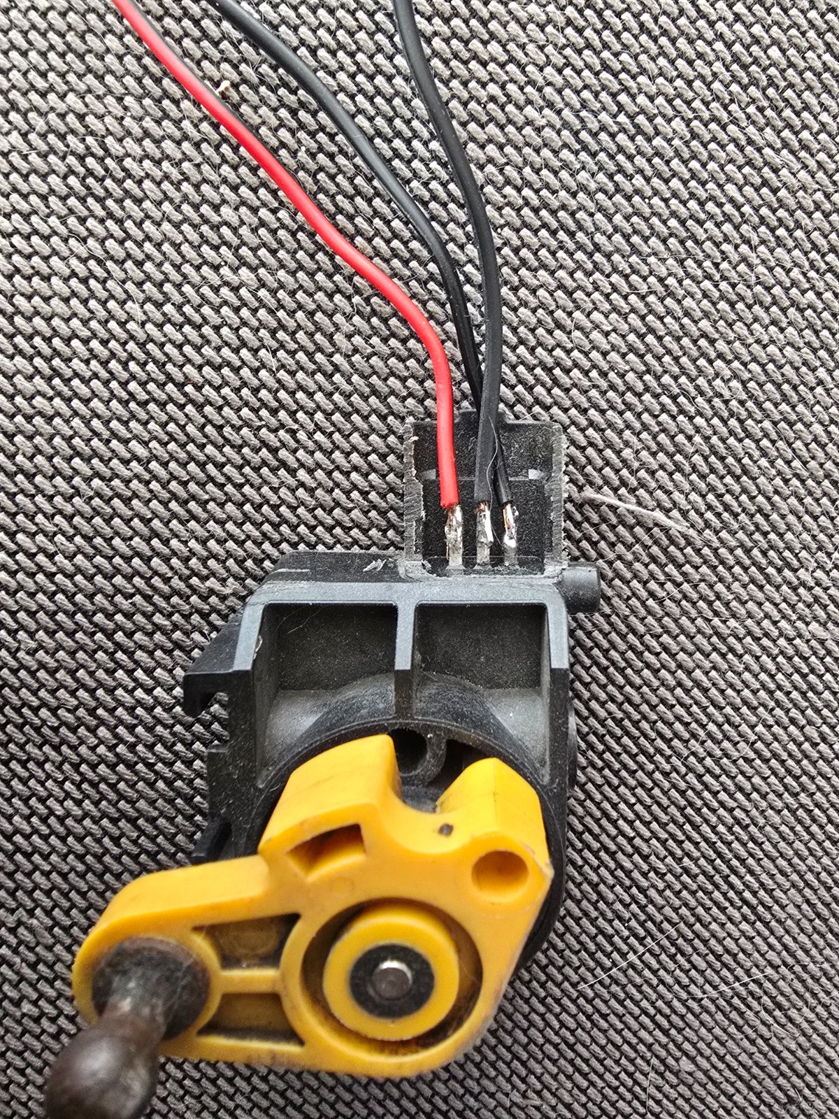

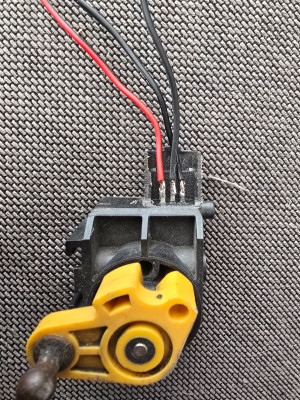

Is the Headlight Adjustment ECU different by part number for hydro and steel suspension?
But it makes no sense because it can be recoded with diagbox to a steel suspension, and after recoding, I'm getting faults for Vehicle height and sensor signals.
To me, it seems that the ECU is not even reading sensor signals. All thought height sensors are working (tested them on the bench)
On the other side, ECU is sending 5V on the sensor signal wire (pin 2 on the sensor and pin C2 and C3 on the ECU side), and 1, which should be 5V, I'm reading only from 1.2 to 4.5V with the sensor not even being connected. The whole thing is driving me crazy, since that is the only thing that should be done for it to work properly. Bi xenon headlights are like the best thing, way much better than the halogen ones that I had on the car before. Since they went down all the way when I plugged in the ECU, I went to a local mot and lifted them on the screw adjusters. Just for a few days till I find a way to make it work.
The 5V on the sensor shoud be on pin # 1, signal #2 and ground #3.
If you look at the sensor with the arm towards you, pin #1 is on the left side. Red wire => 5 Volt
Based on the provided diagrams, the signal wire is receiving a 5V potential. To further diagnose the issue, I propose supplying the sensor with 5V from a dedicated power supply and subsequently verifying the readings via Diagbox. Multiple inspections of the diagrams and wiring have been conducted to rule out any potential misconnections, yet the signal wire continues to exhibit a 5V reading even without the sensor being plugged in.
Did you check the voltage between B2 and C1 if there are the 5 Volt, and also witch is the minus.
If C2 and C3 also measure 5 Volt, it's possible, that there's a pull-up resitor inside.
Sometimes the wire diagram is different.

I will check tonight when i come home from work.Kees wrote: 04 Jul 2025, 10:47 Did you check the voltage between B2 and C1 if there are the 5 Volt, and also witch is the minus.
