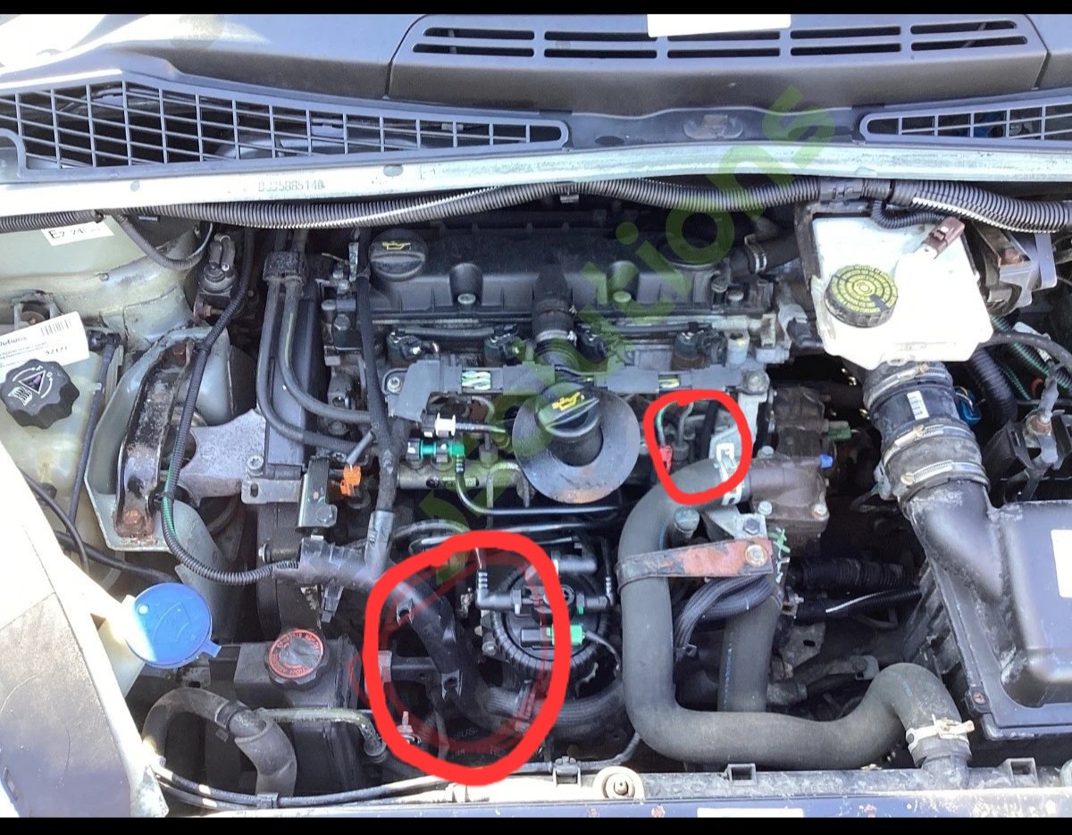

Re: ran fine then no start xpic
Some of these engines had a primer where my large red circle is drawn on the picture, if this engine is air locked then he will have to bleed each fuel rail union small read circle by cracking undon each nut and getting someone to turn the engine over by key till diesel runs free then tighten the nut back up , each one in turn . Rags will be needed as this can be a messy job
Husky.
PaulC5
- Posts: 2734
- Joined: 06 Jun 2023, 15:26
- x 712
If doing this on high pressure diesel you have to be careful not to get any injected through the skin.
