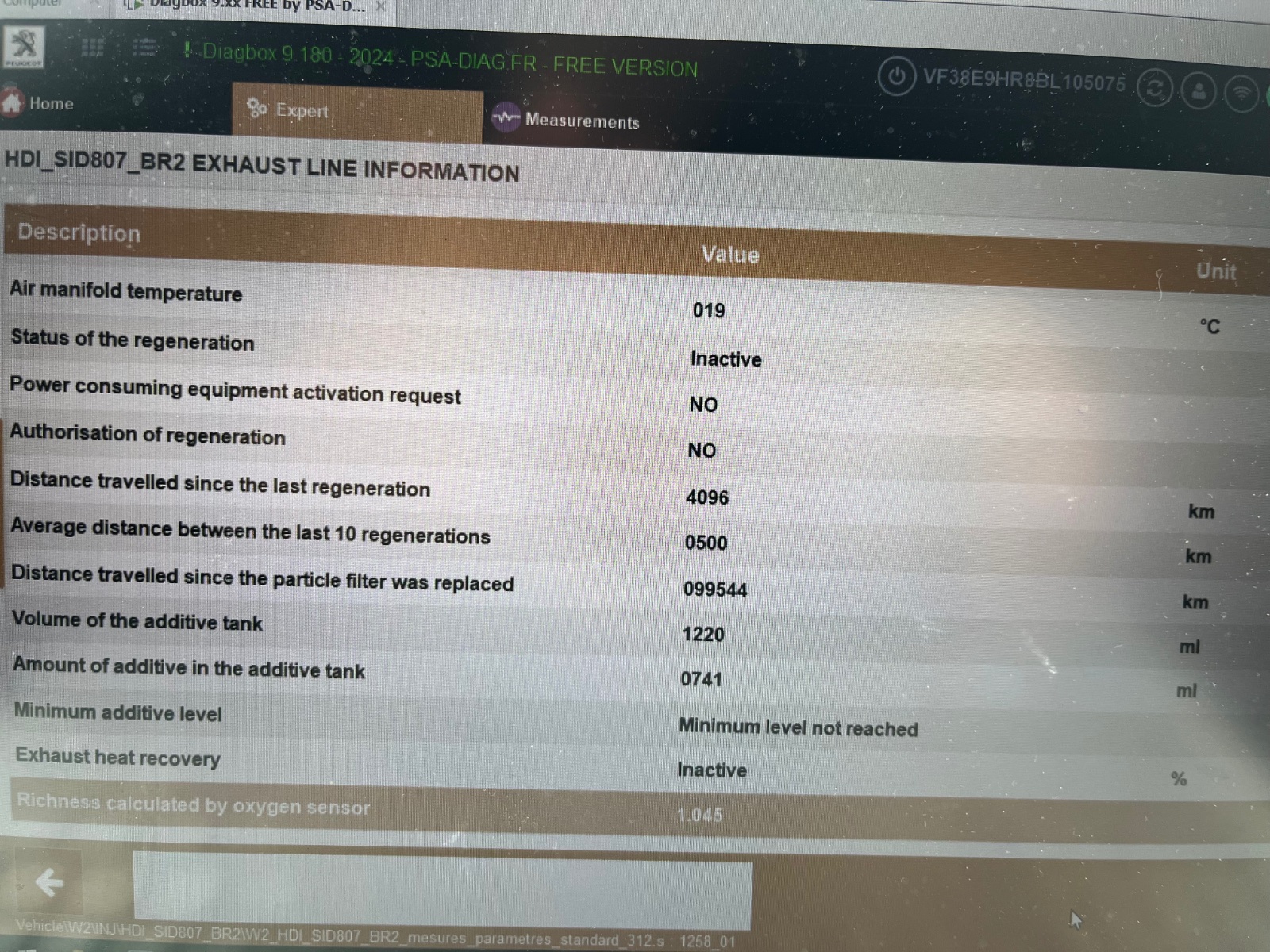

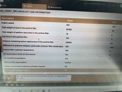

Ok seems like i got my diagbox back up and running … the error still comes every now and then, sometimes after driving 300kms, sometimes after driving 2 kilometers (right after it had shiwn up again) and only on highway speeds..
Started suspecting dpf regen problem so i check when was the last time it was regeneated and that seems very puzzling - 4000kms …
My prrvious 1.6 hdi was doing regens every 1000-1500kms ..
I am suspecting the car is trying to start the regeneration while i am doing highers engine speeds and loads on the highway, but cant and goes straight in to limp mode …

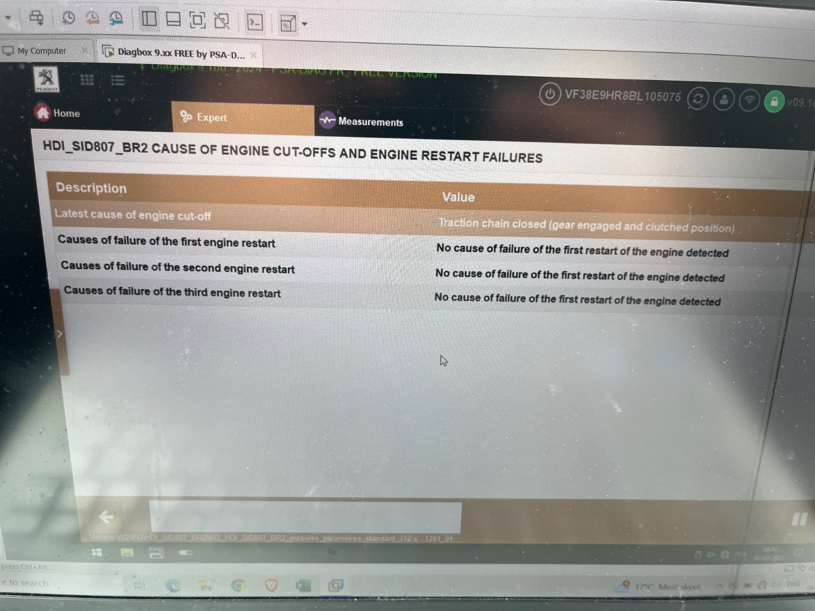

While i was looking around the menus i also found latest engine cutoff reason .. which is also strange as hell …

Anyone having an idea if the 4000 kms since last regen is strange?
Should i suspect some differential pressure sensor fail.. or the hoses getting to it also…?

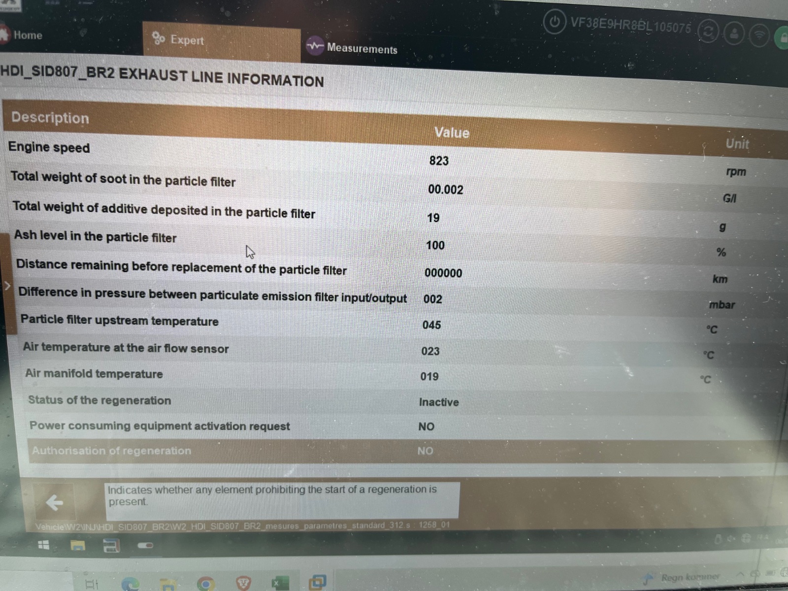

4k km seem too much for regeneration. I noticed that the ash level in fig. 3 is 100%. In any case you have to check all the values of dpf like deferential pressure e.t.c. Check this video.

Yea that seems also a bit weird because ash level is showing 100%, meanwhile differential pressure is like 2 mbar ..
I guess i will try to reset the dpf interval and force a regeneration ….

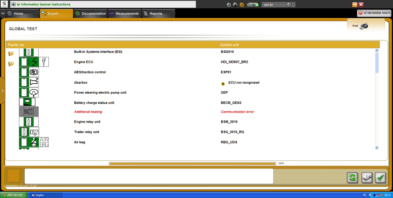

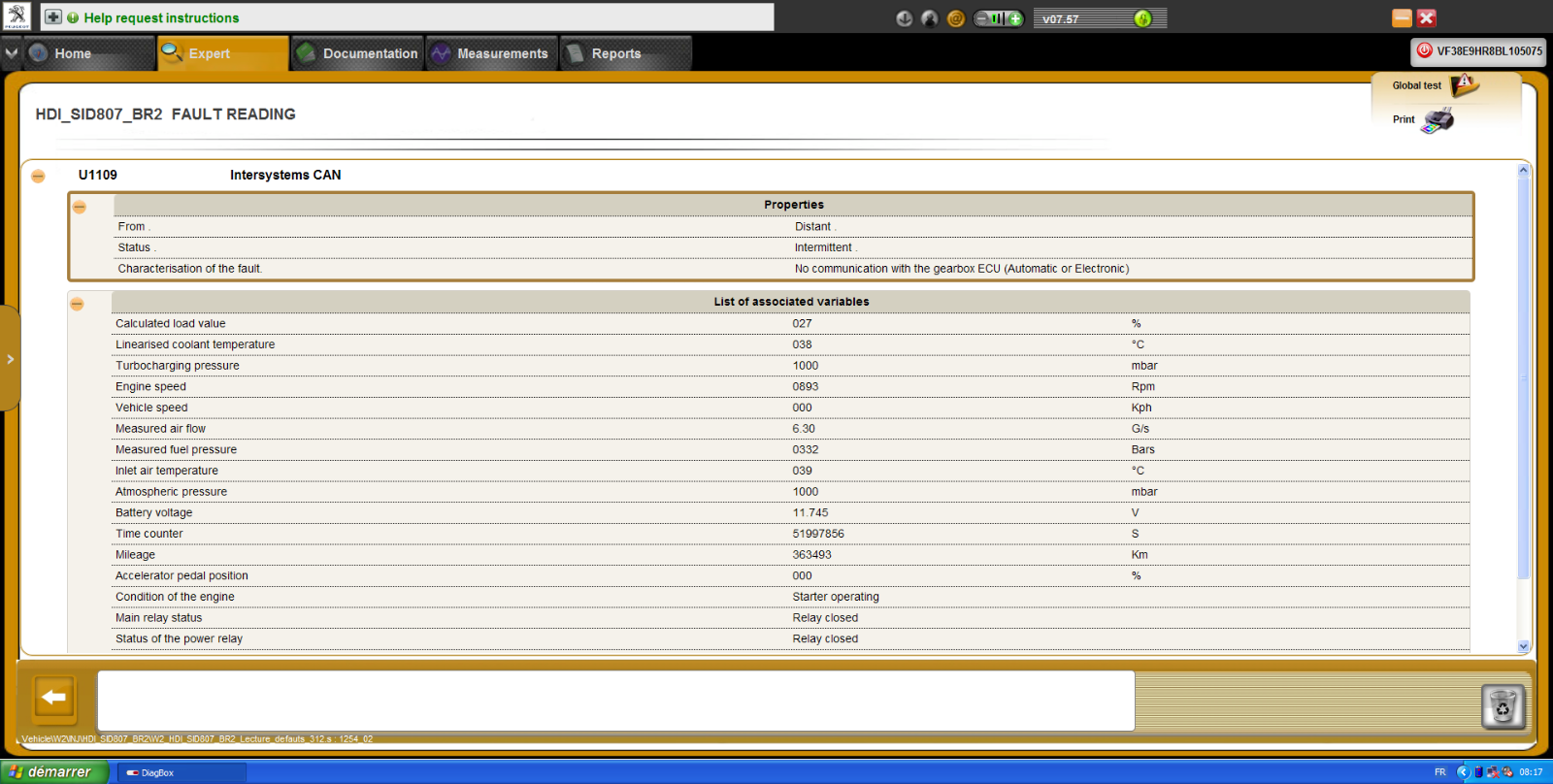

Problem is still not fixed and i have not worked a lot on it. But today i decided to check with an old diagbox (7.57)
To start with - the gearbox ecu is not recognized:
Turns out one of the errors on the BSI is showing gearbox communications issues. Error code U1109

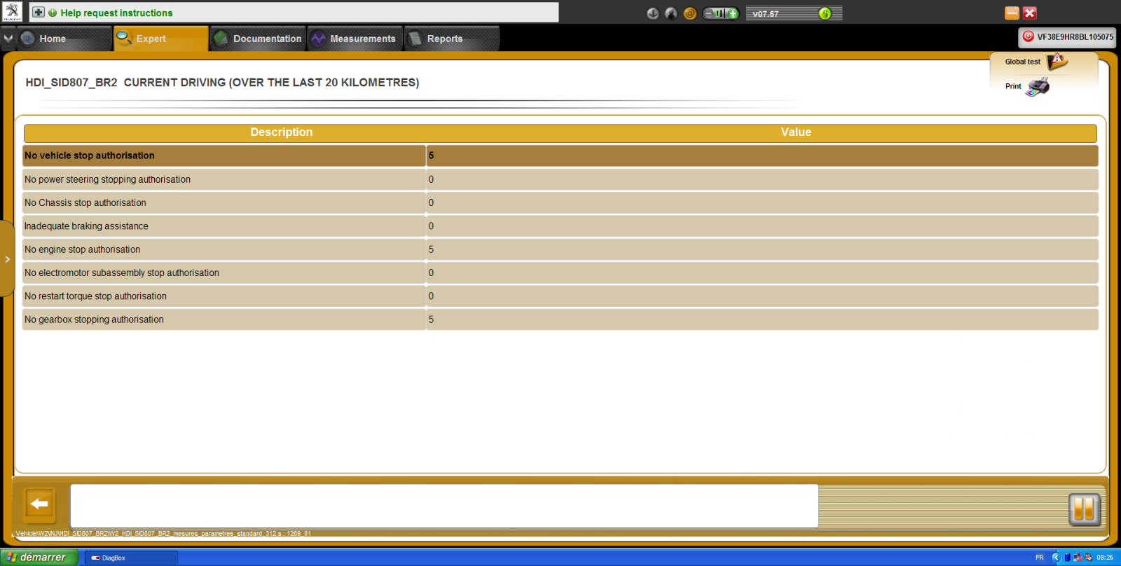

Seems like this error is bound to disable the start-stop as well ... and it was confirmed by checking the last few reasons start-stop was not triggered:
My next step will be to try and get a wiring diagram to check the fuses and maybe track a few wires that may have gone bad ... but if anyone has an idea what else i can get into looking - you are more than welcome to shoot here
Does anyone have a wiring diagram available??
