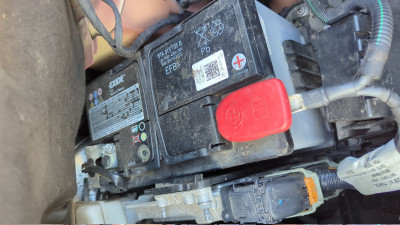

It's certainly possible that a new battery could cure at least some of the problems. If you post a photo or two of the battery (assuming you can see enough of it!) someone might be able to identify it as the original battery or a replacement battery that's incorrect.

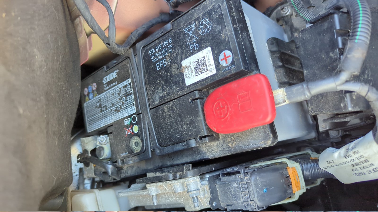

Here's a picture of the battery as requested.

Being an Exide battery I suspect it is not the original one. It may be the same spec but I do not know what the original one would have been.

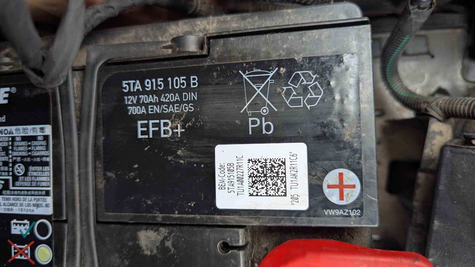

I would have thought it should be an AGM battery for S&S vehicles. If so it's slightly under spec. Correct is 70Ah 760A, the Exide is 70Ah 700A. It could be quite old as well, I couldn't see a date but visually it looks old.
Is there a battery specialist near to you that could do a proper test? Not just a simple voltage check. I believe that Halfords offer a free test.

There's nothing obvious there to indicate the date, sorry.
