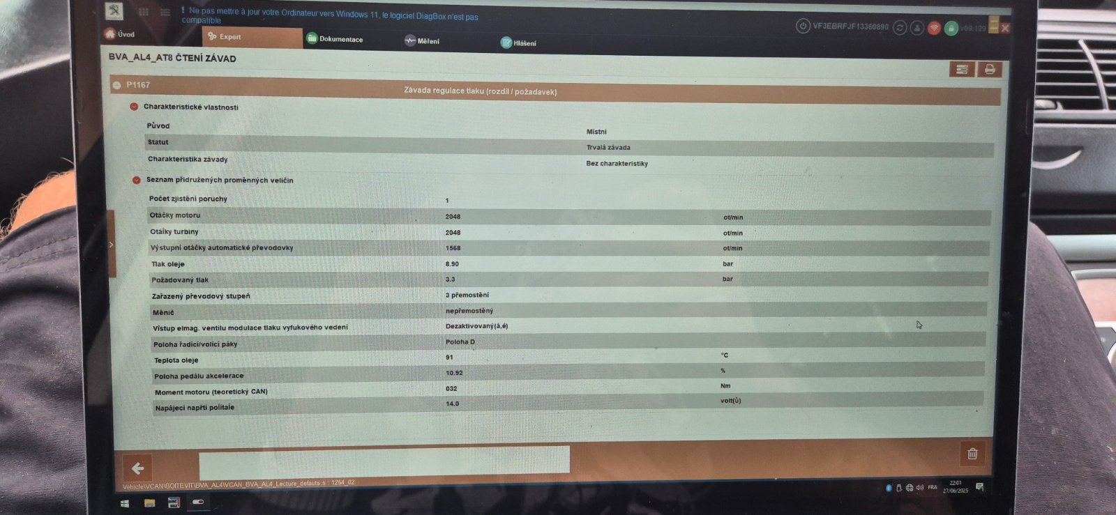

Hello. I own multiple cars with this gearbox which I am maintaining but this one gives me a headache. At 300000k km i replaced both main valves (still old style cause near me is no Peugeot dealer to update sw in gearbox ecu) because pressure regulation fault and gearbox was in limp mode, replaced oil, replaced oil pressure sensor (was showing 12 bar permanently). After replacement, pressure was OK (max 0.2bar difference between real and called pressure) My wife drove the car for 10k km for past 3 months and today I got again p1167 fault. I checked oil level-OK, i checked pressure using diagbox - if car calls for example 3 bar, real time pressure is jumping from 2.5-3.3 bar. Which is propably the cause. Is there any way to check where the fault could be? Is there a way to check valves(bought esen SKV) if they bx any chance failed? Or is there something I should check? Thanks for any help.

Re: Peugeot 807 al4 pressure regulation fault
Unfortunately your diagnostic kit is not displaying English so not much help to us. If you can get it in English then post it up again and maybe someone will spot the problem
