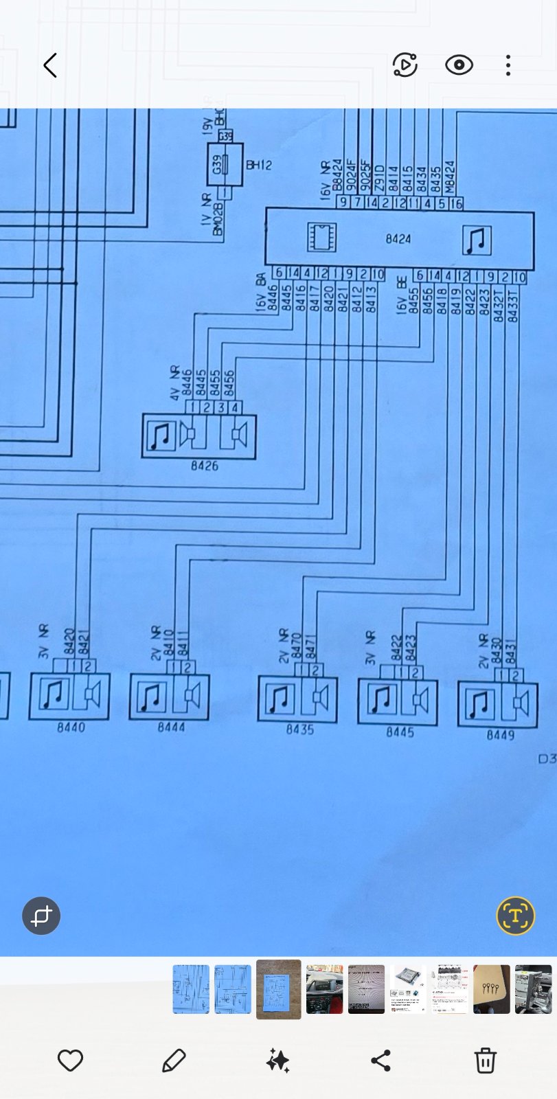

So gents.
I would like to add a subwoofer to my 508 GT Line Hybrid (station wagon)
I kinda hope the wiring (audio) is present somewhere to the right in the trunk (is it called trunk in a station wagon?), since the models equipped with Focal soundsystem, has the subwoofer placed there, and i suspect wiring is the same for all models?
Can anyone shed a light on this? A wiring diagram, perhaps?
Thanks in advance!

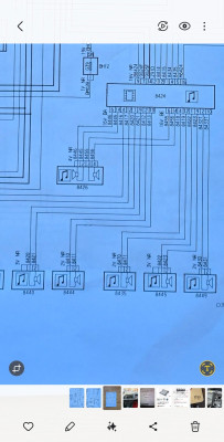

Maybe you can use this one, it's from Citroën, but you can see, the connections between the amplifier and the subwoofer. No 8426
