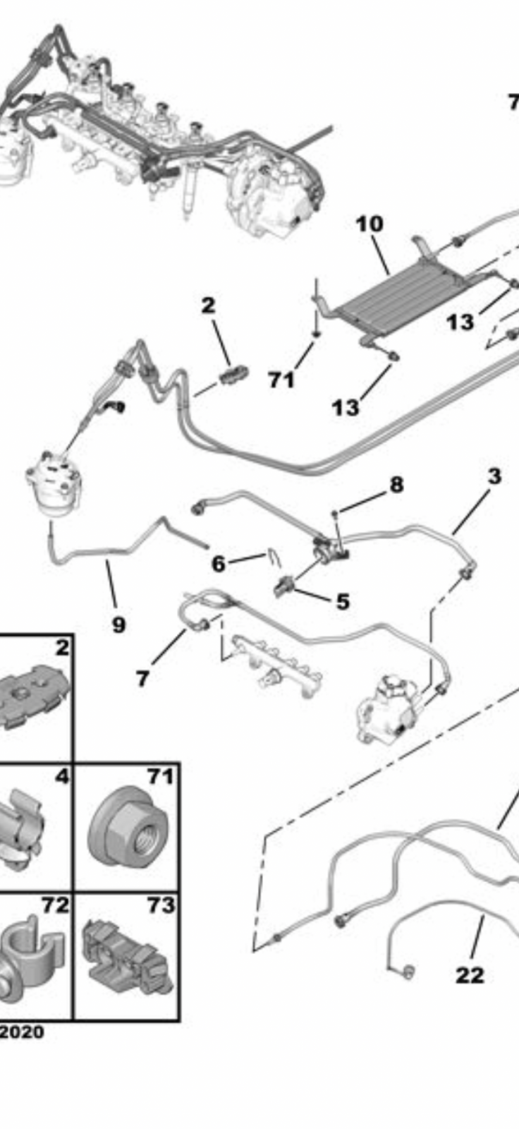

All sorted I think. Got some diesel in a fuel can and filled it up. Started almost straight away. But then I could smell diesel really strong. Found it was leaking from the fuel temp sensor located at the front top of the engine. There’s a metal clip that holds the fuel temp sensor in place and for some reason it’s snapped. Ordered a new clip from Citroen £12. Hopefully that’s the only issue.
Item no 6 in the picture Cheers
