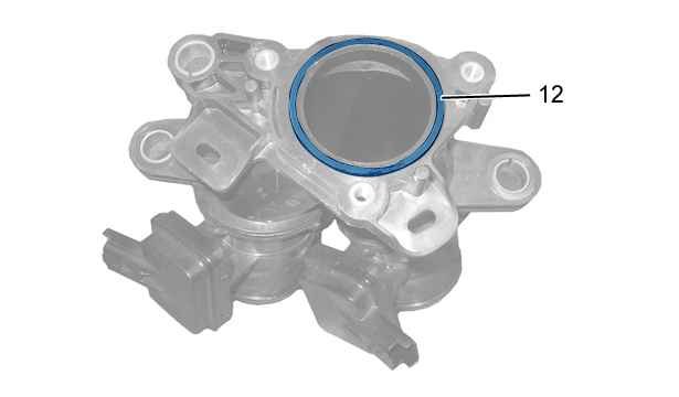

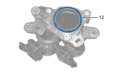

I would kindly like your help identifying this gasket from a Citroën c5 2010 2.0 hdi 163hp rhh dw10cted4, located between the air distributor and the intake manifold.

Hello, if you only want to replace the gasket:
1.Check the dimensions – the diameter and shape must match the original throttle body.
2.Order it separately, for example from an auto repair shop or a spare parts store, specifying the exact throttle body model — e.g., "gasket for throttle body 0345G7".
3.Installation– when replacing the throttle body, fit the new gasket, clean the surfaces, and tighten the unit to the intake manifold diagonally and with the correct torque.
