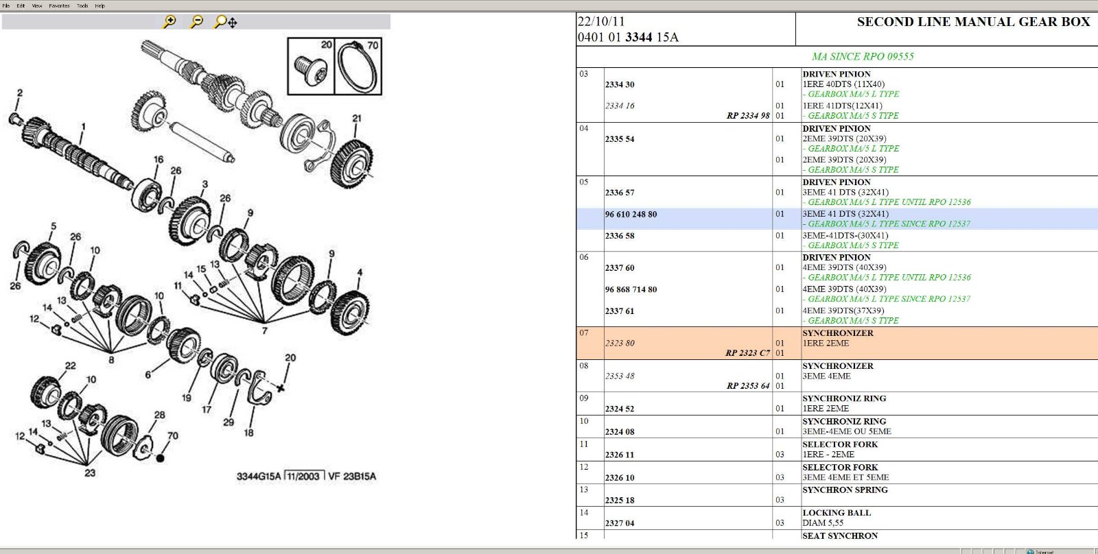

It has gotten pretty hard to downshift into 2nd, and even more so into 1st.
I guess I'll need the whole synchro-mesch assy for 1/2, or at least the synch.rings/clutches and the two gears with rounded teeth, and the ring/sleeve, and possibly the hub.
Looking at the EPC I cant find the clutches/brakes, usually the synch.rings have an inner cone which mates with an outer cone on the gear.
But looking at the EPC drawings and google-pix of the parts I cant see any cones, the gears are 'flat' and the synch.rings have inner splines/teeth. Same for 3/4.
Looking at the EPC it looks like I'd need parts 3+4+7 to fix the problem. Is this correct ? But there are no clutches/brakes ??
See EPC pic for ref.

Note to myself, and others who may be interested:
The YT video below clearly show that the gear wheels actually has the outer clutch cone that I mentioned.
Usually in other gearboxes these are finely ground to a near mirror finish, but on these wheels they're black and pretty rough...
I now also know that my gearbox is not any of the BE3/4/5 versions, but a MA5 type, and also
the latest version of the MA5 (on which they have removed the oil level inspection plug that were present on the earlier versions).
