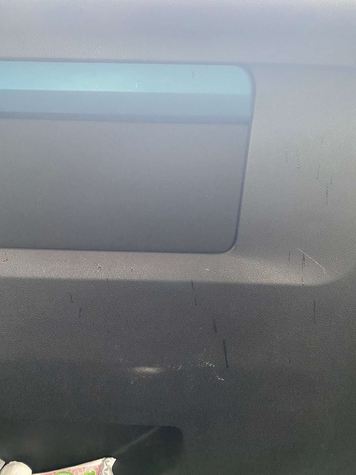

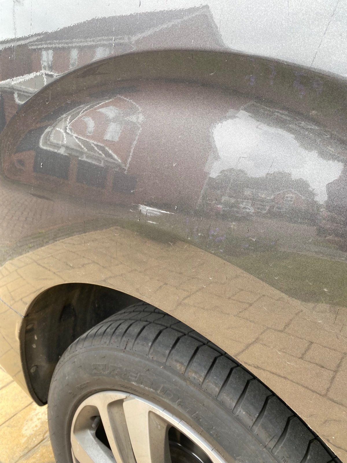

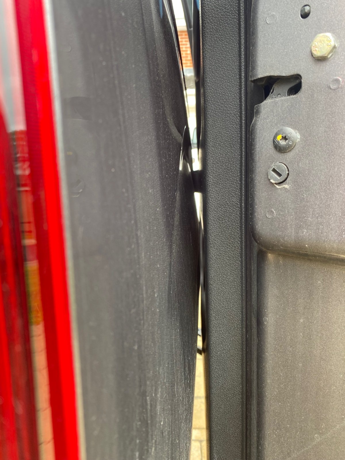

Hello Richard. Thank you very much for responding. I’ve tried to take three photos. One where it’s catching over the hubcap, one looking down the side down the gap between the Car body and the door, and one from the inside which shows marks from where it catches. I hope this helps. Thank you.

If it's only the plastic it may have been off and not put back right. Does it have a sliding door on the other side? Is the distance from the actual metal of the door to the car the same on the other side?

Thank you, Richard. I never thought to check that! I’ve just had a look and it does seem that when the door is open, there is more of a gap between the door lining and the car body. I’ve looked at the lining on the problem side, and it does seem to be in place, okay and I can’t tell personally if it has been removed at any time.
Do you think a body engineer might be able to do a small adjustment on the door? Thank you again
