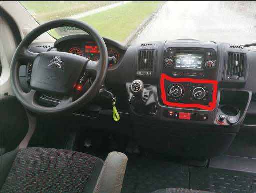

For my campervan based on Citroen Relay 2.0 Blue HDI 160HP from 2016, i noticed when i upgraded the old radio with a 2 DIN unit that the dials from the AC and ventilation controls are not illuminated at night (with parking lights or headlights on).
I have checked the fuses in the process of changing the radio and found one blown on the BSI, who was responsible for the ACC+ line (+12V with key ON) to the 2DIN unit and some other things probably not installed on my van. That also fixed illumination of the panel to the left side of the steering wheel (with Mode button), but not the AC dials.
I found under the radio a white connector with two circuits going to the left and to the right of the ventilation dial unit, which have 12V + on them when light is on, I guess that there are two mignon light bulbs thar are both dead under the panel.
Question:
Does anyone know how to take off the panel in question, 'cause I didn't find the screws (and i tried to pry it off thinking there are some clamps, with no success)?
I have SEDRE manual for schematics but it's hard to navigate and didn't find the removal and mounting procedure of that panel. Maybe someone knows better. Thanks!

If you work through this video I think you'll get an idea of how to access that panel, good luck :)
