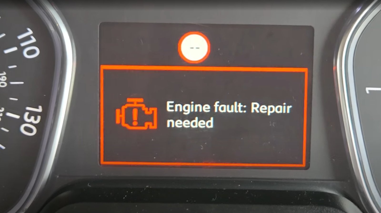

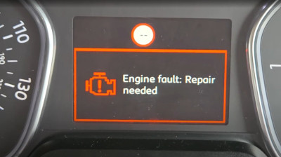

HELP! Today was a bad day. My Proace Verso 2019, 2.0d (rebadged version of the Peugeot Traveller and Citroen SpaceTourer), has been running great. When I parked up today, I got an Engine fault: repair needed error. It doesn’t start; the engine turns over but doesn’t fire up.
ECU, Electrical fault? Maybe water ingress into the ECU, Fusebox, etc I feel completely out of my depth and have no idea where to start.
It feels like the ECU has shut down with all the error codes all at once, maybe ECU has been wiped?

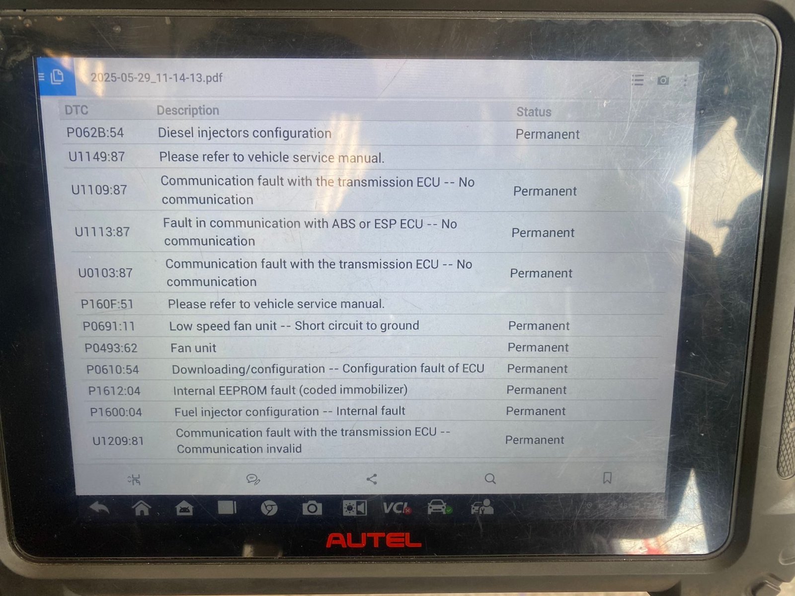

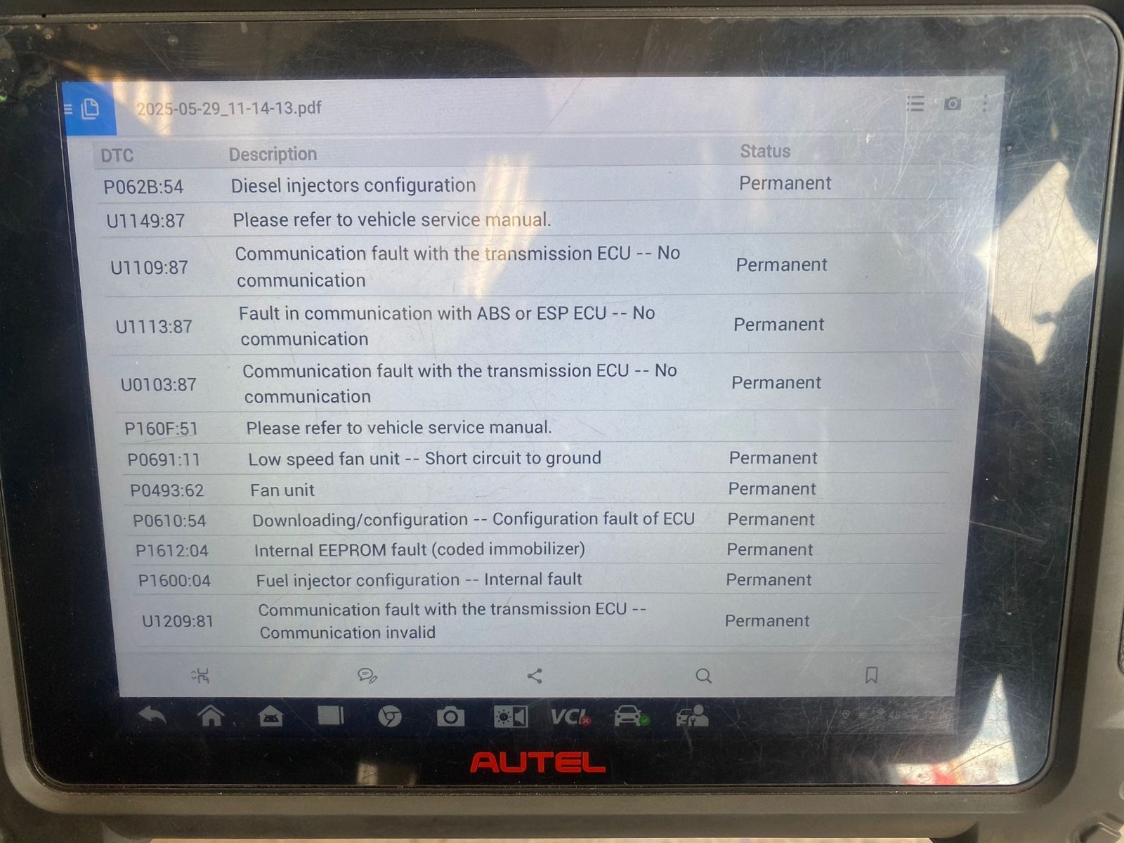

P062B:54: Diesel injectors configuration issue.
U1149:87 & P160F:51: Indicates a need to consult the vehicle service manual.
U1109:87, U0103:87 & U1209:81: Communication faults with the transmission ECU.
U1113:87: Communication fault with the ABS or ESP ECU.
P0691:11: Low-speed fan unit short circuit to ground.
P0493:62: Fan unit issue.
P0610:54: ECU configuration fault.
P1612:04: Internal EEPROM fault (coded immobilizer).
P1600:04: Fuel injector configuration internal fault.
U1209:81: Communication fault with the transmission ECU --Communication invalid
U1149:87: Please refer to vehicle service manual.
U1109:87: Communication fault with the transmission ECU -- No communication
U1113:87: Fault in communication with ABS or ESP ECU -- No communication
U0103:87: Communication fault with the transmission ECU -- No communication
P160F:51: Please refer to vehicle service manual.
P0691:11: Low speed fan unit -- Short circuit to ground
P0493:62: Fan unit
P0610:54: Downloading/configuration Configuration fault of ECU
P1600:04: Fuel injector configuration - Internal fault

Have you tried clearing it then see what comes back?
vmguru
Posts: 22
Joined: 13 Jun 2024, 11:45
Re: Peugeot SpaceTourer Citroen Traveller Proace Verso - ECU Errors Engine Fault
Unread post by vmguru »
wheeler wrote: 02 Jun 2025, 17:27 Have you tried clearing it then see what comes back?
Yes I have tried to clear them all of them are permanent

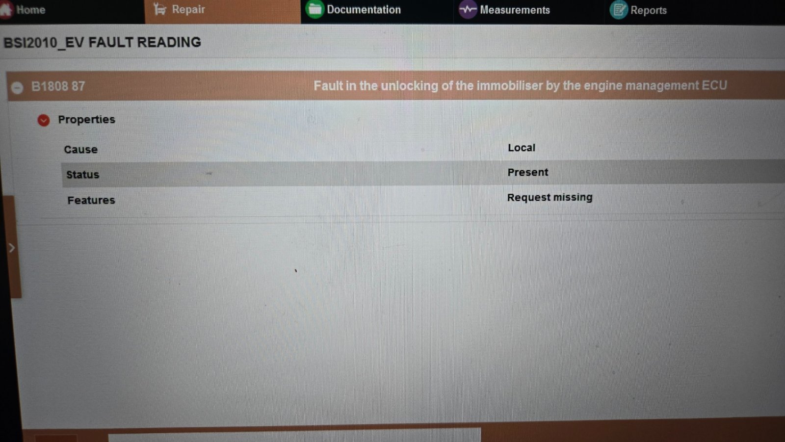

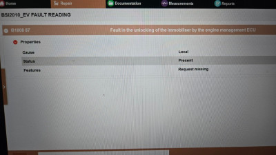

I am suspecting a faulty BSI (fusebox) has anyone else seen this B1808 87 Fault in the unlocking of the immobilliser by the engine management ECU ?
B1808 87
B1808 87
Posts: 10892
Joined: 09 Nov 2005, 22:03
x 1432
Unread post by xantia_v6 »
I would say that the range of fault codes is likely to indicate an internal fault in the ECU or maybe the loss of one of the power supplies.
I think that it would be wise to contact an ECU repair specialist.
