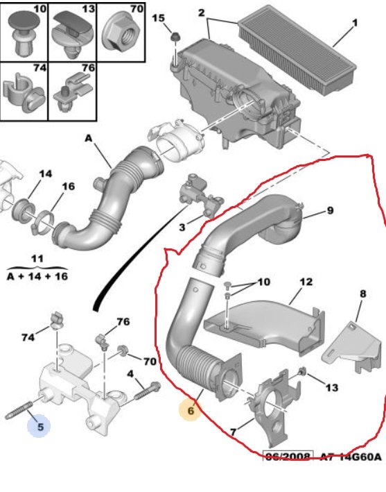

It can be done without removing the headlamp.
Remove all the air intake parts within the red line.
Then use a 10mm socket on a long extension down the side of the headlamp, right next to the wing to undo the single securing nut.
Reach under the headlamp from where the air intake was and grab the relay and pull it back so you can access it.
