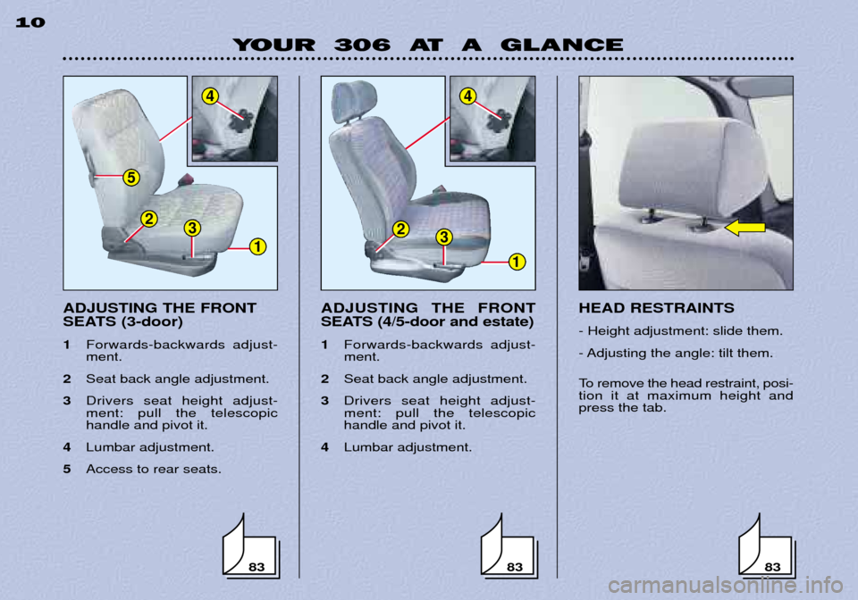

My Cabrio has this lever on the outboard side of the Driver's seat (Yes, she's a right-hand driver--shouldn't make a difference). The photo shows the lever in it's extended position, as it's spring-loaded--probably to ease access and egress to the seat. I pulled it up into this position, and of course it doesn't go back to the original position----let me rephrase: It doesn't move at all out of this position.
So: 1. What is the purpose/function of this lever?
2. How does one get it to move?

I think the lever is a seat height adjuster, the handle should pull out, then you can mov it up and down. They are known to lose the internal screws, usually they go floppy if this happens and the seat springs up when you get out, but not beyond possibility that it's jammed the adjuster.

Generic picture of 306 seat adjustments
