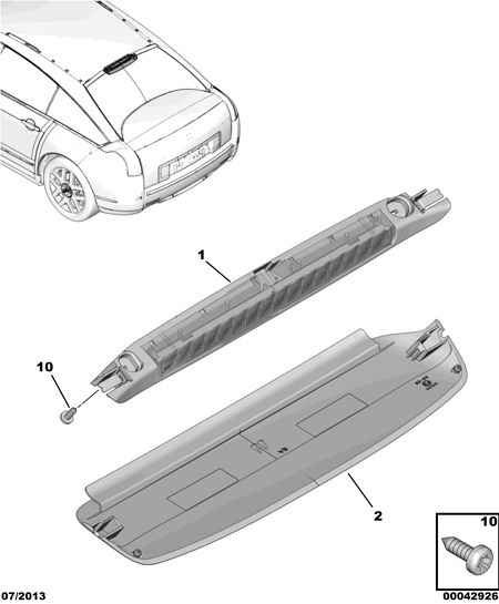

Hello, does anyone know how to gain access to the high center brake light? It has ceased functioning (the other two ok). I'll check fuses first, but may need to gain access....

1. removal
Remove the inner cover.
Disconnect the plug in the centre.
Dismantling :
- The screws on the left and right
- The 3rd brake light
2. Installation
Installation :
- The screws
Reconnect the plug at .
Replace the cover.
