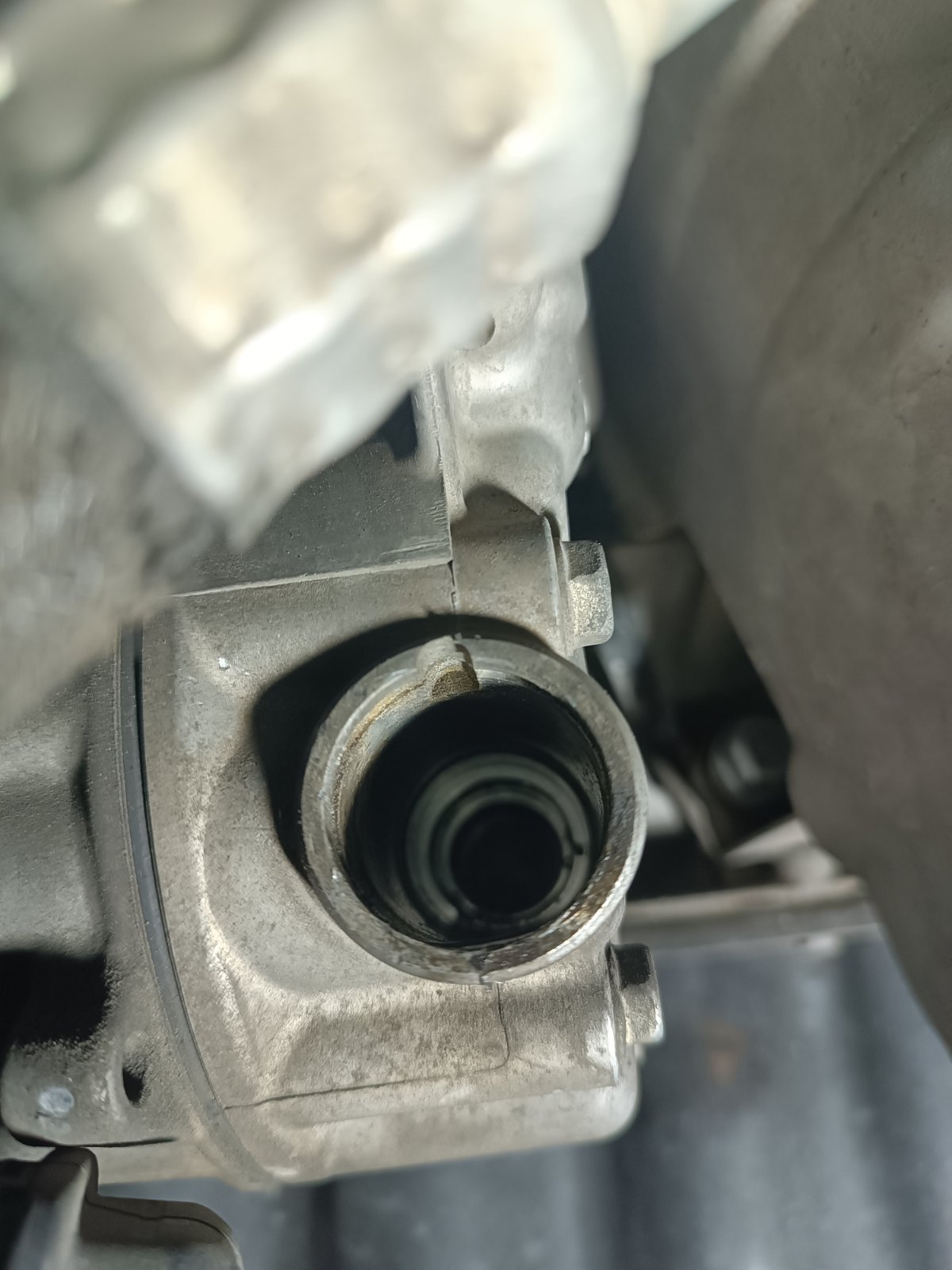

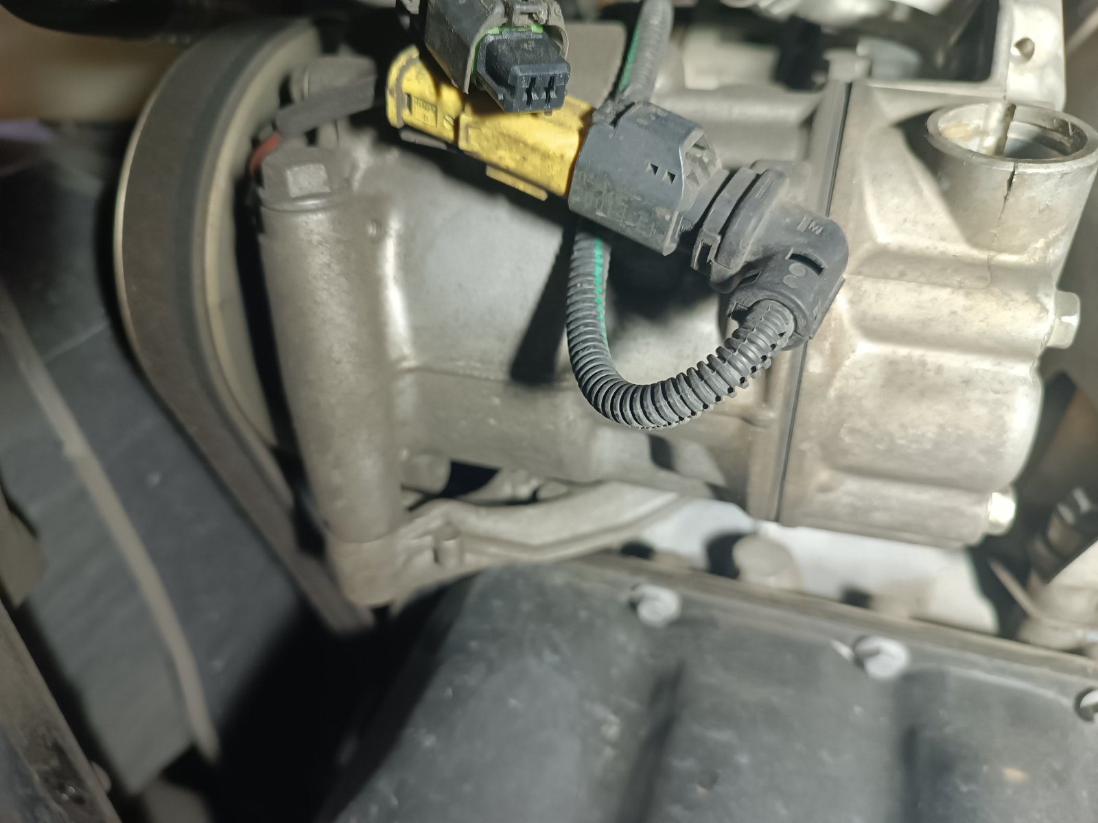

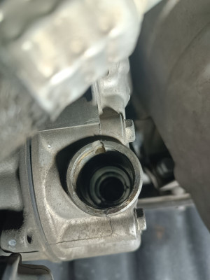

Hi! I hope you can help me. I bought a Peugeot 2008 year 2015, and I need to change the AC Compressor, but I do not have any manual that could provide the part number and with the vin number I can't find the part number. Do you have any idea how can I get the info without having to disassemble?

Peugeot doesn't usually specify the manufacturers part number, they have their own part numbering system.
Besides, you need to be a payed up member to get part info on this site.
The compressor will have a placard on it with the manufacturers part number.
The compressor is most likely a Sanden brand. This brand is very popular and used across a lot of car manufacturers.
A quick search shows it might be a Sanden SD6C12.
The part that's missing is the displacement control valve.

Thank you. I had that model number as well, but better double check with the experts. Thank you for your advice
