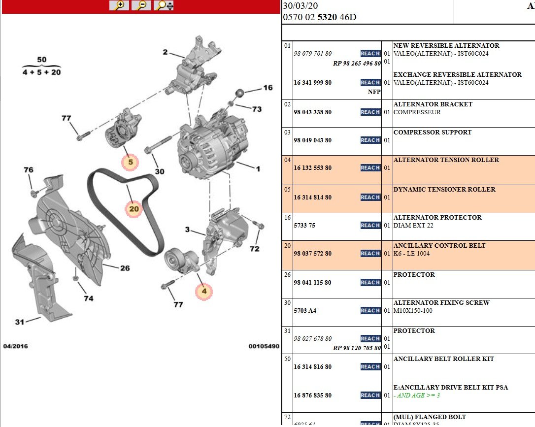

Can someone help me to understand the correct part numbers for the drive belt and tensioners for my car please. Its a 2015 C4GP 1.6 BlueHdi 120.
Vin number is VF7**************[VIN obfuscated, can be read by forum staff]
Thanks in advance

Here you go.
