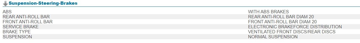

I would be surprised if a 2000 model Xsara has ESP. What is your VIN?
Any fault codes in the ABS system? Are the brake lights working correctly?

The VIN code is probably V F 7 N 2NFUB73055670

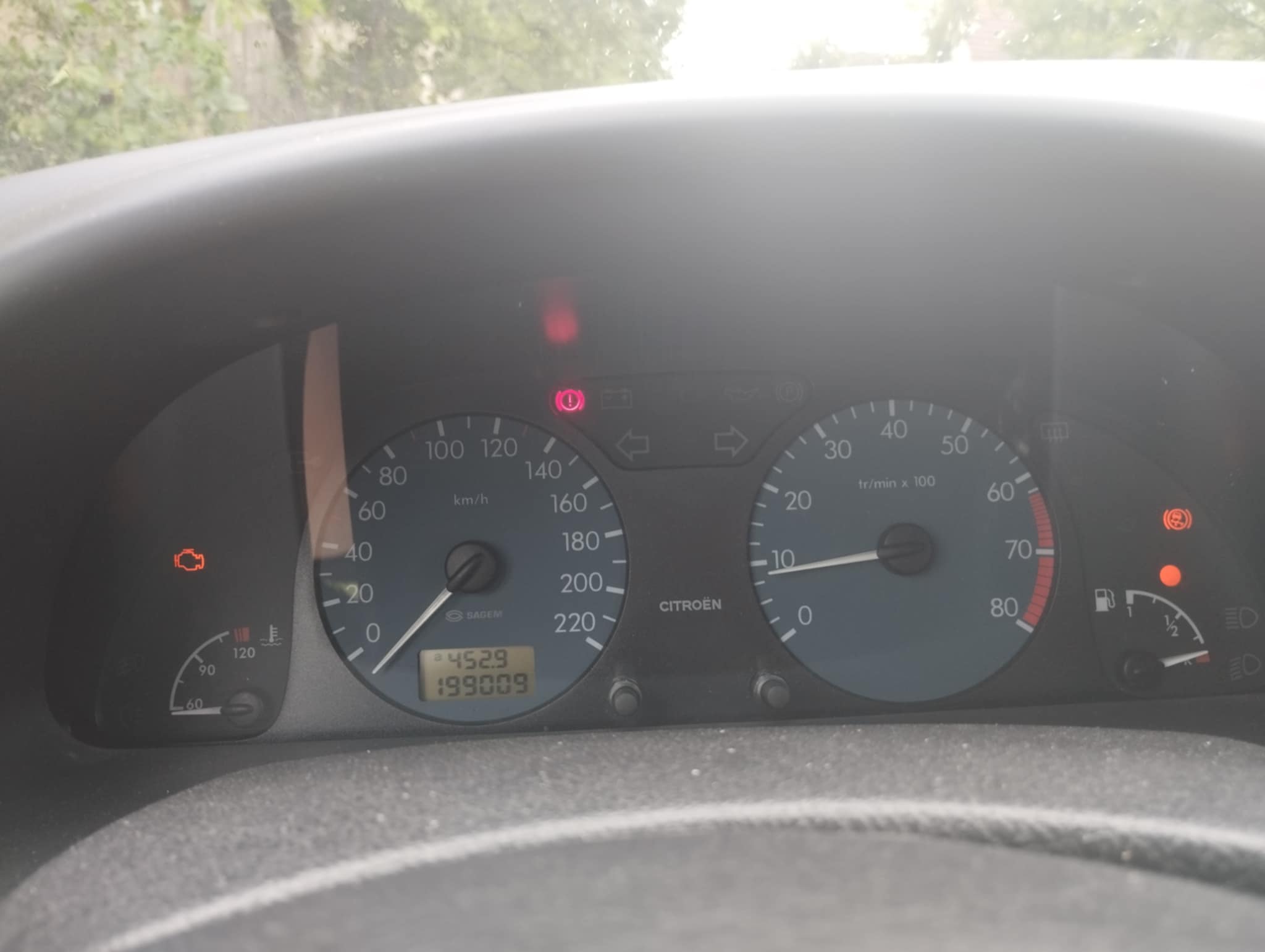

I’ve attached a photo as well.
https://www.upload.ee/image/18116891/ec ... 6fc65.jfif

Re: Citroën Xsara Break (n2) ESP Problem
I can’t see an ESP light, only ABS.
Really needs a diag check on the ABS system to at least get a hint in the right direction.
